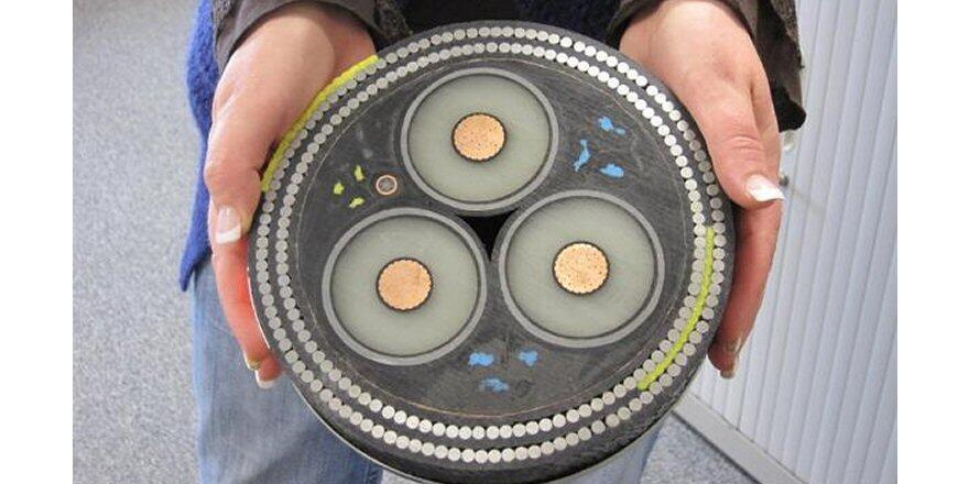

Maybe that's what he wanted.Note however that ‘cable’ threads have a reputation for spiralling into closure…
2. Or you can say cables are basically an LCR network. Inductors and capacitors are not linear if driven hard enough. The dielectric materials are not linear in the strictest sense. Again if driven hard enough, they can be non-linear. And if cables are non-linear then they can produce distortion like non-linear devices such as transistors.
Mmmmmmmmmmmyes...
But if you've managed to get the cable overheated you're doing it wrong 😉 😀
Correct cable thickness is important to reduce potential losses and to maintain specific safety guidelines.
Things happen.
I managed to evaporate (and all the insulation went *poof*) part of a 1m long 2,5mm thick solid core well insulated copper inductor on a battery bank once (it was stubborn enough to move to the wrong place as I was fidgeting with my tools), managed to save the batteries.
A former colleague managed to melt a wrench, also on a battery bank, battery did not survive.

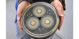

If you spend enough, you can get a perfect cable.
