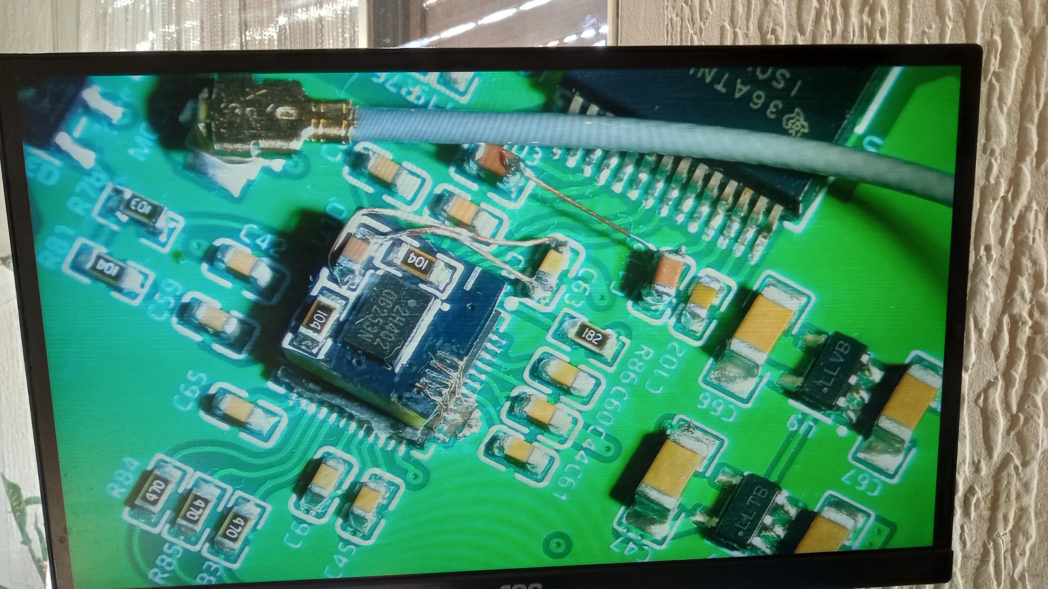

Found fw for CT7601PR! For those who is looking for it search for SXW-MDL7601-INTCLK_A2 20210530 , that fw is for MDL7601 pcb board which you can get on Ali too. Shame that CT didn't respond to mail, I have contacted him and getting no reply, even I bought things from him directly. Doccuments is unclear about fw, does ct7601 realy reguire spi flash or not thats not a clear. I was wrong in designing main pcb with ct7601 and without spi flash, can't get it to work and to make it visible on usb, now I made an smal pcb on which I put spi flash ic, will put pcb on top of ct, hope I get ct working. If it start to work I will experiment with registers, will try to dump all registers and try to get ct working without spi flash.
Take a look on this forum http://bbs.hifidiy.net/thread-1501880-1-1.html you can find fw for PR ic -> SXW-MDL7601-INTCLK_A2 20210530 , the rest of things you should fine control trought i2c or even trought usb. This CT usb is an nice device I can tell, and can be used as a master mcu if you are lucky to get source code. : ) I used two gpio ports from PR for on-off isousb and another for bluetooth on-off : )
Yes, pid 6000 is when fw is missing, in that case your device mannager will see your ct as a flash device. I forgot to put spi flash thinking that it not needed, and result was CT is not working since fw is miissing, and final result was my hard time to put spi flash at top of my CT, those 6xmm pcb with ultra small legs was nightmare interconnecting it to ct pins using not an adequate soldering iron, it was 1mm jbc and I urgently need to buy an mini jbc with soldering irron 0.2mm for something similar to this in future work : )
Super glue was faster than me : ) so when I put pcb at top of CT it fixated momentaly but crookedly omg : ) and wires was needed also crookedly which made work even harder : ) Nevermind, those pid 6000... CT is not that easy to kill by fw, just reupload fw and it will work! If it somehow can't get into download mode you should do the things trought i2c, reset internal mcu and the rest of things. I didn't tried but in theory its not possible to kill CT by an wrong fw.

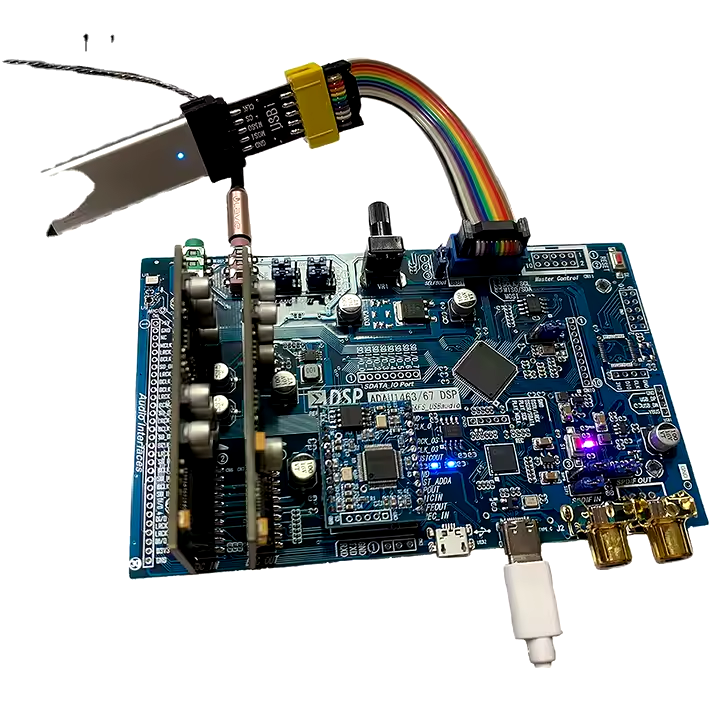

There is better solution that can do input+output and replace USBi at the same time 🙂@savan I am researching this adau1463 circuit. it has a usb transpoter using ct7601sr with both input and output, I want to play around a bit to redraw it later and try the firmware version above, it only has output mode 🤣
