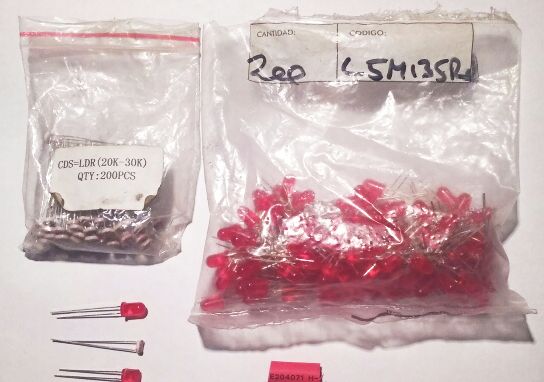

A Milion Dollars worth of Optocouplers (ok, 200 of them 😉 ) for about $40-50 in parts, what´s not to like?
As said before, I use LOTS of them:

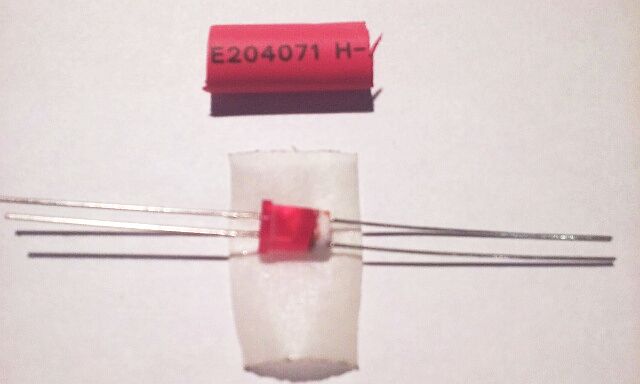

I grind LED lens/dome flat.
Not strictly necessary but it improves mounting and makes Opto slightly shorter.

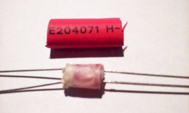

I align them on a small piece of tape, then add a drop of cyanoacrilate glue between them, or clear/translucid Epoxy.
Then fully wrap them in tape, push tape ends inwards with my nail.
Then heat shrink it.

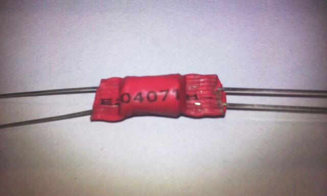

While shrink is still hot and soft I press it flat with long nose pliers.
You can trim excess later.
I used red shrink because I had it on hand, fine unless LDR sits in direct sunlight or under a strong lamp (not a problem inside a chassis) but for peace of mind or OCD use black shrink.

Trim excess shrink tubing and if needed, bend leads.
Leave LED ones straight , LDR ones are way more flexible.
Specs roughly match your first datsheet, these work anywhere an original VTL does.
