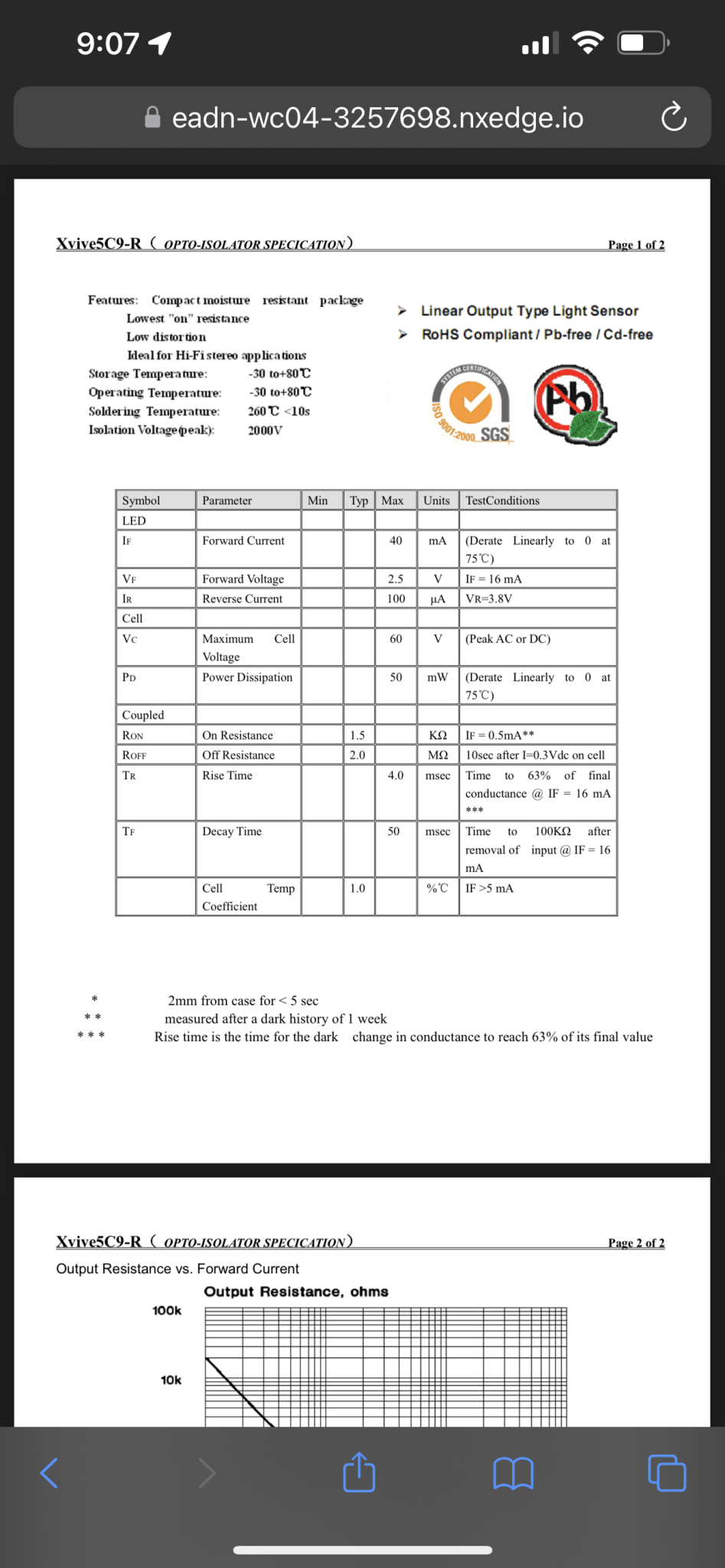

That 10k spec is nonsense, or better said, must be the LDR resistance when passing "X" milliamperes (or microamperes) through a LED or at some specified LUX level.Sweet suggestion, I’d love to build my own! I’ll have to take a look at cells. As I mentioned earlier, I was told that the specs of the optocoupler were pretty important. Being that the cells you linked have an on resistance of 1k and off of 10kohm, I wonder how that would affect the circuit with the originals having an on of 1k and off of 2 megohms.

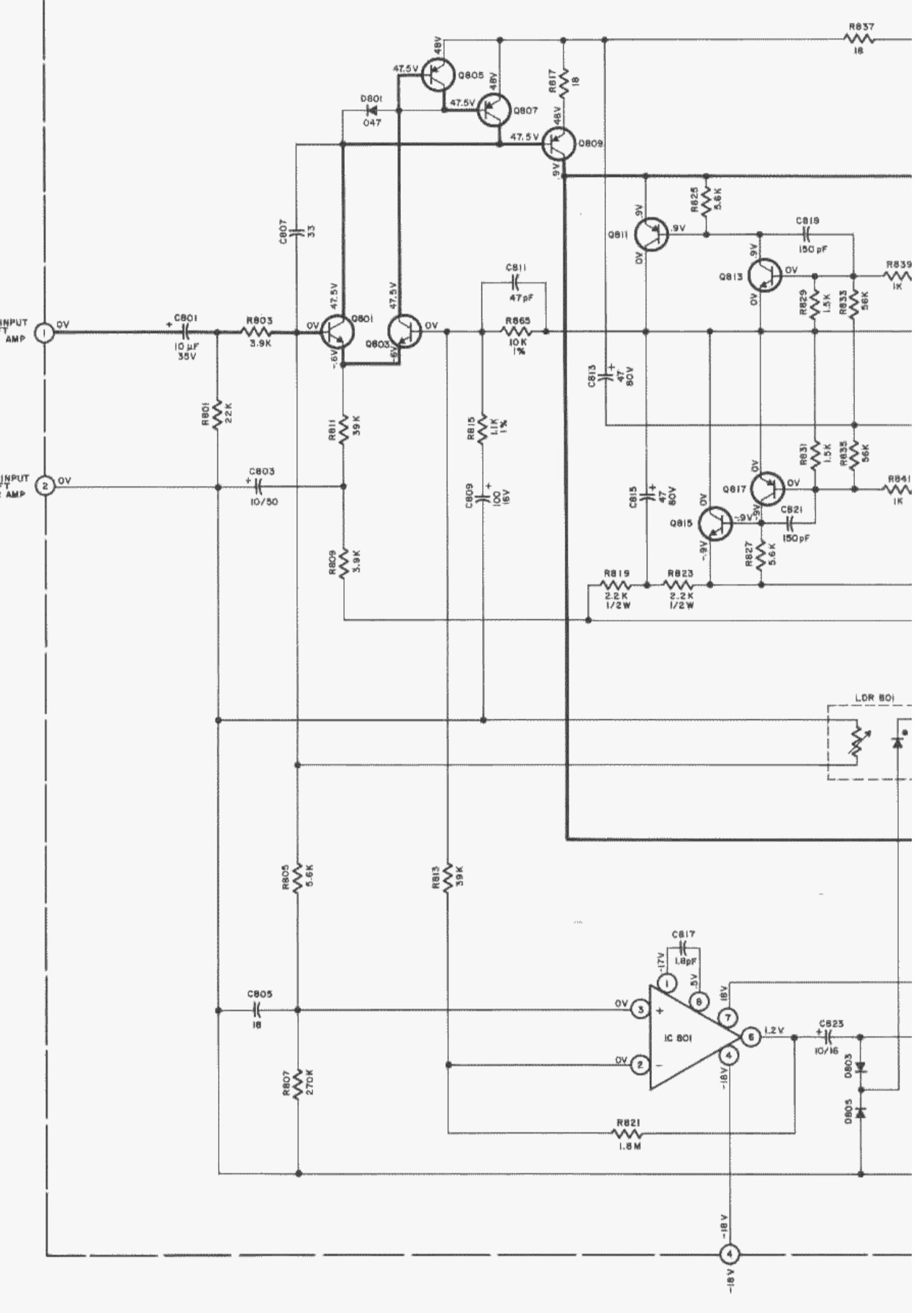

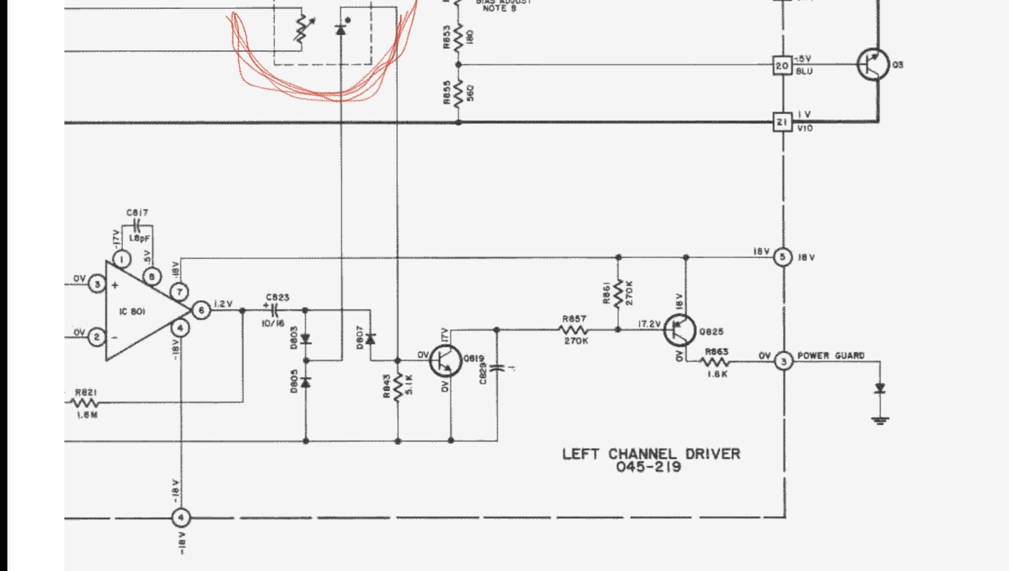

Looking at the schematic above, what’s your opinion of the changes made? I was told by two separate individuals that the optocoupler used was a pretty special device. Maybe not???

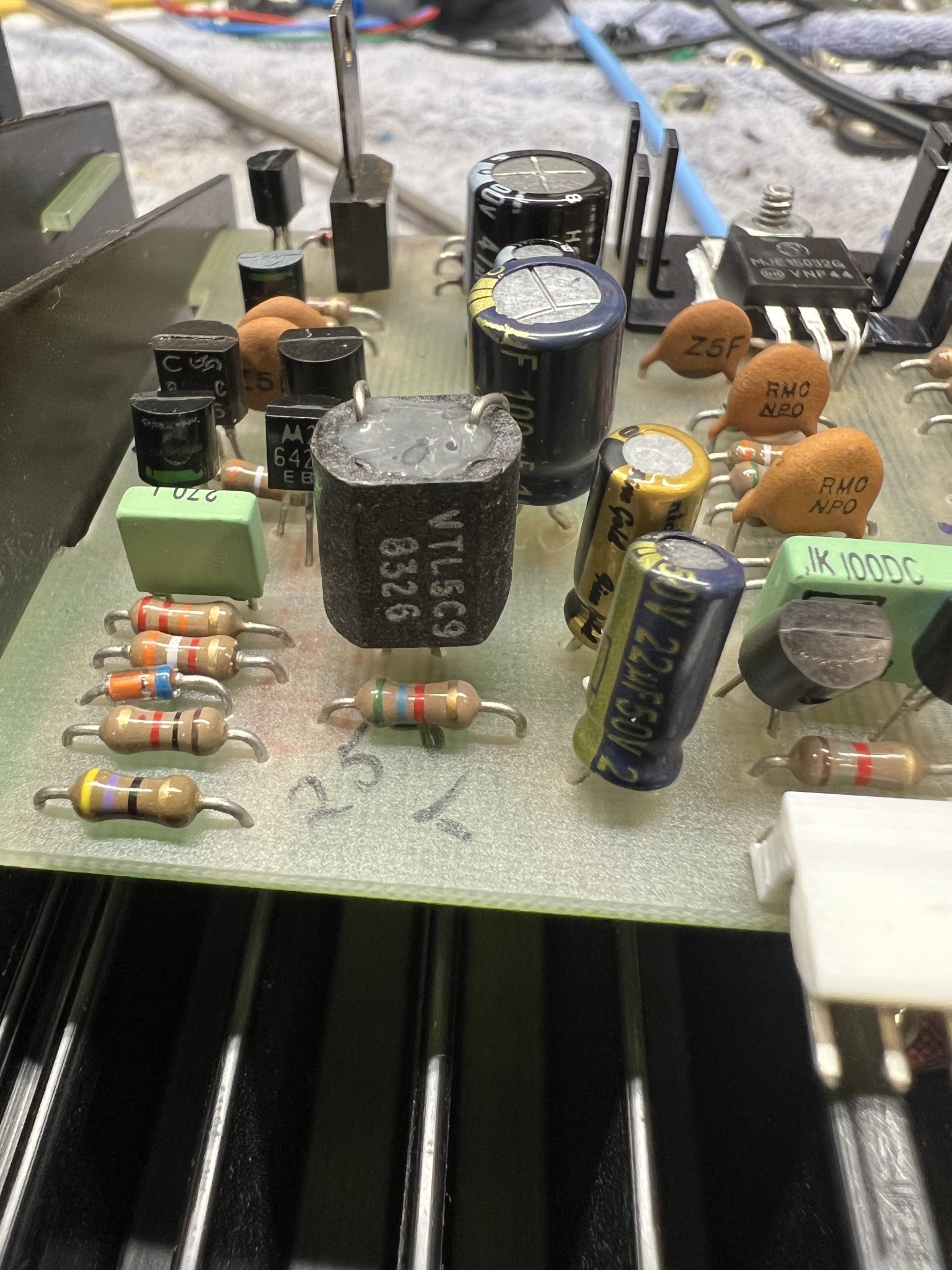

Specs roughly match your first datsheet, these work anywhere an original VTL does.

Your Power Guard is strikingly close to my own Bass/Keyboard/PA Power Amp limiters, whose job is to attenuate input when clipping is detected, and there they work very well.

Just for laughs I bought a XIVE VTL5C9. The Chinese knock off that seems to make noses turn up. XIVE being SHENZHEN FZONE TECHNOLOGY CO.,LTD https://xvive.com/audio/about/
Dark adapted the resistance of the photoelement was 5 gigaohms. So high it was difficult to measure and to all intents and purposes open circuit. At 1mA diode current the photoelement resistance was 430 ohms. When the LED was turned off, it went back to multiple Gohms within a second,
430 ohms at 1mA LED current is pretty much bang on for a VTL5C9.
I bought mine from https://www.thonk.co.uk/ , and it was a "gold star" because there was a gold dot on it. https://www.thonk.co.uk/shop/vactrols-vtl5c/
So whatever you think about the Chinese Vactrols, they do what they are supposed to.
