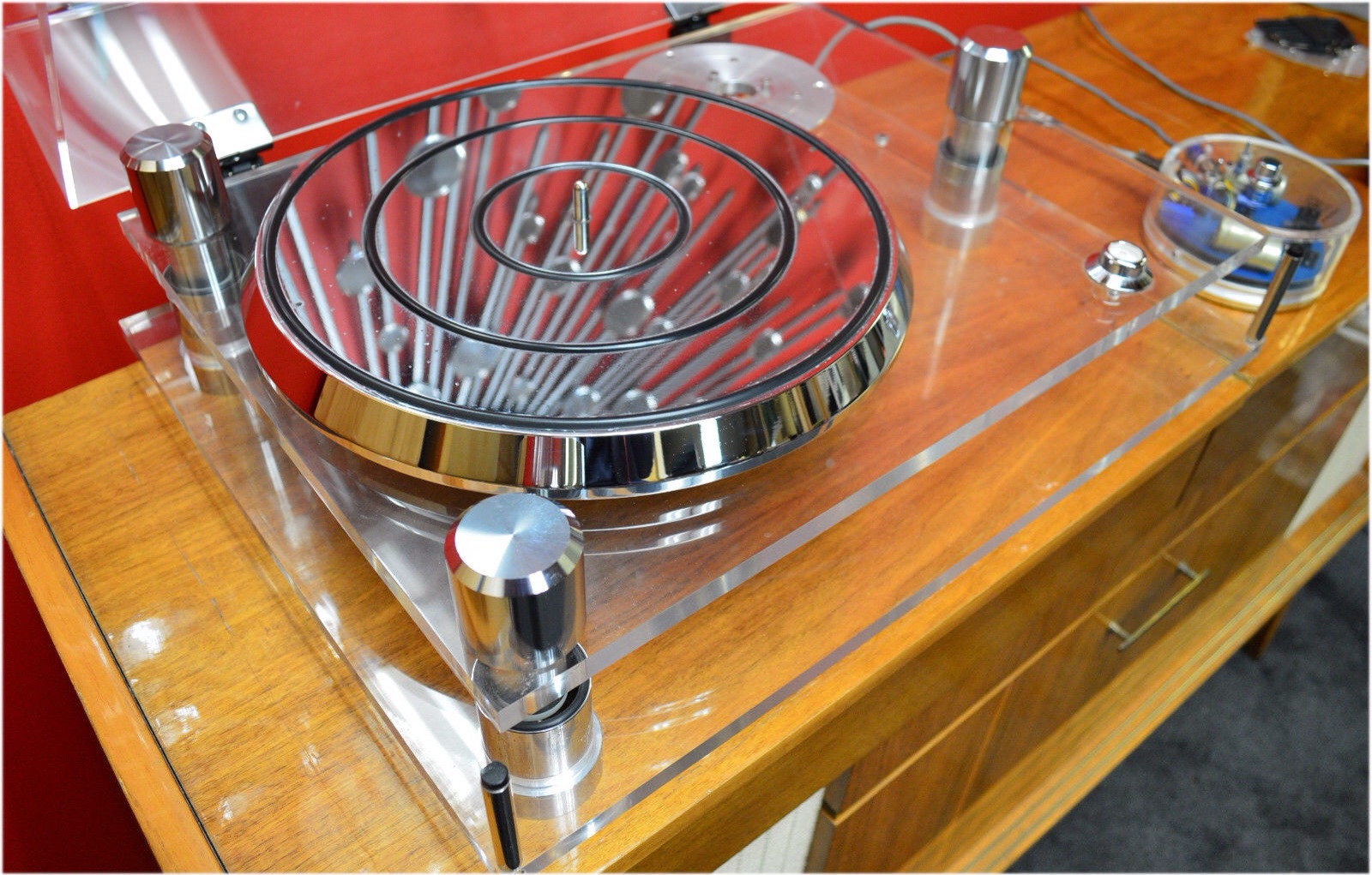

Well it's built in skeleton form. I got it running last night
I need to play around with the strength of the springs a bit but it basically all works mechanically. The platter spins and doesn't try and turn inside out on start up, it all seems very stable and the suspension goes up and down as it should. I put a record on it let it track which it did well but I can't check the audio yet as there is still work to do on the arm.
I took some pictures but it was a bit dark so I will try some more when I get home from work.
Next jobs are to wire the arm and sort out the counterweight in it, I made a longer arm tube so that it's 12" and that means it needs more weight to allow it to balance. Once I have done that I can see what it sounds like before I look to get the woodworking tools out and make a plinth for it.
These are some pictures I took the other night which are not great but hopefully you get the idea. It's amazing how a flash shows up all those finger marks, luckily I wont have to clean it all as in the finished article there will be a wooden plinth surrounding and sandwiching the rectangular plate.
Having now wired the tonearm and given it a run amazingly it works.
Much to my wife's (and to be fair my own) surprise it actually produces music!
First impressions are that it sounds very nice indeed, I am going to fit a better cartridge to see where that takes me but I am extremely pleasantly surprised.
The majority of the sweet sound I am sure is down to the arm which started out as an ADC but has had the arm tube replaced with a longer brass item to make it into a 12" arm and been completely rewired with Cardas cable.
