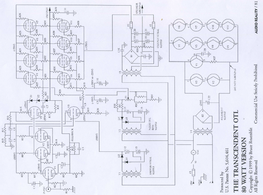

Does anyone have the schematic for Transcendant Sound Mini Beast?
I'm really not looking to build this amp or I would have ordered the kit. I am however, interested in OTL designs at the moment and was looking to see what other people have done (thankfully many designs are public knowledge). If anyone has the schematic I would really be interested in seeing it. I already own his book, so I don't need his other schematics, which don't include any single ended OTL designs.
Thanks for any help!

That eBay photo makes it a lot easier for me. I really just wanted to see what the output stage looked like out of curiosity. Should be easy enough to reverse engineer from that photo (minus the values, of course). Although a schematic would still be easier.

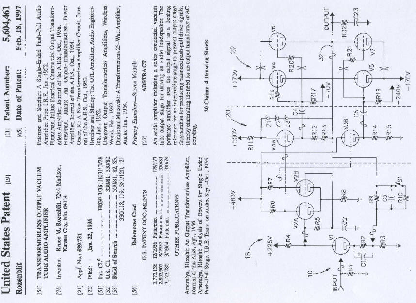

Some data about the patent of the transcendent.
Probably not exactly the same but close (I hope).
Into tree pieces to fit here.
