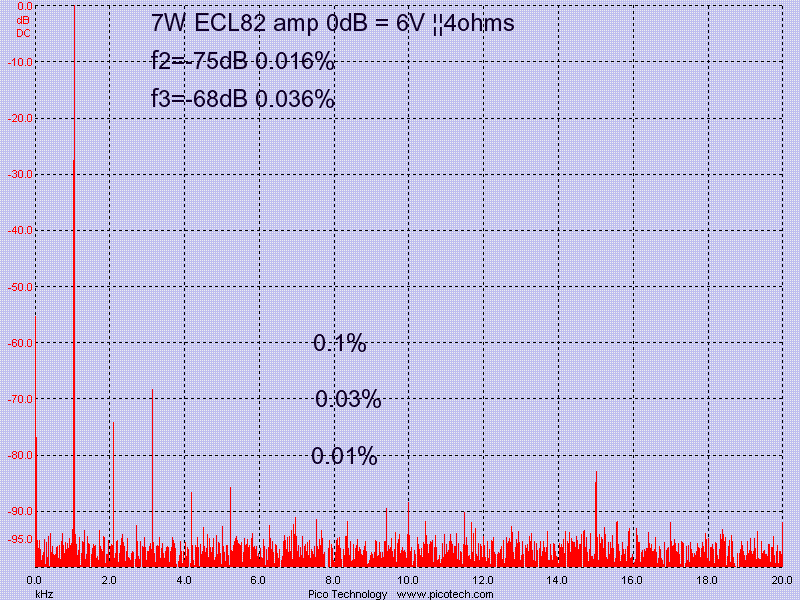

Compare with my 7+7W ECL82 amp using a regulated PSU. As expected, the power supply harmonics have vanished. Again this amp is capable of clean exceptional performance.

Very nice FFT!

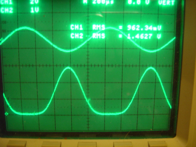

When making some changes to my amp tonight, I threw the scope on the cathode resistor to see what the current looked in class B operation. The attached photo of the trace explains some of why Bigwill sees the significant high order harmonics. The cutoff is not as sharp as his model shows.
The top trace is across a 4R dummy load.
The sharpness of my cutoff may be due to my extensive (excessive?) local feedback. This could be a double edged sword, amazing performance in Class-A, but terrible AB!
