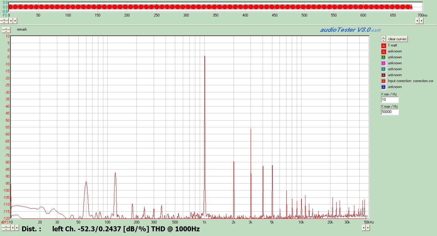

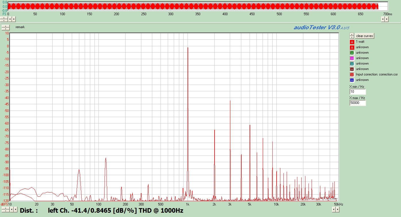

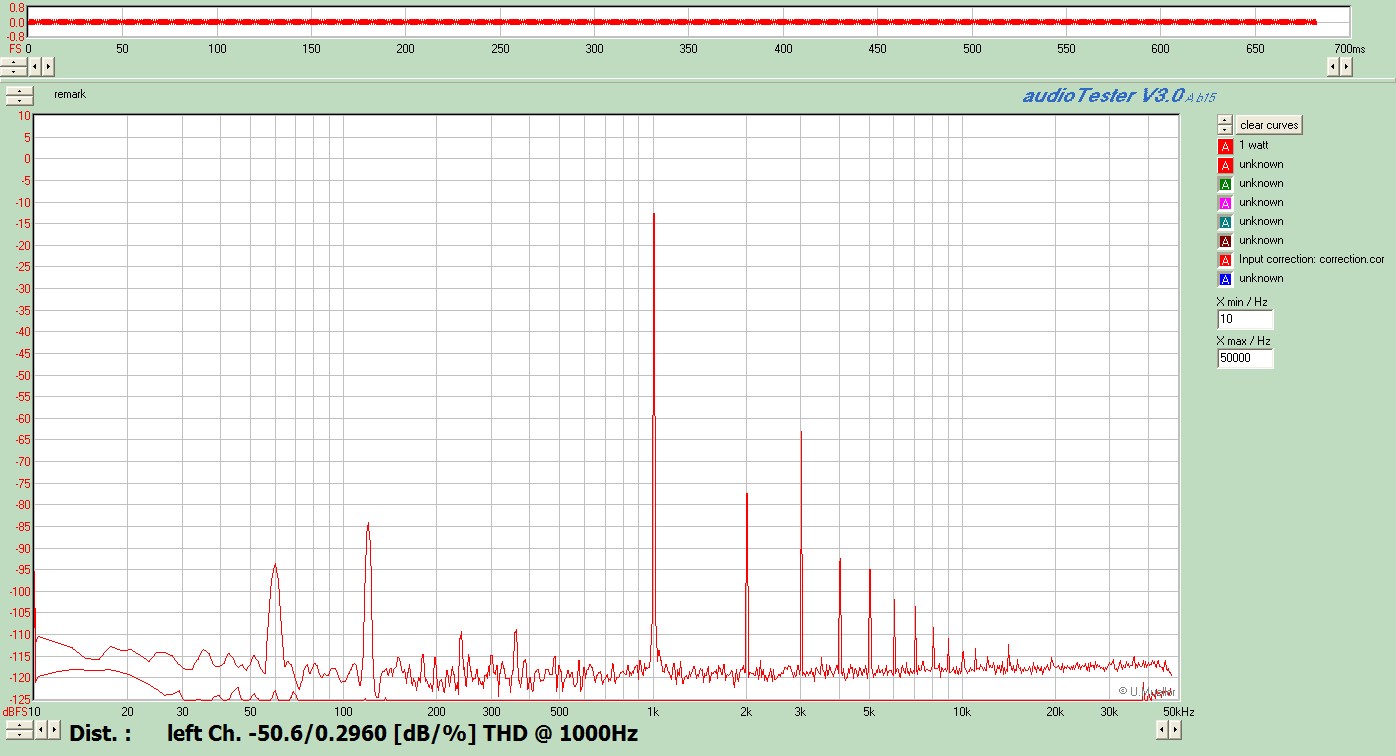

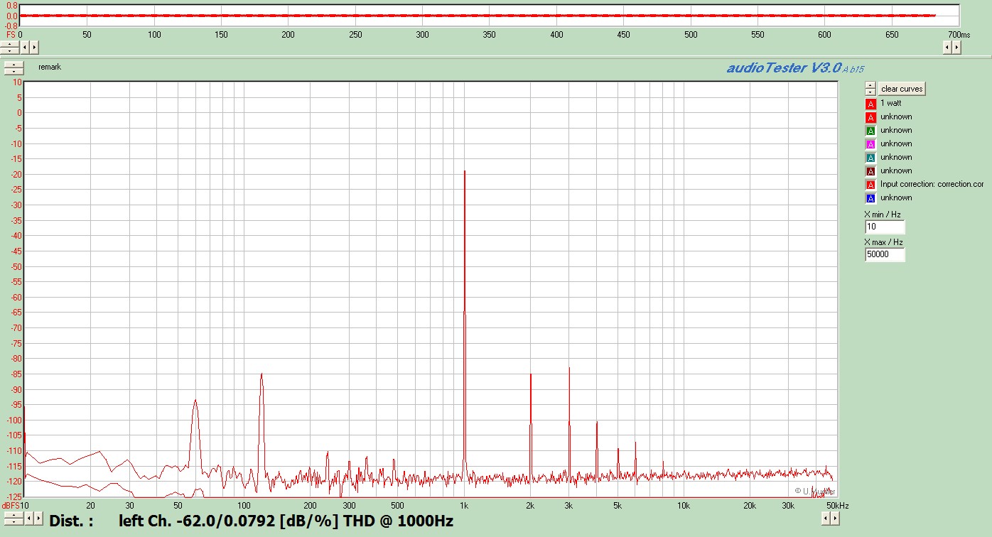

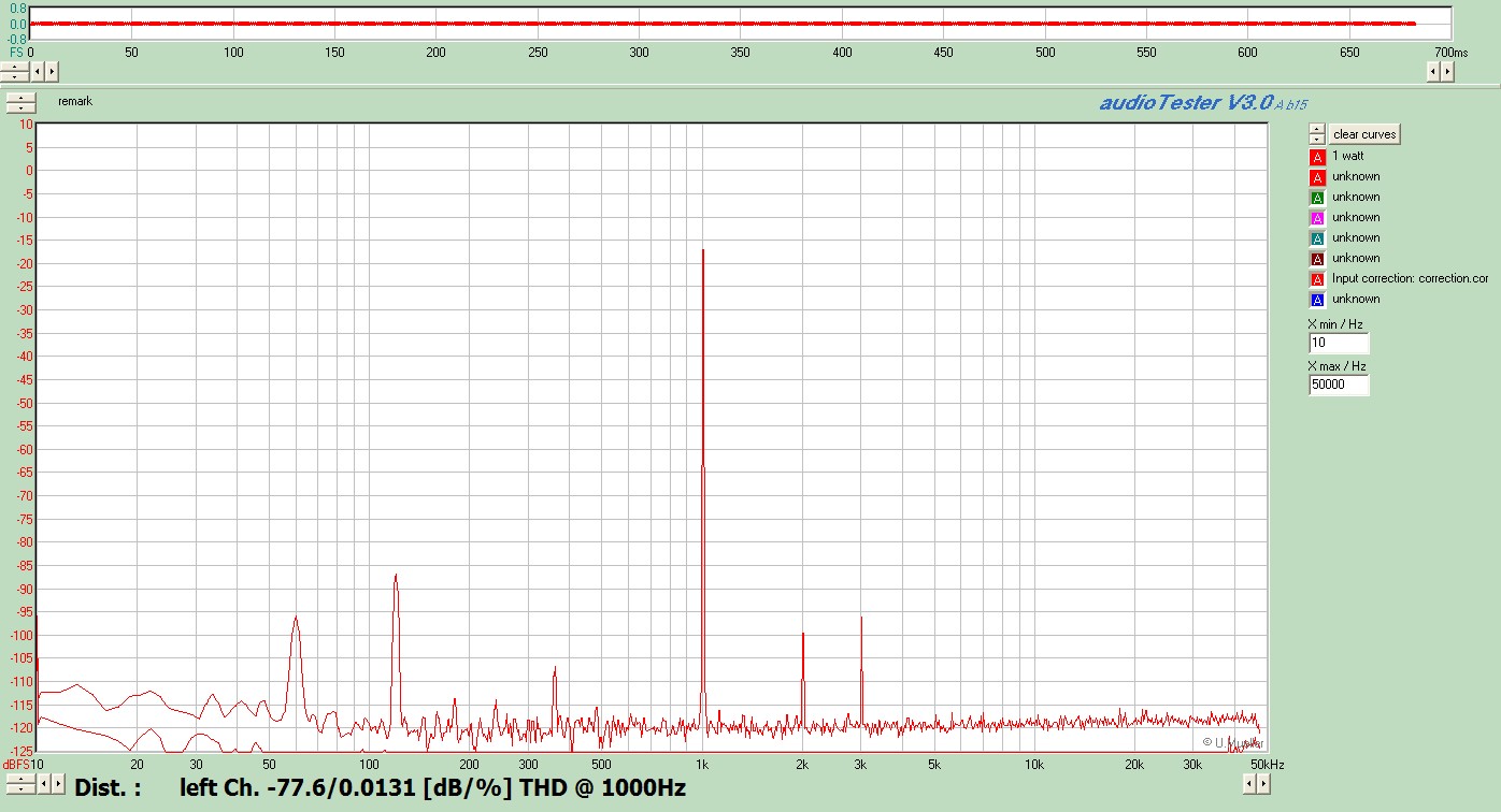

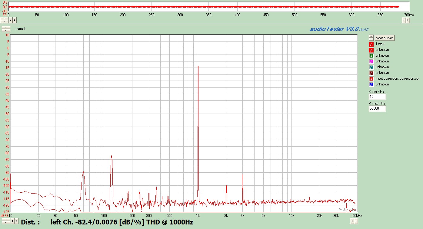

I was playing around with THD vs. Bias Current when the amp is in AB. I have only really measured THD with bias >60mA on a KT88. At 80mA I found that the THD increased slightly from 70mA. In addition, as expected, max power decreased as a result of reduced b+ (due to PT load).

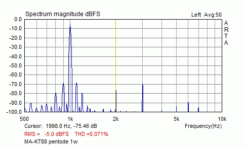

In addition to turning off compression of the simulation data and all the other tips mentioned previously, you need to set the simulation's time frame such that it starts and stops saving data at the wave's zero crossing point. Otherwise, LTspice will interprete the "partial" wave as distortion.
A good reference is also plotting the FFT of the actual input, which in SPICE software should be ideal. Very often it's not.
