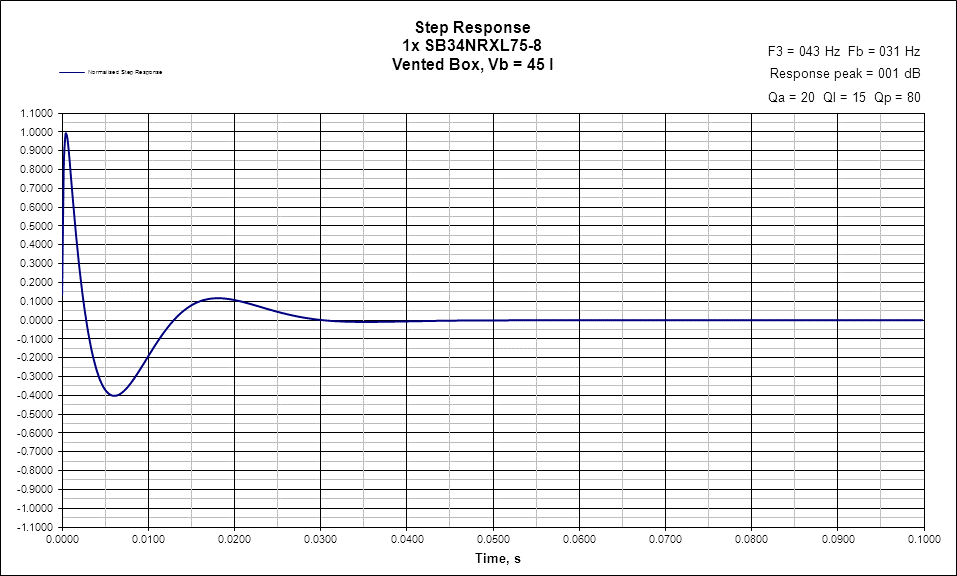

Hi Andrew, yes I also thought the 45L response curve looked nice, the tradeoff for the low tuning (and smaller box size) is the lower and bigger port resonance. Could reduce port size, but then chuffing might be an issue.
Crossed over around 200Hz it may not be an issue.

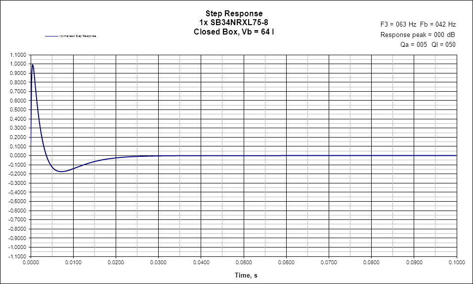

I've attached the Closed box step response as well for completeness. edit: and I've redone the 45L one with port resonance disabled just for comparison of the step response between the low Q sealed and the vented.
Andrew I've just often seen Q of 0.5 touted as a personal preference, I'd have to check what the Q of my sealed speakers are. I think probably around 0.7
*more on topic bit* My bass reflex cabinets whilst they play low are quite boomy (They were repurposed cabinets and I was pretty naive when I designed the new tuning). Their step response in moddeling is not great.
My MTM's are sealed dual 5" drivers. I definitely prefer the sound of the bass from them, but they were never intended to play low. The do a surprisingly good job though (with F3 around 80Hz).
I will likely build new cabinets for my 10" woofers and plan to go with a response more like the 45L modeled response above. I'm hoping that I won't be disapointed. I may choose a volume that would also possibly be suitable for sealed.
Tinitus, I've never build a large driver sealed speaker. The response when I see it seems it would be lacking in bass... is the reality different?

the closed shown clearly goes deeper than the two vented 😉
and maybe with better phase behaviour
the vented ones might have more phase anomalies
which could lead to bass not being perceived exactly like what it looks on paper
may be the closed also would be better with Qtc 0.55 (or so)
and then there is the room gain aspect
of the two vented shown, I would prefer the one with more rounded gradual rolloff

the step response of the vented 64L, vented 45L and sealed 64L are now modeled and available for comparison.
The closest to Butterworth has 3 ripples after the step, the near Bessel has two ripples and the vented has one ripple.
