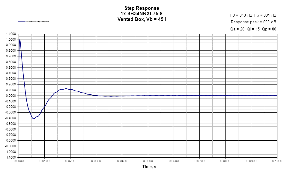

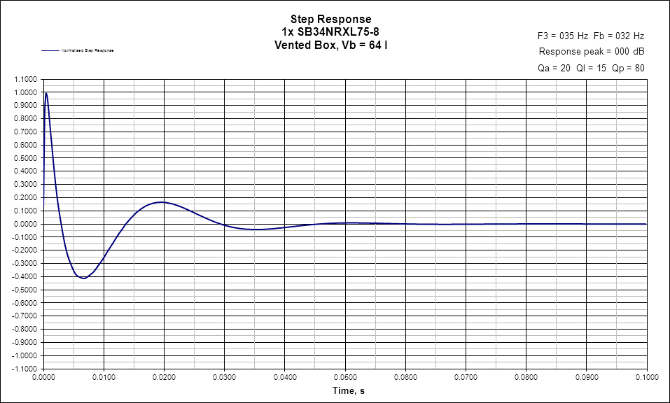

I'm curious about thoughts on differences between vented tuning. It seems that the usual complaint about vented is related to the more sluggish transisent response...
Attached are graphs of an SB accoustics SB34NRXL75-8 driver simulated in two different vented boxes.
1st 64L with 32Hz tuning (which is pretty much what unibox recommended as "standard design" and the second is a 45L box with 31Hz tuning.

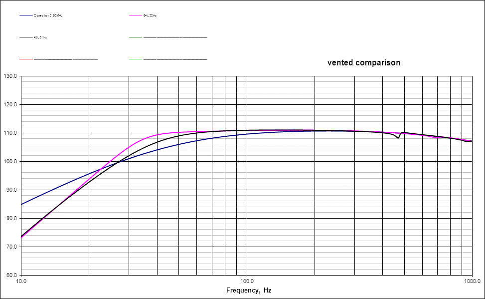

Taking the ripple due to port resonance (in the 45L box) out of the equation, do you think that the differences presented in the attached step responses would be enough to make someone prefer the smaller enclosure over the larger one, ie subjectively feel that the smaller had tighter bass? The third pic shows the difference in the rolloff between the two options.
edit: added sealed to the comparison graph. 64L Q 0.5
Tony.
really nice looking closed box alignment 🙂
yeah, I know the SB 12" got that nice low Fs, and combined with the right medio Qts, and bingo ... 😛
