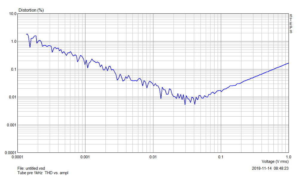

I would not like to make a test with a "defective audio" or with an audio component in clipping level. My intention was to bring the files where one of them has seemingly high non-linear distortion level, though remaining in a linear portion of the transfer characteristics. We may be confused by numbers or plots, but we may not be sure if such non-linear distortion level is audible or not with a music program.

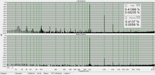

THD vs. amplitude up to 1V of the tube stage is shown below, peaks in our test sample go somewhere to 2-3V, one may use straight line approximation. Distortion spectrum at 2V is shown in another graph below, left channel is the "tube channel" and right channel is the "wire channel" as used during the test.

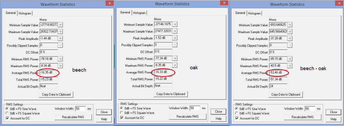

I have used these newer 24-bit files to create a difference file, 24/bit files simply for the reason that we work with small resulting amplitudes and that the difference created from files with higher resolution is more precise. The "difference" between tube path and direct path can be downloaded from
http://pmacura.cz/trees_diff.zip
Small phase shift were suppressed so the result is mostly the non-linear distortion of the tube path only. Please tell me if you think that the resulting sound is "pleasing" to your ears.
Regardless how stressful the non-linear residuum sounds, one should bear in mind that the amplitude is small, if you compare volume with files from which the difference was created.
As a conclusion, non-linear distortion is never "pleasing", regardless distortion profile, the opposite is true. The only question is at which level of distortion it starts to be audible.
