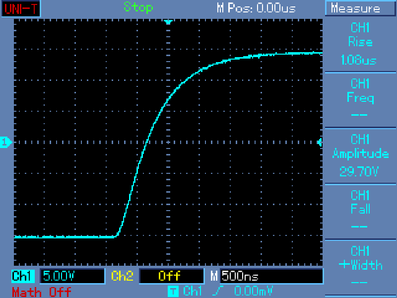

If you are calling for rise time measurement, it is the easiest thing to measure and it is about 1us for this circuit, which reflects in >300kHz -3dB corner. Everything seen in time domain has its image in frequency domain. However, non-linear distortion is not easy to see in the scope screen, unless you use a notch filter. IMO everything is well known and there is no need to "investigate" some different methods.

I see more like 3.5us , and what was the frequency for the square wave or was it only a rise time test?
Can you do the same test with 10000hz square wave with 95% duty time at only 2v peak-peak into a speaker or resistor?

No, rise time is defined as the time between 10% and 90% of the total step swing level. We need to keep standard definitions and we need to have some basic knowledge to lead such discussion. BW is then 0.35/Tr and it fits quite perfectly.
10kHz square or single step makes absolutely no difference in Tr (10%-90%). It (rise time) is always the same. And I cannot load a link preamplifier stage with a speaker. This is a task for the power amplifier, I hope you understand the difference.
I am sorry but we need to keep some knowledge level. I am not going to debate the elementary definitions and principles, as it would start a never ending circle of off topic questions.
I apologize, this is not my profession, but a very serious fun hobby.
I thought the raise time was from a power amplifier. Sorry.

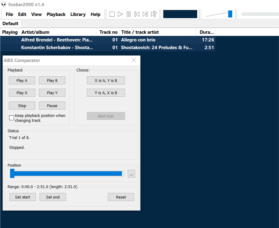

Very good, so would you be willing to make a Foobar ABX test and post a protocol? It should be very easy for you, in case you clearly hear a difference. I am still waiting for a first positive ABX protocol. It is very easy to make the test.

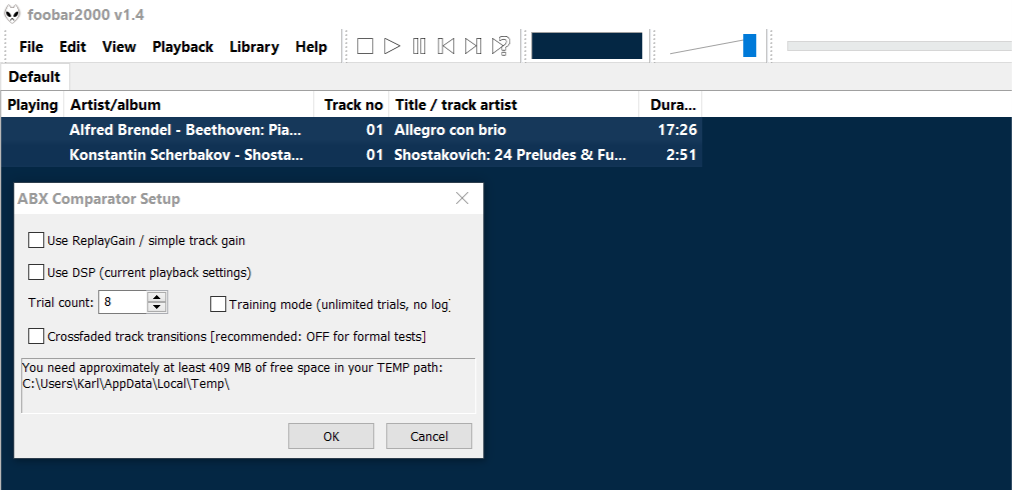

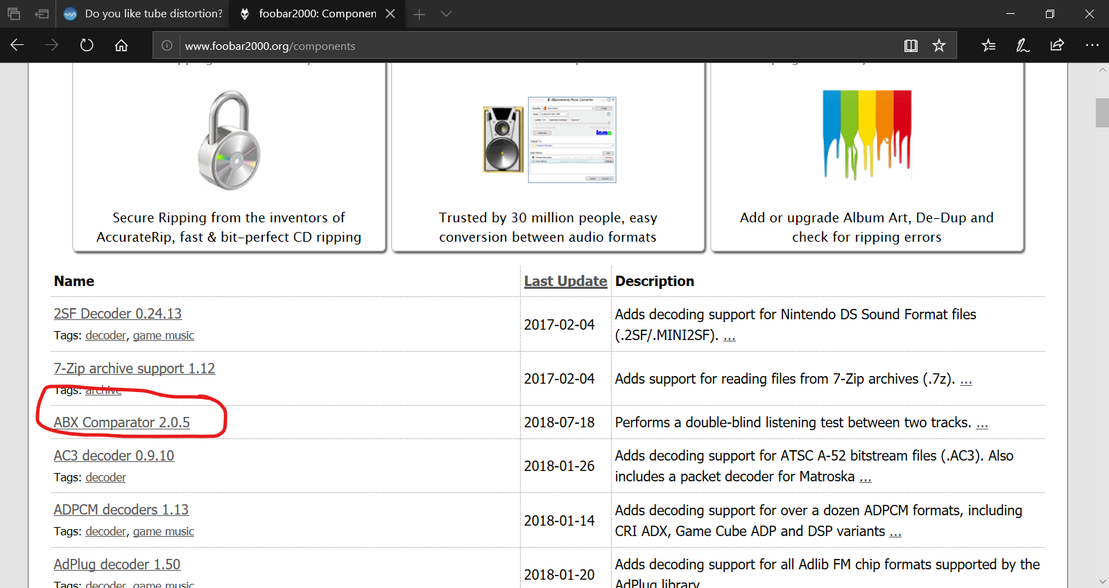

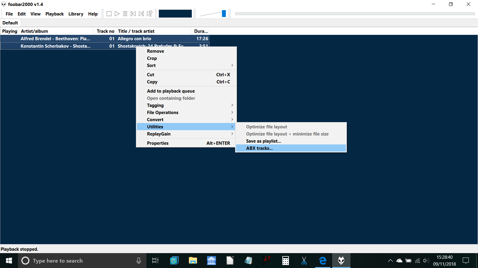

You have to install the plugin. Once that's done put two files in your playlist, select both, right click on them and the ABX option will be in the drop down menu.
This one:
foobar2000: Components Repository
Select (highlight) the tracks you want to ABX and do as Pano says and right click the highlighted selection.
When you have done, highlight the tracks again and right click and 'Remove' them (removes them from Foobar only).
(I got 100% on this, good eh 😉)
