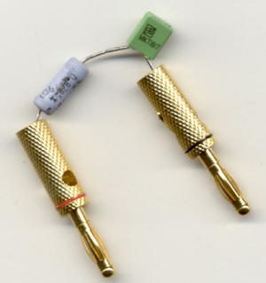

You don't really need a switch to compare effect of Zobel. Here's what I'm using.

"You don't really need a switch to compare effect of Zobel. Here's what I'm using." -PD
:whazzat:

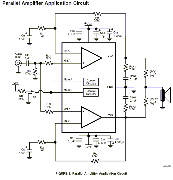

From the data sheet:
"LAYOUT, GROUND LOOPS AND STABILITY
The LM4780 is designed to be stable when operated at a
closed-loop gain of 10 or greater, but as with any other
high-current amplifier, the LM4780 can be made to oscillate
under certain conditions. These oscillations usually involve
printed circuit board layout or output/input coupling issues.
When designing a layout, it is important to return the load
ground, the output compensation ground, and the low level
(feedback and input) grounds to the circuit board common
ground point through separate paths. Otherwise, large currents
flowing along a ground conductor will generate voltages
on the conductor which can effectively act as signals at
the input, resulting in high frequency oscillation or excessive
distortion. It is advisable to keep the output compensation
components and the 0.1µF supply decoupling capacitors as
close as possible to the LM4780 to reduce the effects of PCB
trace resistance and inductance. For the same reason, the
ground return paths should be as short as possible.
In general, with fast, high-current circuitry, all sorts of problems."
*Parallell amps call for a zobel for each amp

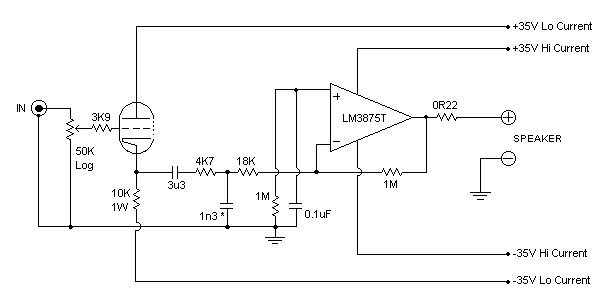

Neither Joe Rasmussen's JLTi , no Thorsten's original schematic carries a Zobel network http://jwg.student.utwente.nl/fedde/audio/images/invertedLM3875.gif
There were countles amps built around those schematics, and rarely oscillations occured. Even in case of oscillations, it was not presence of Zobel that eliminated them. It was usually improper wiring. I know about it, as I was closely following all those posts.
I also had an amp in one system, that was badly distorting. Adding Zobel didn't fix the problem. Changing for different speaker cables did.
