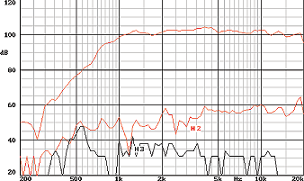

The FR plot on that Seas looks terribly ragged at the top-end.
I wonder if that's because Seas have used less smoothing and better scale (5dB between grid lines) in their graph than most people. It seems to me that the only wide band speakers with very smooth response also have lower than average efficiency.

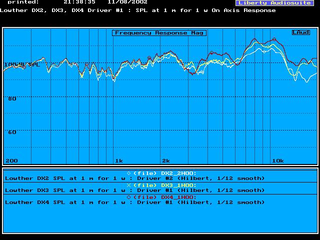

Lowther Dx series:
-Legendary 'full range' drivers
-$1,000-2000 USD a pair
--> measured (Martin King's site) to have a 20dB variance between the 3kHz dip and 8-11kHz hump

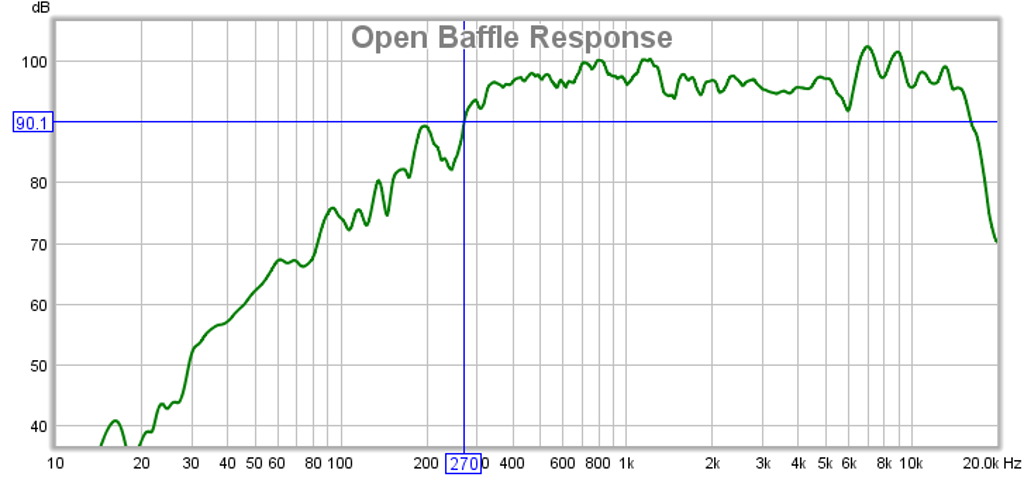

The PRV 5MR450-NDY:
-an efficient wideband mid
-$200 USD a pair
-xrk971 described it glowingly, and was "shocked by how good this measurement looks"
--> he measured a 10dB variance between 6 and 7kHz. It looks much better on the factory graph because of smoothing and confusingly marked grid lines.

The moral being (IMO) that a few peaks or dips probably don't matter too much, unless they are part of a grosser issue, like an up-tilted response. Once the Seas overall response is flattened down to ~89dB (see the Madisound site) it looks about as flat as any similarly efficient speaker with that bandwidth.

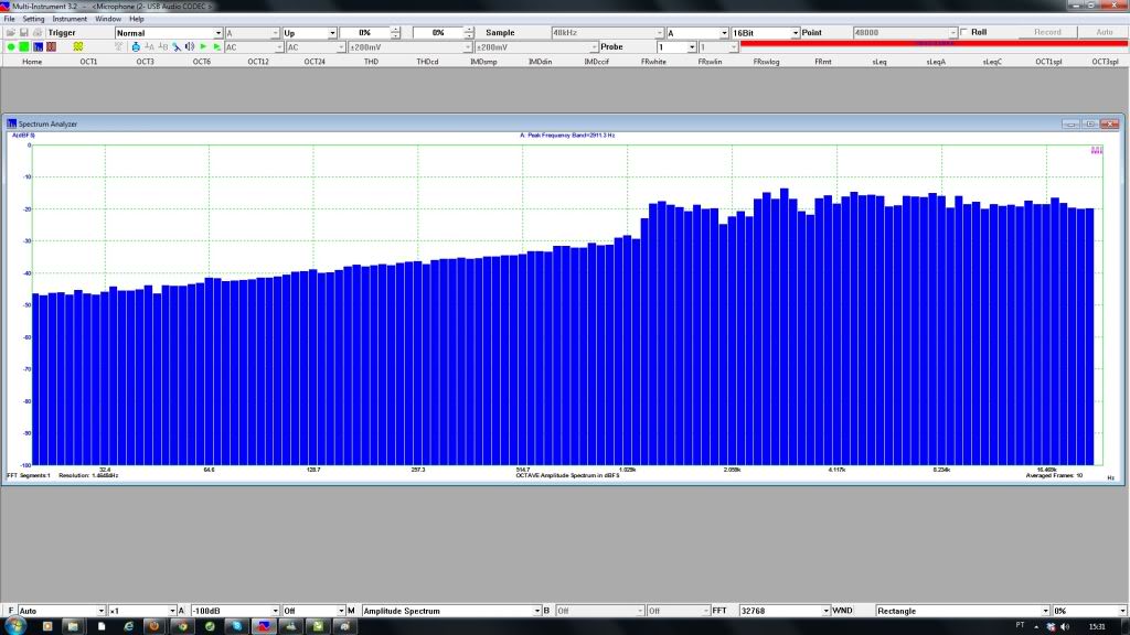

They have arrived and I have knocked up a stunning box for one of them. ��
They haven't had much break in and the box is a bit leaky and not stuffed or lined, so I am expecting a bit more from them when I build some proper boxes but so far all is good.
With eq bass is plentiful in a small room. I guess that a lot of 8 inch drivers put into large boxes would out perform these in the bass department but in my room they will be fine.
In terms of overall sound quality they are great I have applied a mild 3db dip across the presence region and will need to measure them to narrow this down to the cone breakup but they are fast and detailed and don't have the dramatic rising response that is said to be typical of whizzer cones.
