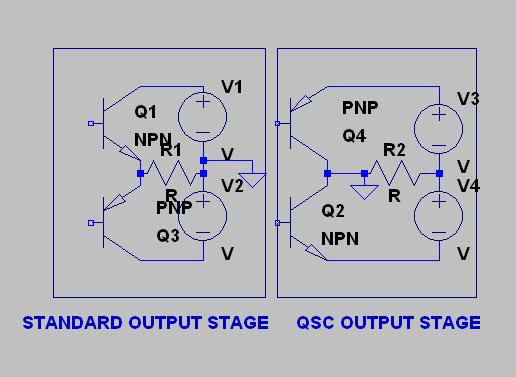

the QSC is a class B solid state amp that has the outputs tied to ground. the power supply center tap is left floating, and becomes the speaker output. the amp works by "walking" the power supply rails, and the power supply center tap voltage "walks" with them, providing the output.
i know the amp fizzard is talking about. similar design, but done with a switching supply, but i actually had their original "heavy iron" amps in mind.
the QSC amp has two design advantages:
1> the output collectors are grounded, so heat sink insulators aren't needed
2> the amp can be driven by an input stage and VAS operating from +/-15V rails
in the picture, pay close attention to where the ground is:

American Audio is the one of the "knock-off" manufacturers. Crown does mostly standard output stages, but i wouldn't be surprised if one or two models of their amps do the QSC thing as well.
i've also seen an American Audio amp that was a class-G version of the QSC-like output.... that was a beast to troubleshoot.
i am pretty sure QSC came out with it first. it's a simple variation on class-B that has good reliability and safety benefits (you could, with such a design actually put the output devices on the outside of the case without needing the plastic covers usually needed on exposed TO-3 cases). the only trouble is that you have to kind of "think backwards" when troubleshooting it since the power supply rails float with the audio. it kind of threw me for a loop the first time i repaired one, but once i understood what was being done, i was fine (what? they're "driving" ground????????)
