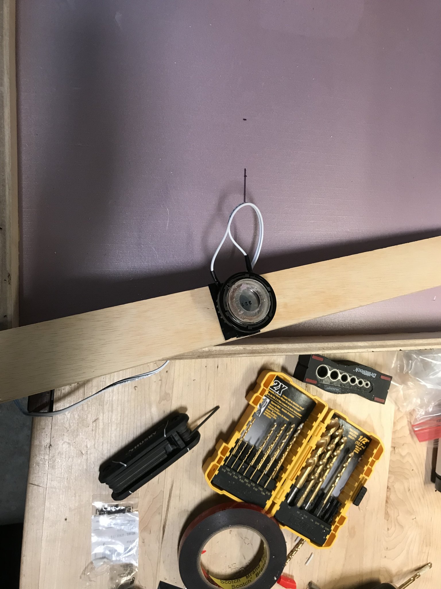

For those who stumble across who want to mount their speakers vs. hang them, I think this is the simplest way to do it. These three strips above are just secured with two small drywall screws each (should probably add a third). The first picture on this thread is of a pocket hole, for those who haven't seen such a thing. Four of these holes for 4 screws to secure it firmly to the wall. With the frame plus this secure mounting, the sound is more full and substantially better bass. It measures strong down to 80 hz at least, which is about where I had my sub crossover prior to the frame discovery.
I'm going with the 3/5s by 3/5s exciter mounting. The next two pictures are of the exciter mounting to the spine. Thanks to the experts on the main thread, I learned that the little hole on the back of my thrusters is for a machine screw for mounting. The documentation does not mention this.
Do you need a spine? One of the veterans on the main thread is adamant that the spine does not increase sound quality and has tested substantially. So it goes, the claim is that the weight of the exciter will distort the voice coil over time. Frame yes; spine no. Well, I figured I've gone this far I might as well build the spine. That tiny screw is barely adequate if that. It's still hard for me to believe that threaded hole is actually for mounting, and isn't an artifact. A single screw to hold an electronic device blasting out energy, and not even a lock washer? It's too weak to hold it to the wood on it's own, so I have it pulling the exciter into a bed of spongy double-sided tape. I took a pic of the screw specifications; got it at Home Depot.

These thrusters are being re-used, and these two aren't the ones with detachable bases. I pulled off all the old adhesive and just using wood glue for now. You have to attach the speaker cable first, then attach the exciter to the spine, then attach the spine to the frame.
Here's why I could go either way with the spine. Okay, down the road maybe the voice coil will have issues, maybe it won't. But your going to damage the voice coil on day one if you're not very careful about attaching that spine. I attached the spine and then glued, and put about a pound of weight on the spine to make sure it sticks. Once it's dried, now you have this heavy, long piece of wood attached, and tiny movements at the ends will put a lot of leverage against the voice coil. And so you've got to convince yourself that you've got it perfectly straight as you put those screws in. I used a long wood clamp to hold it to the frame, but even with that, the force of an impact driver putting the screw in could change the position slightly.

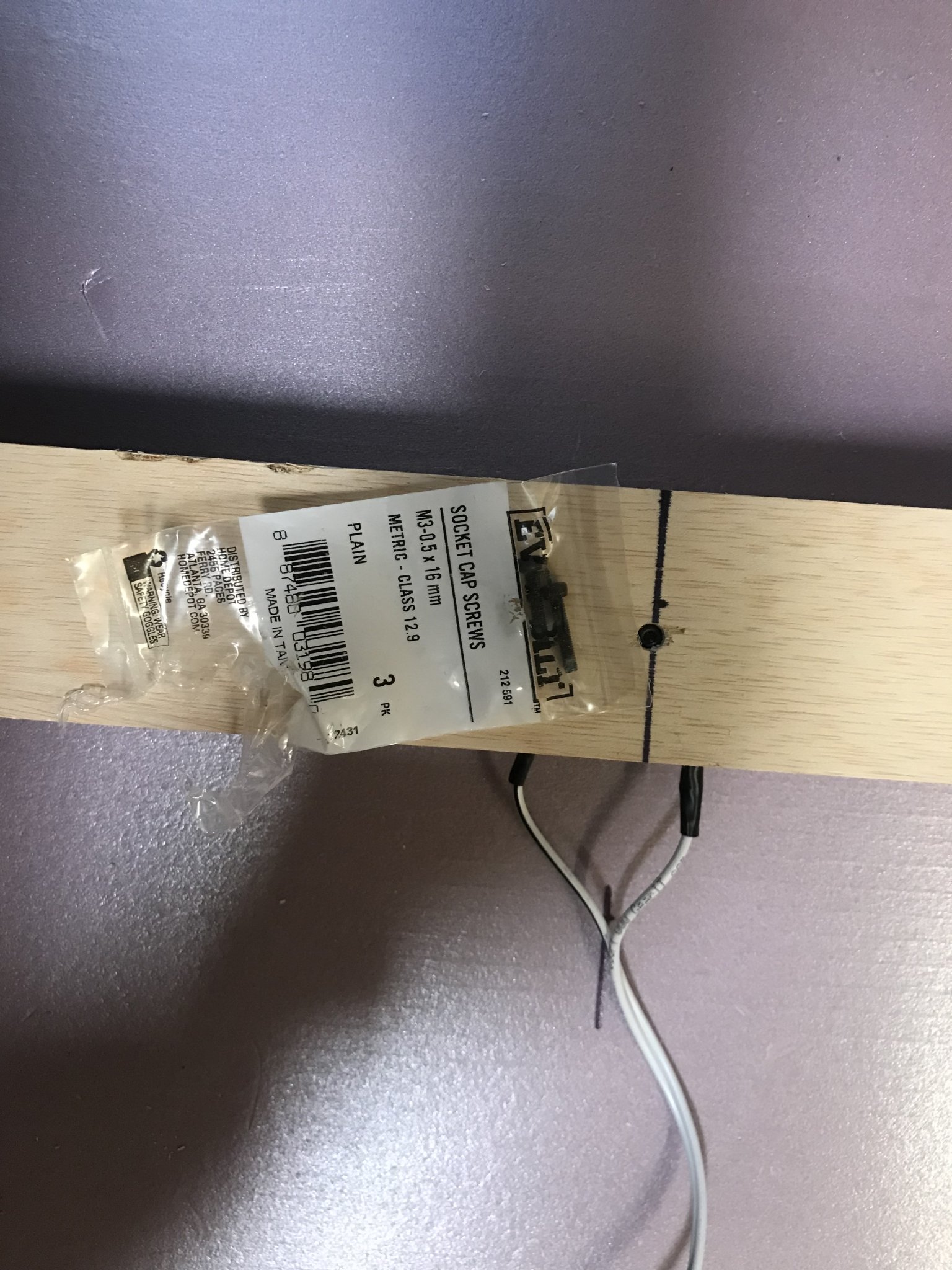

Another note, for the third unit, I was off on connecting the screw to the hole, and the 2-sided tap got it and was too secure to back out and try again, so I'm ditching the screw for that one. Pretty sure the screw doesn't add much.
For the mounting I have in the above picture: the veterans in the main thread gave me hell for it. You know, the whole move the speakers out from the wall by x feet rule. Well, we've seen the many videos of youtubers hanging on the wall, and this method is going to be way better than that. But the veterans have a point, I experimented a little, and the difference is enough to make me re-think how I will put them on that wall. But to really know how good the speakers are going to sound, better get an ideal reference. I've toyed with the idea of either making two sets, or making these dual purpose -- they can be removed from the wall to set up in the center of the room, where I'm testing now.

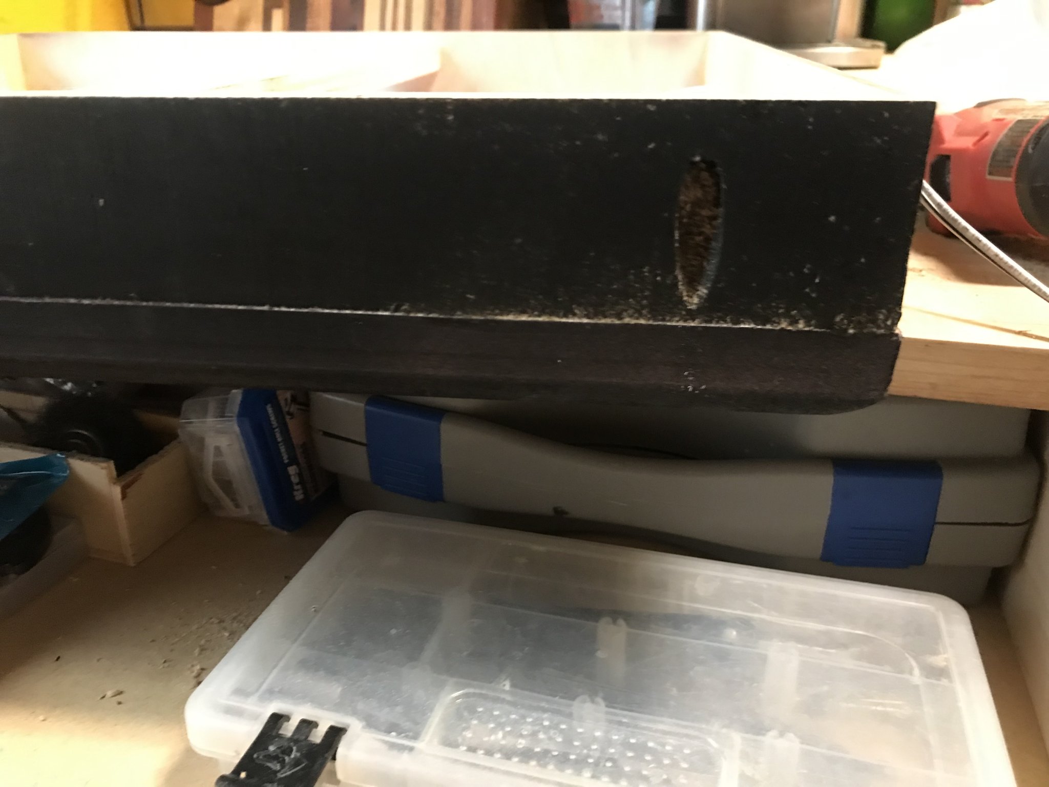

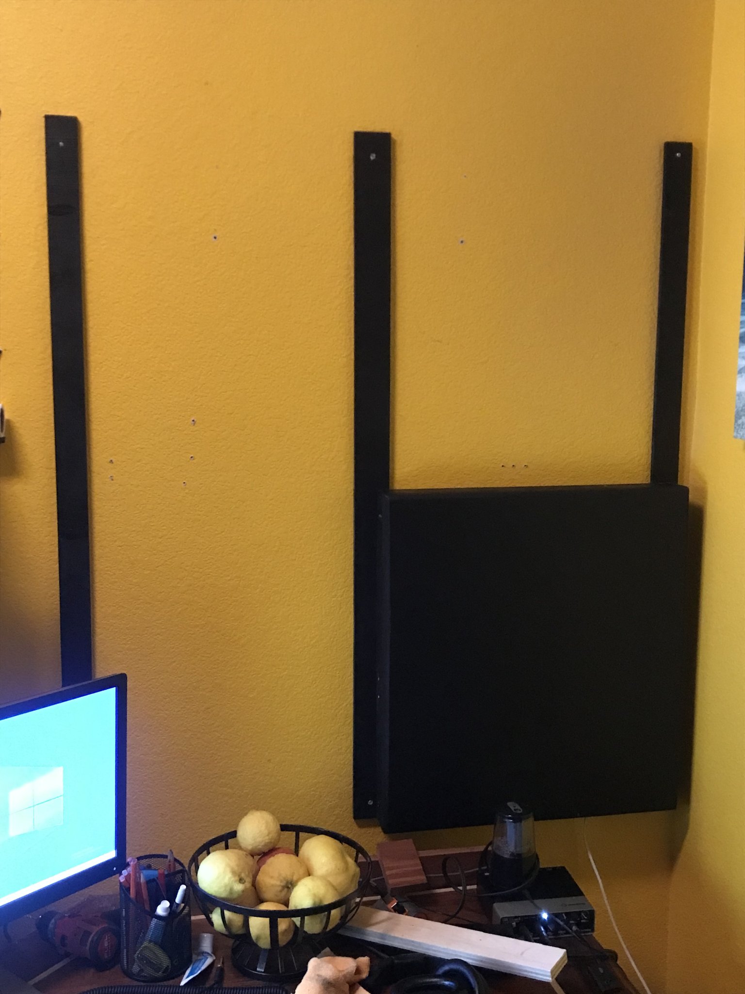

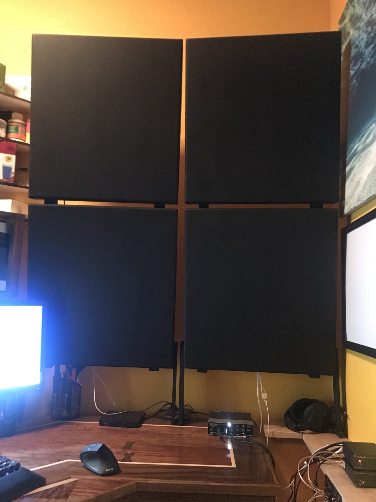

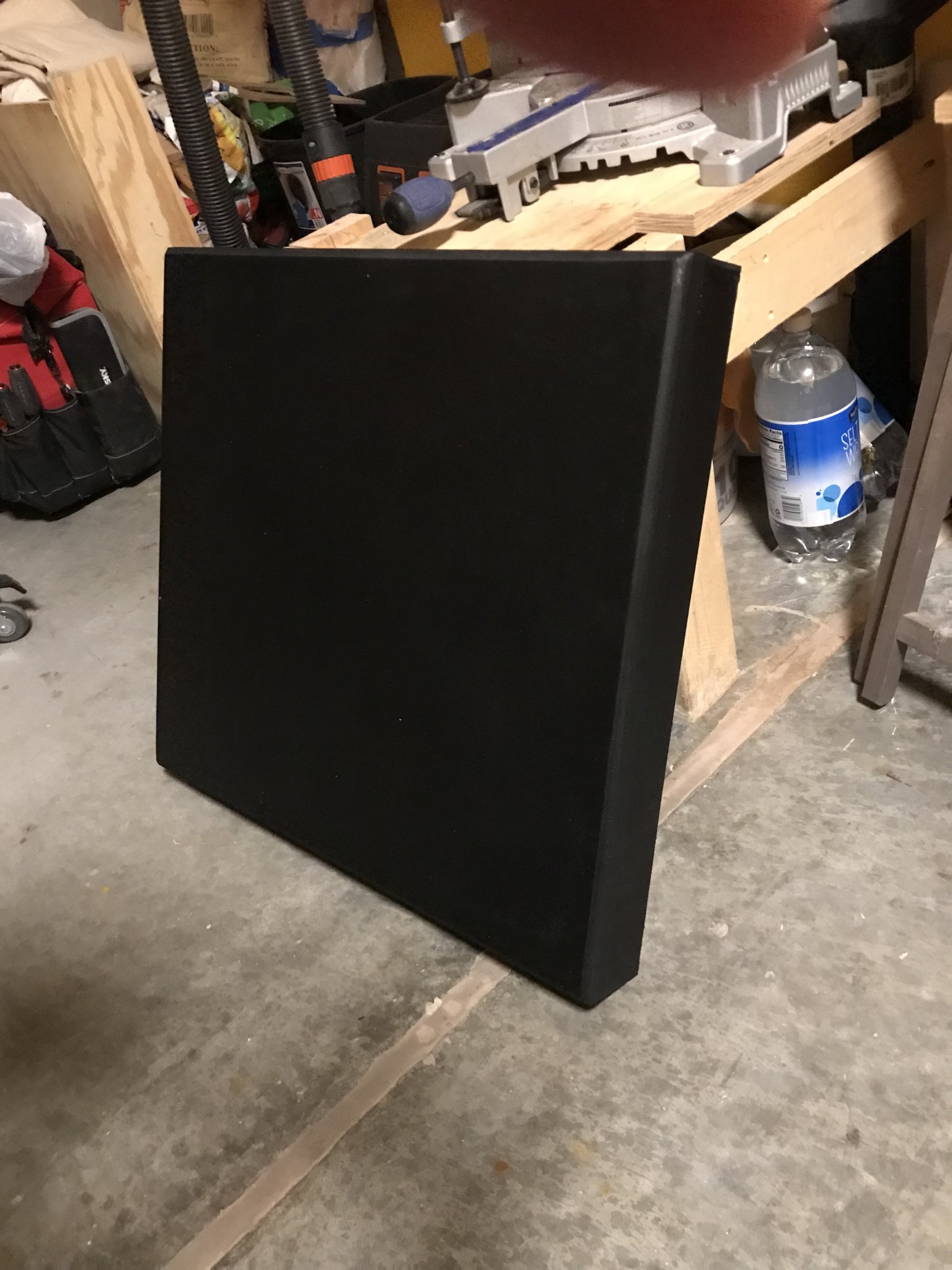

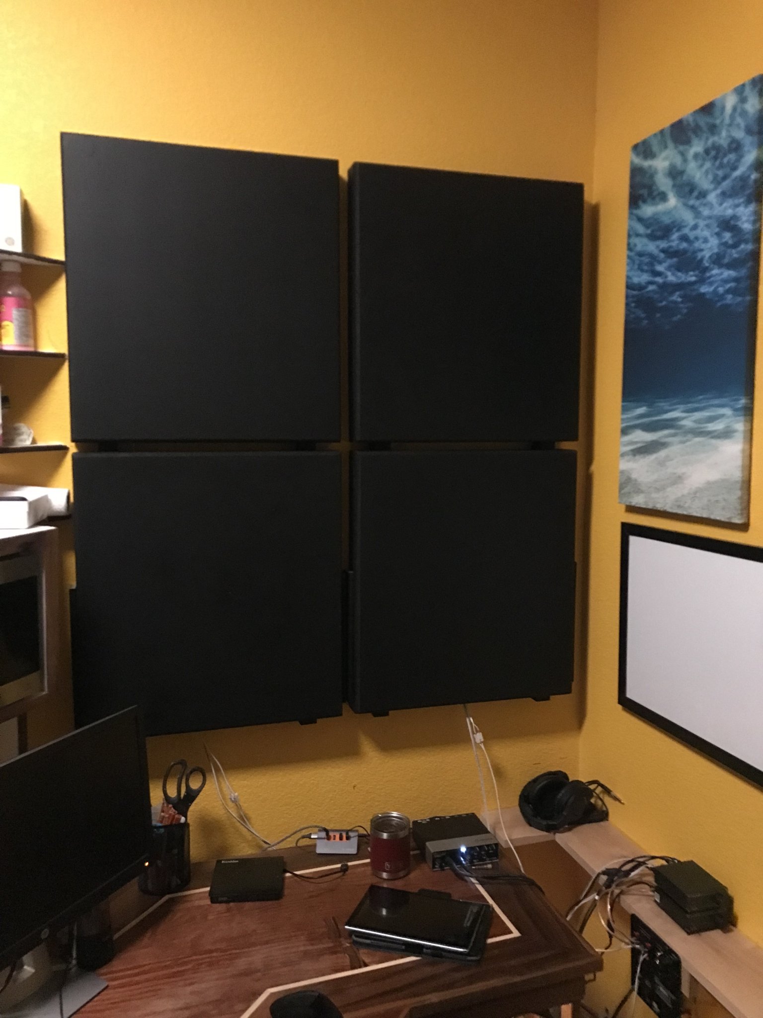

I think the 1.0 project is done. In the final version they hang by screws on the wall, for better sound they can be moved forward onto the desk and lean at an angle so they aren't parallel to the wall (as Spedge instructed). And then they can also easily be removed and setup elsewhere; clamped. Each tower is bolted together so they are modular.
I got the second Fosi audio TB10A; they have 80~ watt power supplies. So the signal is split off my audio interface and each pair have their own amp. I also have a 6.5" sub with 25w Dayton plate amp. I'm working on a second sub but don't really need it.

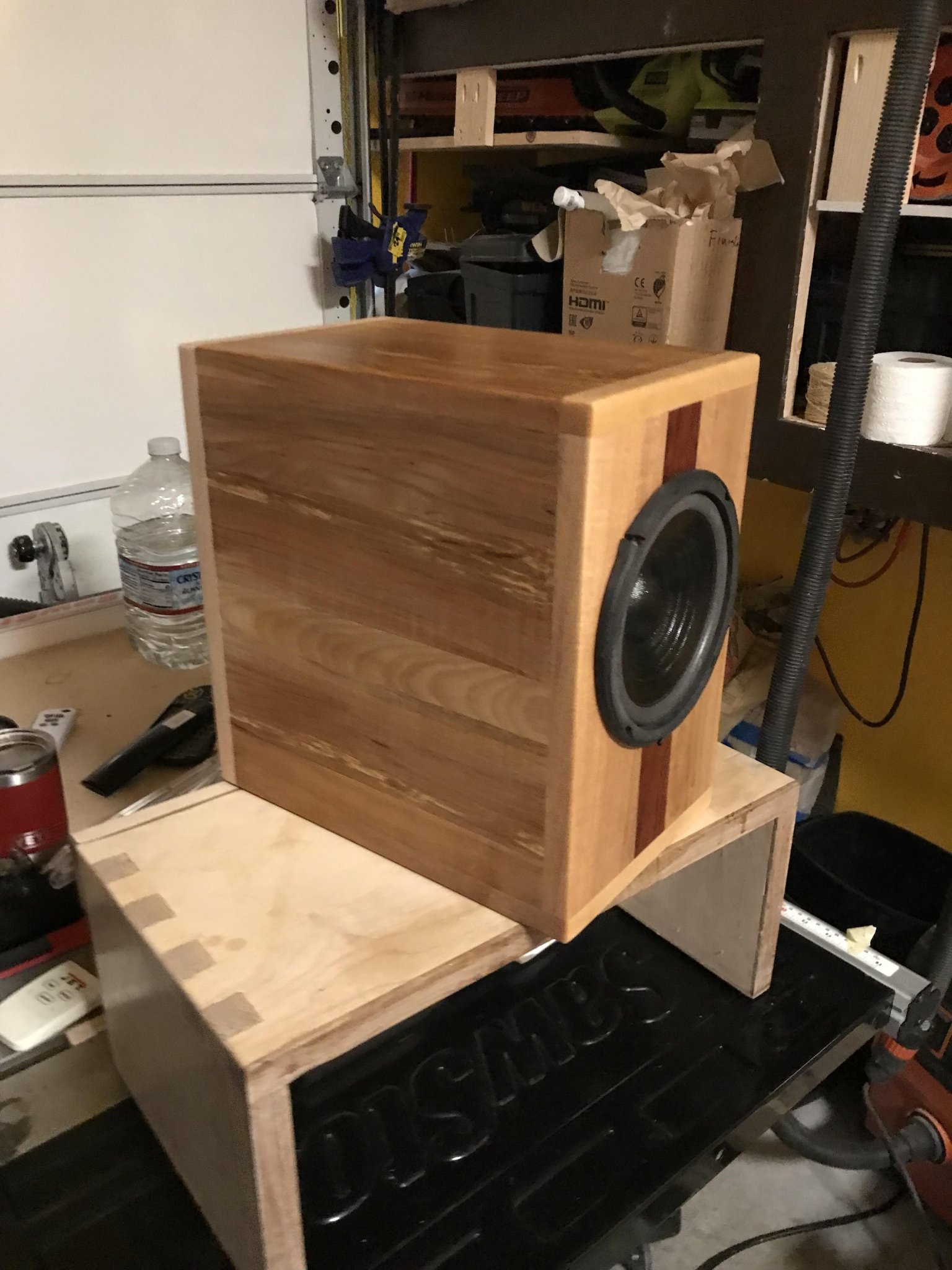

A final summary of lessons learned is in order for my fellow DML newbs who are a bit confused given all the incomplete and conflicting info out there.
I started with the coin exciters, and especially with sub support, you can get them sounding pretty darn good with cardboard or foam. I toyed with the idea of making some bookshelf sized speakers out of the coins but scraped it. The coins produce incredible HF. But they were killing my ears, I'd feel sea sick after listening for a half hour and ears would ring the next day. With the larger speakers I've had no issues, even the night I set them up in front of my recliner and blasted them for a couple hours (relatively, peaking around 82 db), I had no issues (last pic; I didn't have matching amps at the time so didn't go too far).

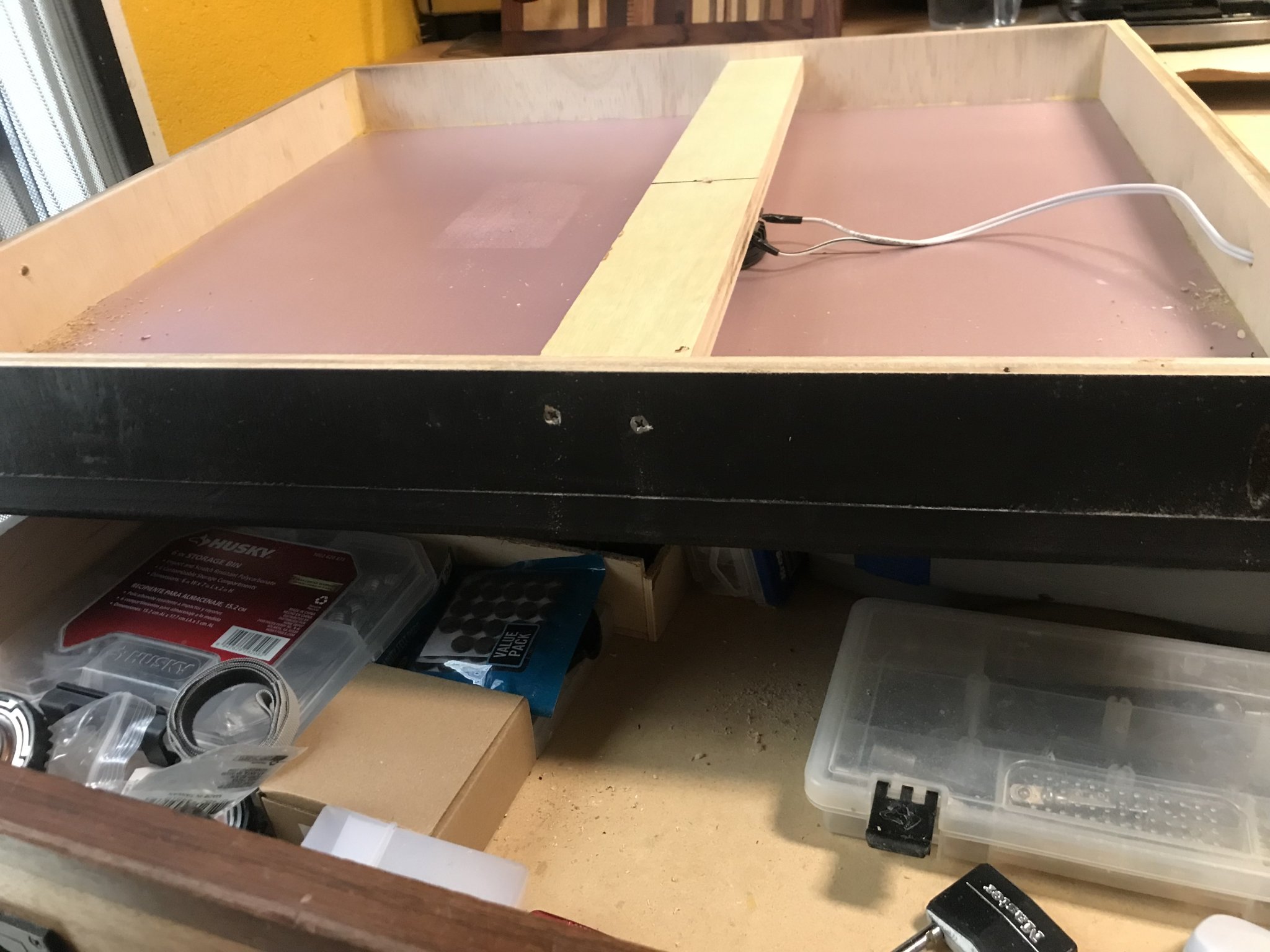

Lessons learned on the big panels. See pic 3; the frame. That's the number 1 missing component from every youtube video copying tech ingredients. For acoustic music, they are truly full range. The night I had them set up (last pic), the first hour or so had no sub support, and the bass sounded great. That's entirely the frame. I discovered it by accident. The veterans on the main thread know about it, but it wasn't discussed during the time I was experimenting. I had build a frame for a coin speaker, hoping for a "tight drum" effect and it didn't do anything. I didn't hurt the sound though, so I built a frame for a junker foam piece, to make sure it didn't mess up the sound. At that point, a frame would make it possible to have a normal rigid speaker that can be mounted and utilized easier than hanging by a wire. When I tested it with a deep cello, I about jumped out of my seat. I grabbed my phone with the free db app and sure enough, it was lighting up below 80 hz where its non-framed partner did nothing. It was like discovering penicillin. So when people following tech ingredients talk about requiring a sub or getting a crossover at 150hz; not true at all. They can stand on their own. Once you get into rock/pop that uses deep electronic drums, sub becomes necessary. Fast metal doesn't seem to work very well even with a sub, but part of the issue is that recording quality makes a big difference, so no verdict. Tool, for instance, sounds great, even without the sub.
My advice is to get the foamular panels, place the exciter at the 2/5 - 2/5 point or in the center if you want, you can hold the exciter to the foam and move it around and see what sounds best for you and then stick it. Don't sand or round corners or any of that stuff yet. See what it sounds like no frills. Then add a frame to one and compare. At that point, IMO, the battle is 90%+ over.
Not much more to say besides get a big exciter, good adhesion, and attach a frame. But if any one other thing is worth mentioning it is the paint. How does the paint affect the sound? I layered the liquitex on my panels pretty heavy, and I think they sound perfect. I did pretty extensive comparisons between a painted vs. non-painted panel before committing. The differences weren't so dramatic (not like the frame) that I could say for sure the paint made a difference. Slight mechanical differences in the exciters, slight placement differences could also explain the difference. I cautiously want to say that the paint made them sound better. I think it dulls them slightly. DMLs are bright and airy, and I think sanding them increases the brightness, and my trial pair were sanded. thin xps pieces I sliced on the bandsaw were extremely airy. You naturally want to say the brighter, airy speaker sounds better. But, there's a "bathroom effect", it's like adding a bit of reverb. There was one spot on a classical guitar performance I was using to compare; the non-painted had a distinct "tap", like a fingernail striking the guitar top. It sounded pretty cool, and I didn't get that with the painted. I finally listened with headphones, and it was standard fret noise. So the sanded, non-painted was exaggerating that into a tap, like what might happen when playing in a bathroom with lots of echo. I worried a lot about painting them though, because I noticed in some of the youtube TI copies, guys that were painting were adding tweeters. It's possible that a different exciter might have issues with the 1" xps or with the paint? A sub is one thing, but something has to be really wrong if a DML needs a tweeter.

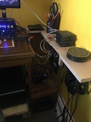

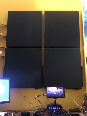

Throwing up an update for the Annals of DML pioneering. Like many of my hobbies, I work at things for a while and then abruptly stop everything and go do something else. I think in this case where I ran into the wall was the fun stuff was worked out, and lots of tedious tasks remained that I just couldn't deal with at the time. Months later, and I still had only used my panels in the forward (in room, off wall) position, but when I saw Dune was on Netflix, I found the motivation to finish the arduous task of fixing banana clips to all the speaker cables (it's a lot of connections) for the multiple positions I use them in. Also built little feet for the speakers.
I may one day build some walnut feet or something but for now, it works. Sounded great for the movie, about what I expected. 2.0 but with DML the sound is bigger, and so save the best mastered stuff out there I don't think I'm missing much.
I ended up with one Fosi audio 50x2w per panel, or rather, one drives the lower speakers and the other the uppers. The lower routes through a 25w plate amp to the 6.5 sub I built and a 100w Dayton chassis for the 8" sub.
After several months of listening, I'm still very happy with it. Of course, you always want more and I'm considering some sub upgrades even though for the 1-car garage listening space what I have is sufficient. It can get really loud in here. But the panels are have some headroom for more volume, and to keep the bass proportional, if I really was going to blast it, would need some more sub power.
A few comments on the DML speakers themselves, after 6 months, they've held up fine. All exciters are doing their share and not prying themselves away from the foam boards -- I just used Titebond 2 and that seems to have been good enough. I used All Dayton thrusters. The top panels are the permanent thrusters, and bottoms have the bases the exciter attaches to.
After months of listening, I still cant decide which style I like better. The units with bases sound richer but someone might think they are muddy. The others are brighter; some might think too transparent. So If I built them again, I'd do it the same and take the benefits of both worlds. I do like having the "richer" unites paired with the 6.5" high Q sub. Just those together are great for acoustic music and vocals. The small sub helps fill in the 80-100k range much better than the mammoth 8" sub for the DMLs. with the DML frames, some kinds of instrumentals barely need subs. Classical guitar can sound great without a sub with the "richer" units. Once you throw on Jesse Cook with all the toms, well, then you need to big sub.
I also listen to a lot of synthwave and I think these are great for that, especially with the bigger sub. I've even used them for studio monitors and I think they are better than the monitors I used in the past (they weren't high end or anything). Generally, the DMLs can hang on the wall out of the way and they're great near-field, or filling the space at high volume. And then just once in a while I would deploy them to one of the other 2 positions. With the clips, that's much faster now.
Reactions: AdamThorne

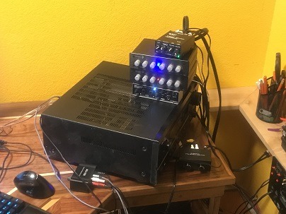

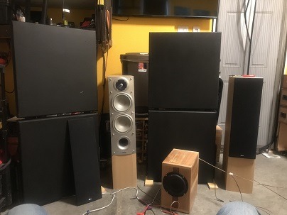

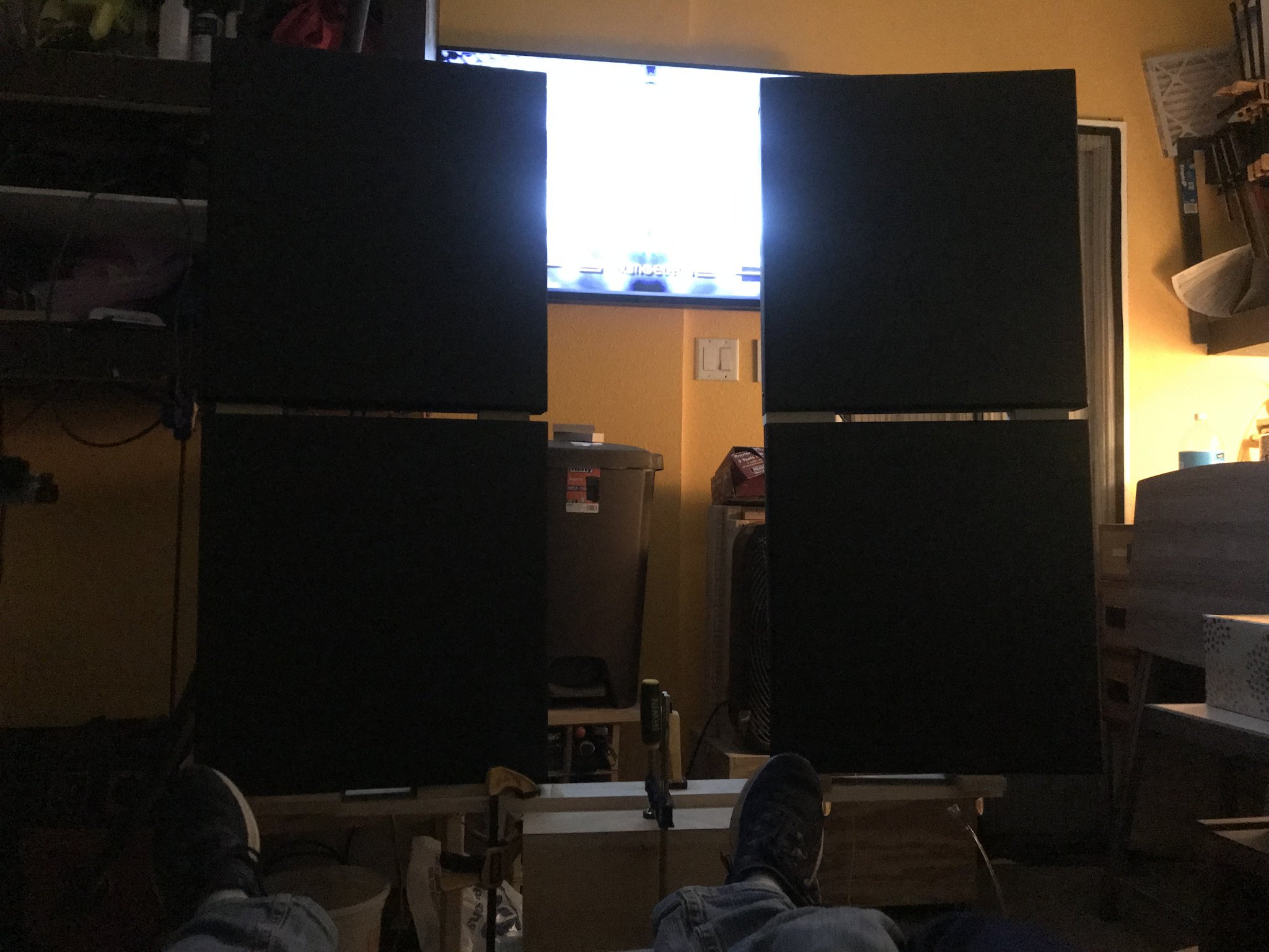

I finally found the strength to haul some of my old (and unused in 15 years) audio gear into the shop for a showdown with the panels. It's one thing to be blown away by how good a 20$ device glued to a piece of insulation foam can sound, and another to say it's good as compared to a real speaker. I tried this earlier in the year but was hampered by so many "little" problems that I ended up putting it all back. This time it worked out, with just barely enough cabling to have everything set up in a test where I can A/B the competing chains.
Each panel is 24" square XPS mounted to frame with a Dayton thruster; top and bottom driven by separate Fosi Audio class D amps. To make it fair as possible, leaving the larger sub on the bench and using the little guy with the 6.5" Tang Band driver, and I do have an active crossover on that chain.
Squaring off is my Denon AVR-1082 receiver with 2 Energy Connoisseur c5 speakers. Once upon a time there was this place called Good Guys where you could go to buy audio gear and listen before you purchase. My HT application had some height constraints for the towers, but compared to all the other options at around that height, especially the Klipsch they were always pushing, these were by far my favorite. Definitely fun to reconnect them and hear what they sound like after all of these years collecting dust.
I've been listening to all kinds of music today while turning the A/B switch back and forth. Bottom line is I'm not sure there is a clear winner. On the one hand, it's impressive the DMLs can even compete, but the c5s, good as they sound to me, aren't 10,000$ speakers. And so even if I were to say the panels win overall, it's not by such a wide margin that dropping a few thou on a higher end conventional speaker wouldn't fix that problem for good. I do plan on doing further DML builds but it's hard for me to imagine gains that would compete with true high-end gear.
Review in next post.

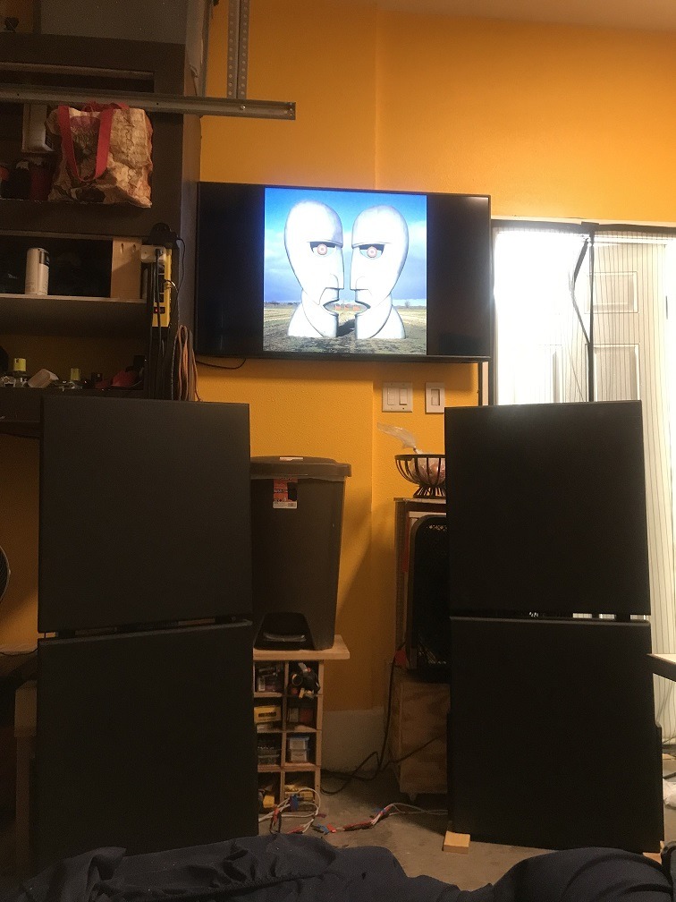

I'd say the most important test is with symphony orchestra. There's lots of reasons why symphony music makes for ideal benchmarking IMO, but most important for this test is the lack of reliance on the sub. Even with big crescendos the sub is barely moving.
As I get used to the sound of the c5s and then switch to the panels, my negative reaction is that the panels sound flat and the c5s rich and warm. As I get used to the panels and then switch to the c5s, my negative reaction is that it sounds like a field of sound has just been scrunched into a box.
I think it's hard to compare. As an analogy, when I got new glasses ~ 2000, glasses with small lenses were becoming popular and the guy told me when I first put them on it's going to take a while to get used to them, but eventually your brain figures it out. He was right, the world was totally distorted for the next half hour or so, and then everything seemed normal.
There were times when I went to the A/B switch and moved it the wrong way because I thought it was on the other pair.
The c5's are more detailed. Faint instruments jump out that I have to listen for on the panels. The downside is that sometimes the highs on the c5s get harsh. I wasn't expecting that. Now, I'm using thrusters, but the seasoned DML guys use exciters that are supposedly more detailed. I am going to do a build with those in the coming weeks.
With a symphony, where the panels seem to shine is that in a crescendo, it gets bigger not just louder. The panels definitely feel like they have more breathing room.
Going to the opposite end of the music spectrum to electronic music; techno, synthwave, ambient, basically all of it sounds better on the panels. Granted, the sub has far more bass capability than the c5s, and that's part of it, but I do turn it down and try to mentally compensate for that. Electronic music generally likes to sound huge and the panels deliver huge just fine if it's a good recording.
Jazz and Straits / Floyd type rock is again a close call. Vocals on the C5 sound "breathy" while more natural on the panels. I think a lot of people would like the C5s better for some vocals. The c5s sound rich and with presence, while the panels sound relaxed and with more distance between listener and instruments. Heavier rock generally sounds better on the c5s, but I think some of that is the panels are pretty revealing, For Metallica, the older stuff sounds like it was recorded in a tin can. I tried a couple tracks off of Reload (CD), and it was a much closer competition. I think for distorted guitars the C5s still win. For acoustic guitar and steel guitar, and especially if there's reverb, the panels win.
Going to do some more listening tomorrow and then pack out all this heavy stuff.
Reactions: deanznz
Did some more testing. I think the competition is officially over; the panels win hands down. Take back everything I said about the advantages the c5 had. Bringing those c5s into the shop has been the single most important exercise to date for advancing my DML sound as it's given me a baseline, something I know sounds good, and now what are the differences; what's better, what's worse?
More later on the secret weapon as I've got to do some other stuff but wow, now I have to find a way to hear some high end speakers to find the next benchmark.
