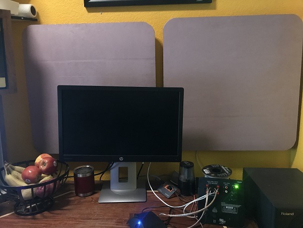

system 1.1 is the above, but swap out the boxes for the DAEX32 EP4 foam boards.
Tight space, but kind of out of the way. This is a quick and dirty hang job for now.
It took a few anxious minutes to get the sound right. I thought my little sub or the plate had an issue - no sound, but it turns out that the boards are substantially louder than the boxes and so the main volume wasn't high enough for the sub to come through at the old, "low" level.
The slight advantage with the boxes was I had them positioned equi-distance from each ear. But, the foam boards with larger exciter win by a lot. I only have 40w total power, and near full blast with a good orchestra and standing 6 feet back it's epic. And the boards fill the room unlike the boxes. I go to the door and it still sounds great. Even with the monitor obstructing.

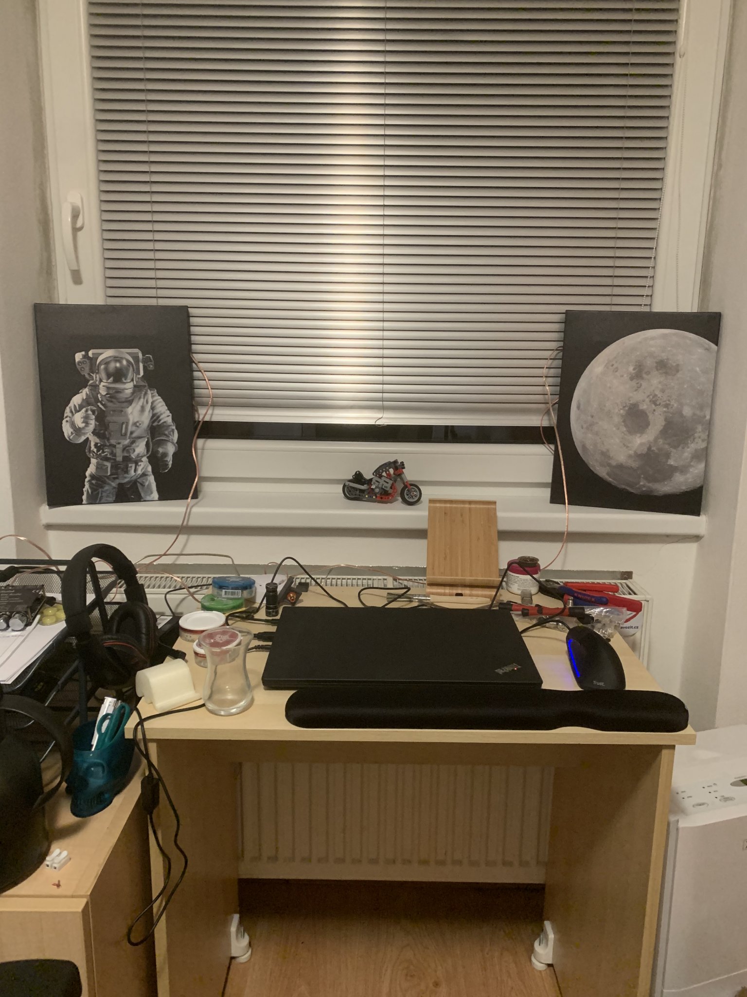

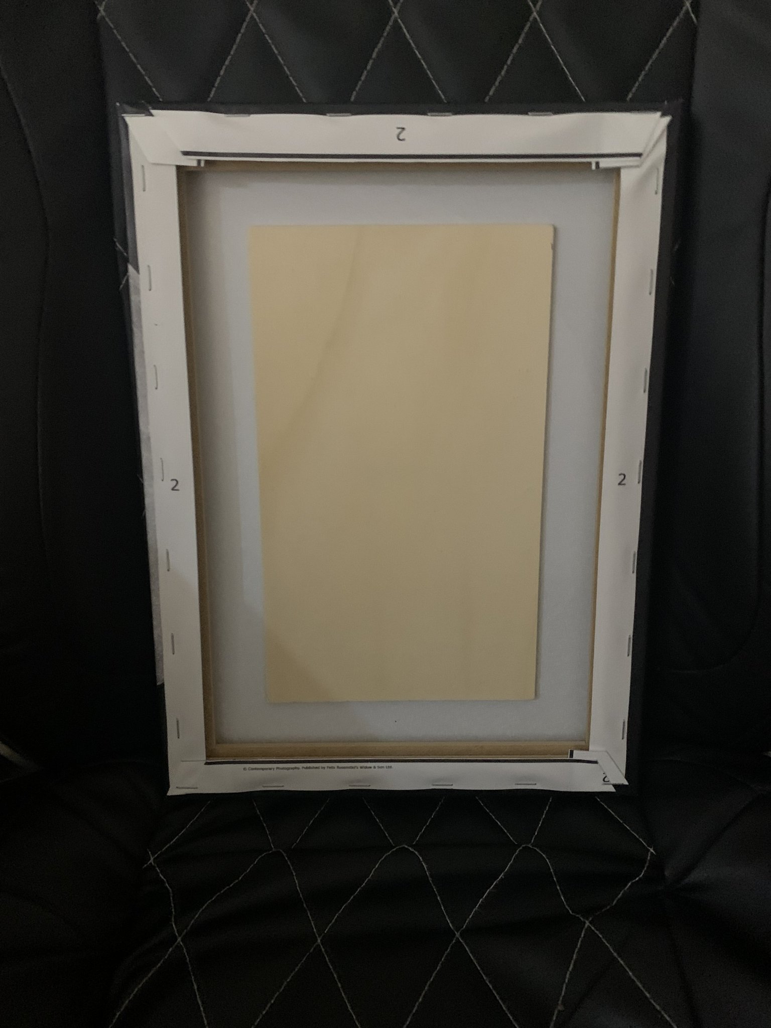

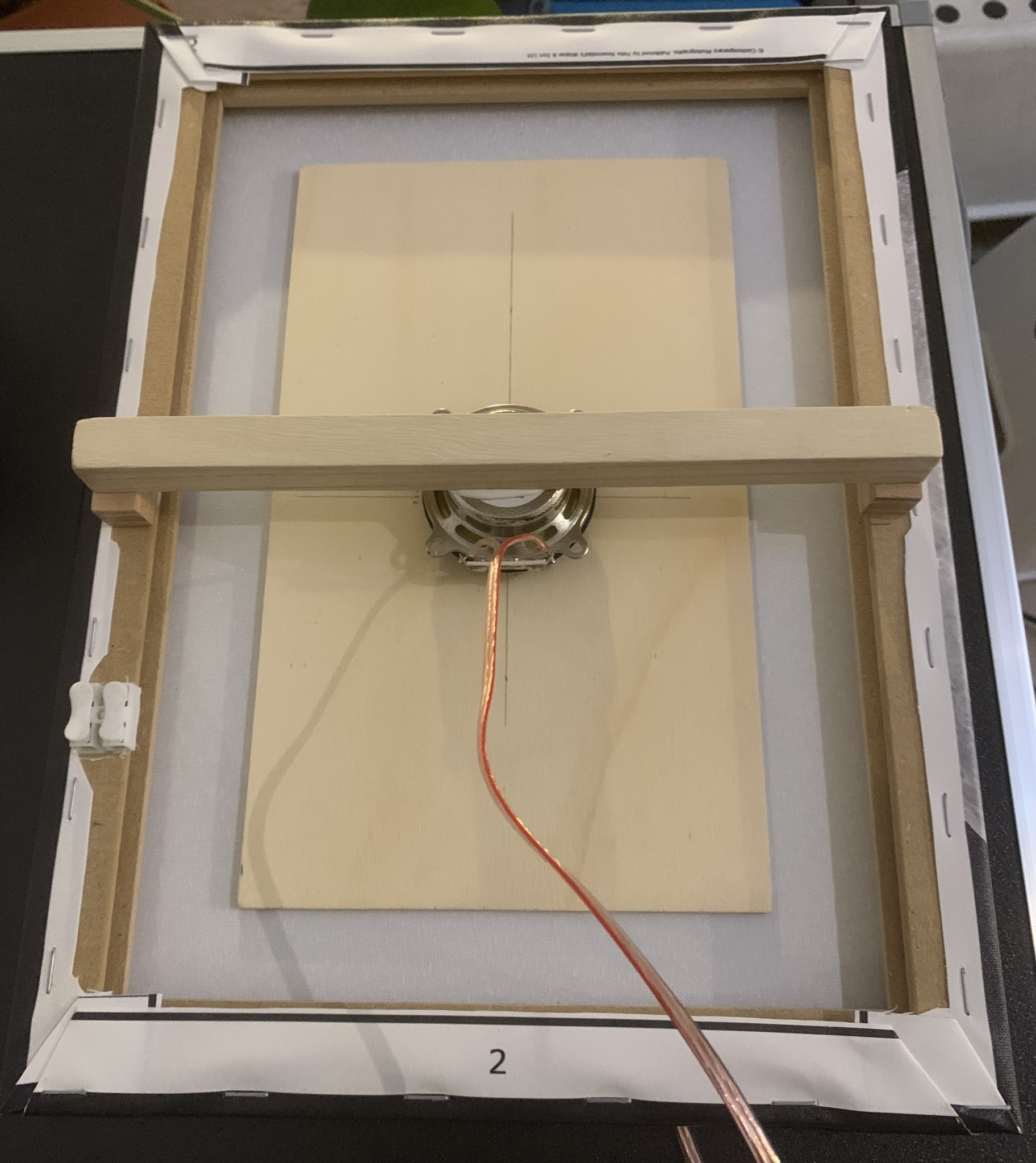

I can highly recommend these Ikea canvas based speakers. Just two pieces of 4 mm poplar plywood, some scrap wood for the spine and glue. Great sound for very little money. Perfect fot for the purpose of low level near field listening while working on the laptop.
I pop in there occasionally. This thread is the low-IQ version of that one.You might interested in this thread

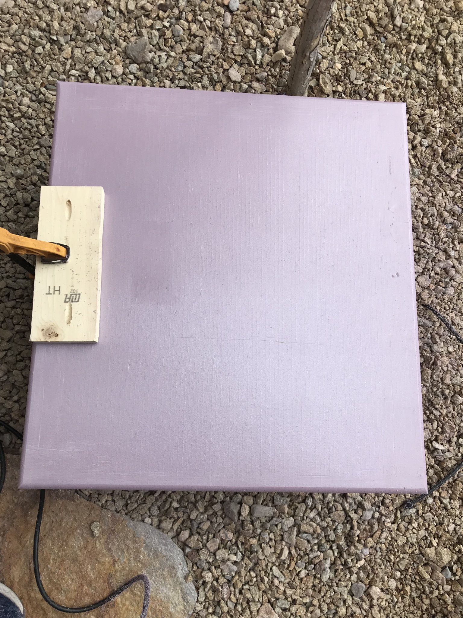

I created a spine for one of my 6$ Daytons, the same one as on the boxes in OP, glued a thin board to that, glued a 9 x 17 piece of cardboard to that, and then clamped down the spine. It sounded like an okay small speaker. disconnected it and connected one of the boxes above and it's not even close, the box destroys it. It sounded so good in comparison I had to do another listen test against the purple foam with the larger Dayton, and that showdown is much closer. The foam still wins overall. Guessing the small Dayton is just too small to get the mounting benefits. I could have done something wrong also, but it's hard to imagine I could have screwed up that dramatically. It sounds much like the experiments without the spine on smaller pieces of cardboard I did the first day, and again, with the little Daytons, it sound much better with the exciter facing you. I'll need to eventually try the spine with a larger exciter, don't have a spare one of those right now.
The spine is necessary for the canvas on frame construction. Or if the panel is held e.g. by foam tape in a frame. Clamping the spine to the same panel as the exciter is no good, since it reduces the energy transfer. When the panel is held on soft suspension, the spine makes sure the exciter is not moving and that the coil is not loaded by the weight of the exciter.
I tried only a larger canvas before, which was too large and loose - so it had problems with bass. The new ones are built to fit the window and the canvas on these is tighter. I plan to make larger foam panels with 4 exciters later - similar to these: https://www.diyaudio.com/community/threads/dml-pa-systems.390363/
The canvas works more like a speaker surround, if I understand things well, it is actually the plywood that is the key thing.
The foam panels should be louder/more efficient.
I like these a lot - very detailed sound, nice stereo effect on my work table. I wanted to measure them and apply some EQ, but it is not really necessary. Some EQ would be needed for compensating the position - they sound better when further from wall. For higher levels, a bass unit/ subwoofer would be needed.

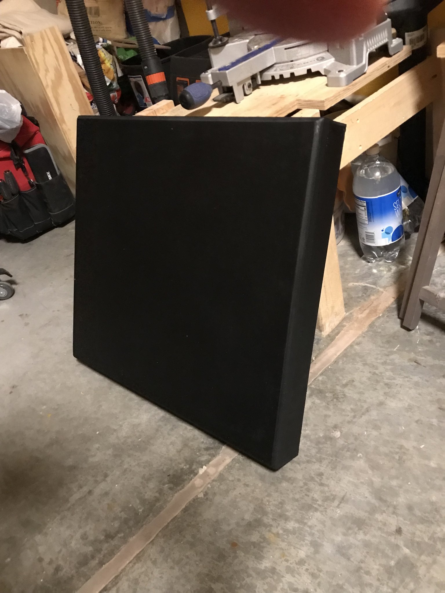

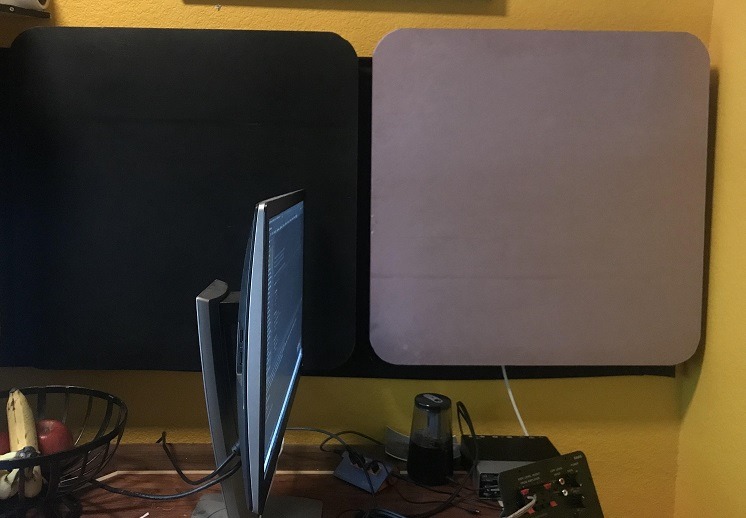

I'm slowly furthering the cause. The main blocker now is aesthetics. If you start with Home Depot boxes, and then move to foam, you might get compliments on how good the foam looks, but ultimately, the foam doesn't look good. Flat black or some other creative color would be better, and I'd prefer a different shape. But it's all about how much it will affect the sound. In the DML youtube videos I've watched, I've worried about paint because there seems to be a correlation between people painting their foam and then attaching tweeters. On the other hand, on some old Dayton-related threads, can't remember where they are, the Dayton guy says to treat the foam with a water / glue mix.
Anyway, I first tried covering with fabric. So I bought a yard of black fabric and did a trial cover of one speaker and I could hear enough of a difference
that I scrapped the idea -- maybe a different kind of fabric but I don't have any laying around so on to paint. I went with Liquitex craft spray paint from a Youtube recommendation, and they have it 2-day shipping on Amazon. Carbon black. I'm very impressed with the paint itself. I did several light coats with drying time in between. Probably could have used less, as sunlight is incredibly revealing. Attached a pic; I'd say it's one of those things tough to take a picture of and looks much better than in the picture. With a less beat-up foam board and some reshaping, aesthetics problem solved. But sound?
I listened to various clips over and over, connecting each to the same channel and it's a tough call. With a classical guitar, there is fret noise and nuance that comes through on the unpainted panel. It's brighter and airy. But the painted panel isn't dull, I definitely don't feel I need a tweeter for it. There's a tradeoff -- the painted panel sounds tamed. If the piece has reverb, crescendos get harsh with these speakers and replaying one of those spots over and over is definitely better on the painted. Prior to painting, I put a couple layers of thin insulation in the fabric I bought and pinned it to the wall behind the DMLs, hoping to ease the harshness -- I didn't do before and after tests as that's not easy to switch out. I think the paint is probably achieving what I was hoping with the fabric behind it. So the final evaluation for now is that without paint, there are passages that sound crisp and airy, adding a spark of magic the painted are missing, but other passages, with multiple instruments and things getting going, the unpainted can sound like it's in a bathroom compared to the painted, which sounds more controlled.

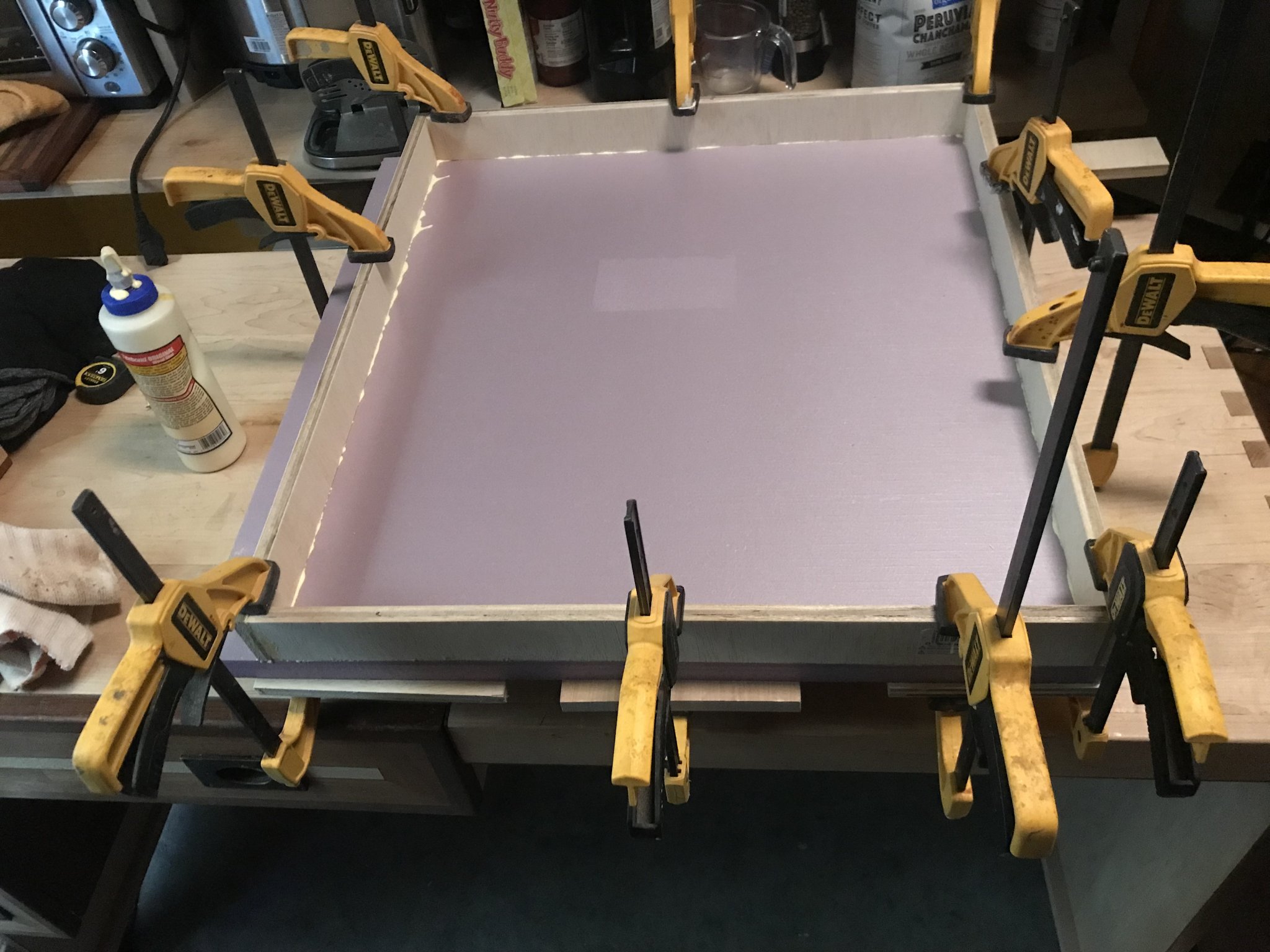

Yeah. I've tried a variety of tweaks since I posted last time, and the one thing that makes a huge difference is a frame. For bass. It's night and day. That got me motivated because with a frame the options for mounting these are so much better. Today was a huge effort to make progress and I got all 4 panels mounted to frames. I'm just gluing them with wood glue. I will have to trim because of space so 4 22" x 24" xps panels with the Dayton thrusters.
I assume it's due to construction demand, but Home Depot 1/2" sanded plywood while way more expensive than it used to be, is cheaper than the junk stuff. So it was cheaper than I expected.

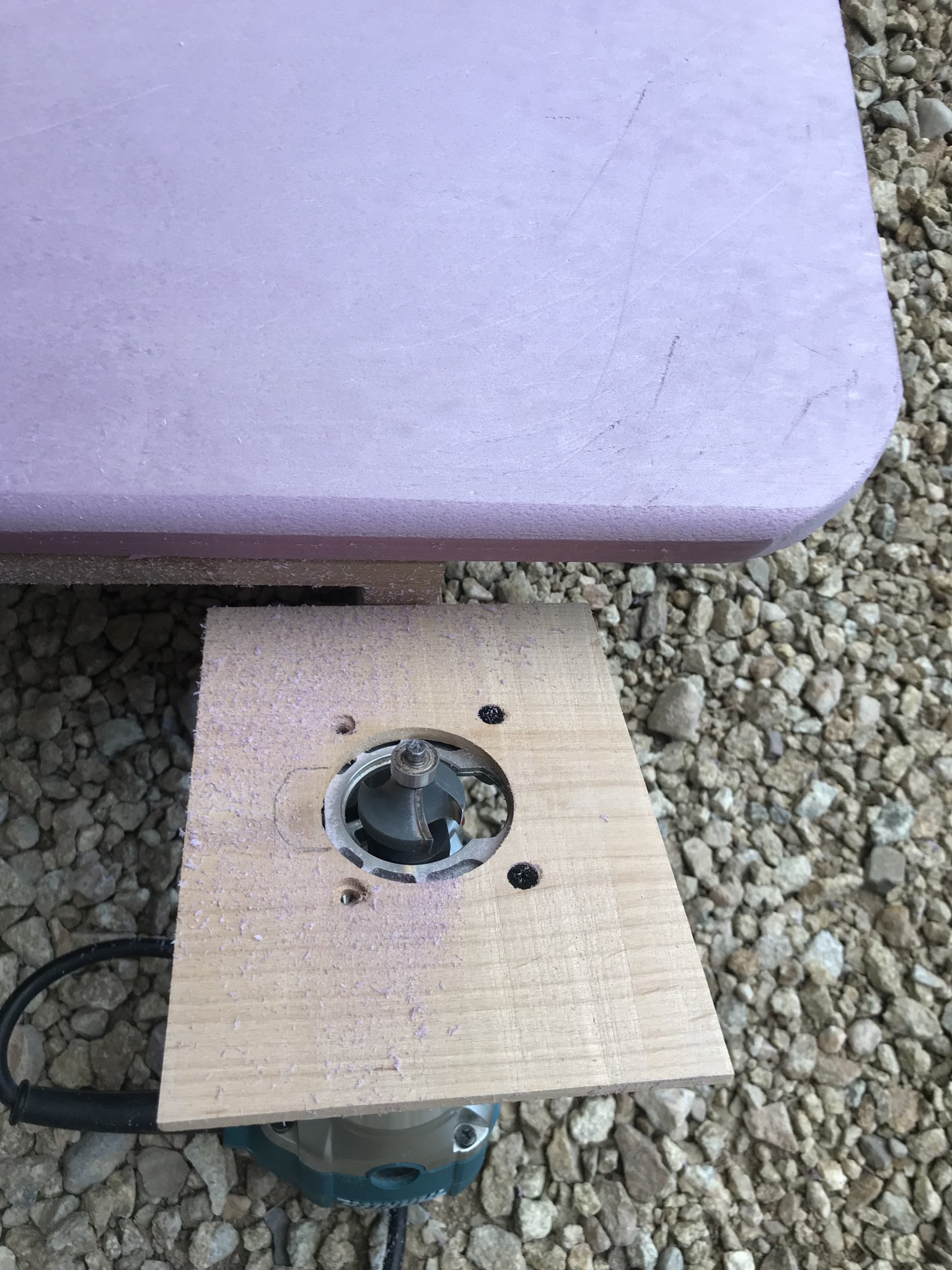

Got a little bit done this morning. I cut the excess foam off on the table saw. cuts really nicely but I will say be prepared for the worst dust you've ever seen, worse than MDF. The part I've had a mental block on is rounding the edges. My go-to router canister broke, and my little Makita's template is too small for the 1/2" roundover. I bought a new bit and the size was mis-advertised. I sighed, and detached my 1/2" router from the table, I've never actually used it by hand it and it's too massive for the spongy xps; can't control it. So made a custom template for the little Makita that's big enough for the bit, plus it's much larger than the stock template for better control, because this stuff is so bouncy. It ended up working great. I should have smoothed the template though as it scratched the xps surface a little but I just have so little patience sometimes.
It's worth mentioning all of this just because I think people ought to consider routing their DML edges. I don't like making bailing-wire-and-tape recommendations when it comes to power tools for safety reasons, but in this case I never felt the cutting was the least bit unsafe, it's just really easy to damage. Anyway, a light router with a large template seems to be the solution. I highly recommend having some sacrificial foam to practice with.
