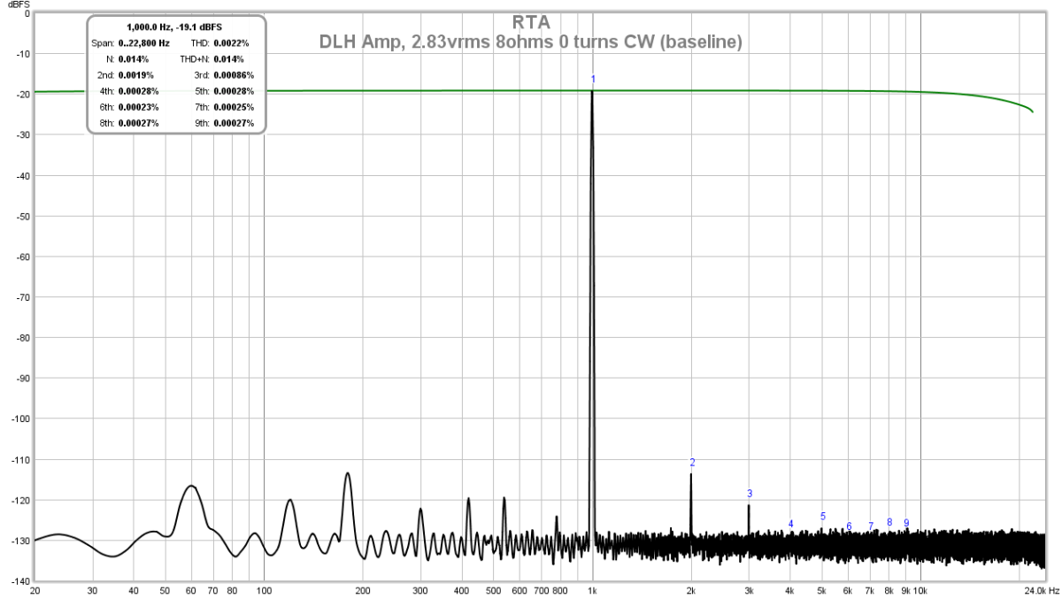

The profile of this distortion is superb, otherwise described as harmonics. It would sound wonderful....

No imd dim tim are shown so you like it fine but the underlying does are not shown, this is absurd.
No clipping point there are just not enough information audio specification were made for a reason.
Utterly absurd.
Utterly absurd.
Missing info? These are baseline FFTs at 2.83vrms into 8ohms load at 1kHz. The de facto standard for amp distortion profile measurements
Great result but expected for class a 1W at 8 oms. Does the harmonic structure changes with lower loads and higher power?
I did not try lower inpedances but sims by OP shows it works well. At higher output power same profile but THD increases a little and near clipping some higher orders appear H2//H3/H4/H5 but all monotonously decreasing and nothing above H5. I did not record any of these higher power tests so this is from my recollection.

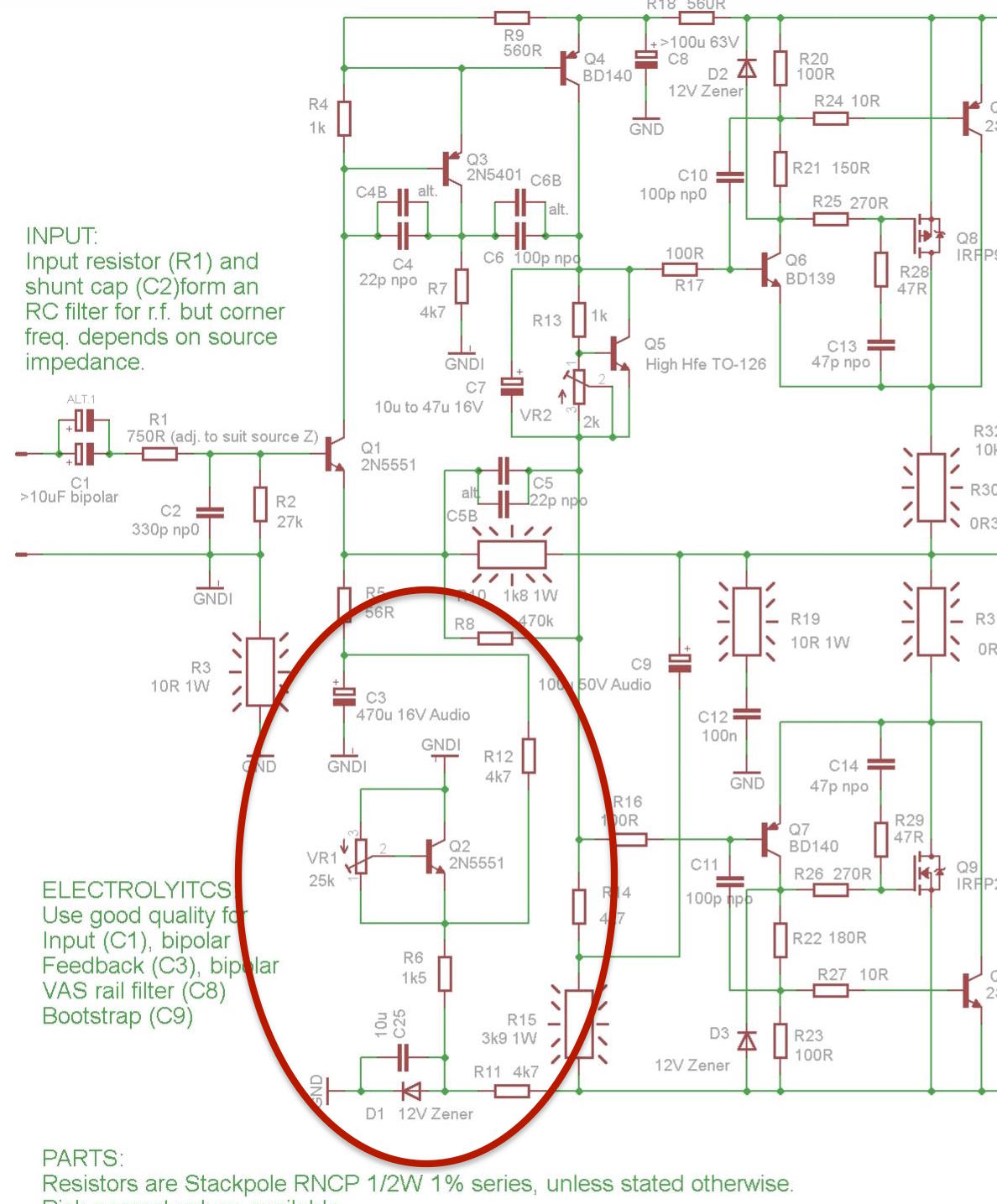

I completely agree with you that pairing 4 pairs of mosfets is not an easy task. I'm not too attracted to designs whose output circuits are made up of several pairs of transistors. I have always tried to design circuits of relatively low power (for small listening environments).

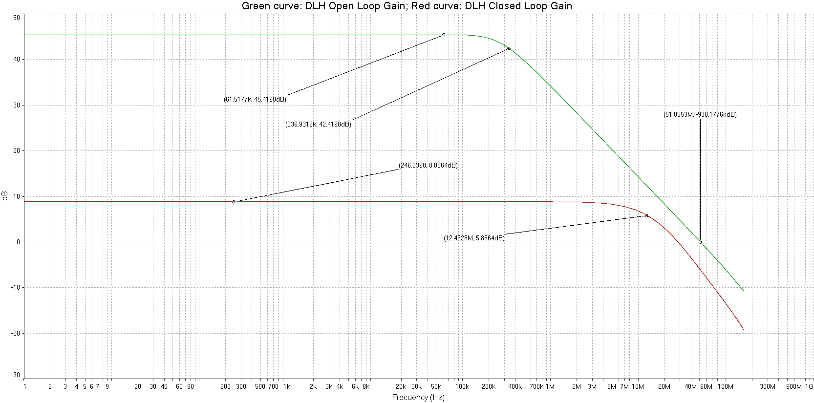

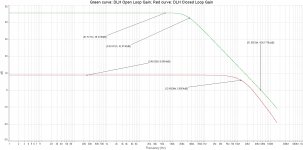

The small original DLH (with a single pair of mosfets) has a huge virtue to exploit that is its own wide open-loop bandwidth (almost impossible to achieve with other well-known configurations, such as the classic 3-stage: LTP , VAS and EF). This allows to maintain very high resolutions up to very high frequency, without noticing too much the classic break in the distortion around 1 KHz.
The rare input circuit must maintain a delicate balance: on the one hand, avoid excessive self-heating of the two transistors that make up the input circuit; on the other hand, the current through the two transistors of the input circuit must be maintained in the plateau of the curve that describes the hFE with the collector current (to preserve the linearity); on the other hand, a certain slew rate must be reached, so that the current through the input circuit has a minimum value (value that also bears relation to the chosen type of mosfet and its interelectrodic capacities).
While it is tempting to use a single powerful output pair, my biggest fear with the IXYS are just their huge parasitic capacitors between their electrodes (ranging from 10nF to 23nF, approx.). Using 4 pairs of IRFP150N, the break in the OLG curve is significantly reduced in frequency by comparing it to the situation of a single pair of IRFP150N.
To mitigate the above, using higher power input transistors than the current signal transistors does not convince me, since they tend to be more limited in frequency and, in this way, I would be wasting the great possibility that the small DLH allows me.

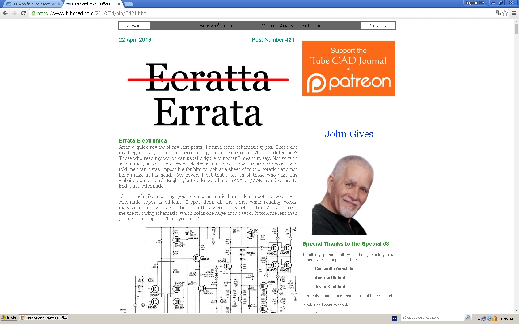

diegomj1973 have a look Errata and Power Buffers
Broskie is often reinventing things that others have done before, adding a little spice and a great dialogue to go with which makes his blog one of the best ever for audio. Broskie has published on some similar circuits a few years back. Hugh Dean published a Rush Cascode + BJT output buffer a few years before that, buried somewhere in somebody else's thread. Nothing new under the sun is what I learned after I reinvented all sorts of stuff shortly after starting into this hobby myself 😛
To my eyes diegomji1973's amplifier design is one of the more interesting variations and I really like the adjustability of the harmonic profile - not just a great learning tool but allow the amplifier to be more flexible in use.
It is not true. The classic 3-stage: LTP , VAS and EF (Blameless topology acording Douglash Self) is easy to have wide open-loop bandwidth using two pole compensation (TPC) or transitional miller compensation (TMC) or the other variations of two pole compensation, like which Dadod's discover.
Other topology such symmetry LTP input can use two pole compensation, too.
Have you seen the date on which the blog was published?
I find that curiously striking ...
A lot of water has passed under the bridge since the DLH was presented ...
I do not discredit his blog, but he presents many of his schemes based on familiar circuits. I do not see anything new or innovative and, frankly, I do not think that many of their schemes have been physically implemented or tested. From a drawing of a circuital scheme to reality there is a long way and, many times, reality is very raw and daunting for every designer ...
It would be interesting to show us if with similar complexity of scheme you would reach or exceed that parameter. You would need, at least, one more active element and a handful of passive components (crossing your fingers where nothing oscillates 😉)

The Achilles heel of your design is the limited output swing (and the practical consequences of it).
Offtopic, I was able to squeeze 11Vp-p output at 12V supply into 6 Ohm (resistive load so no real bragging rights here...) with a modified JLH69 topology (am not publishing it) built with pedestrian euro components (BC/BD transistors etc) at cca 400mA bias. IOW; "almost" R2R ...
The DLH does not have an Achilles heel ... it has a lot of them 😀😀😀 !!!
To mention just one of the many 😡😡😡: the shift of the DC offset with the temperature and its way of trying to correct it. Although for this defect there would be others possibles solutions: capacitive coupling to the speaker using a simple polarity power supply or running two units in bridge mode with direct output coupling.

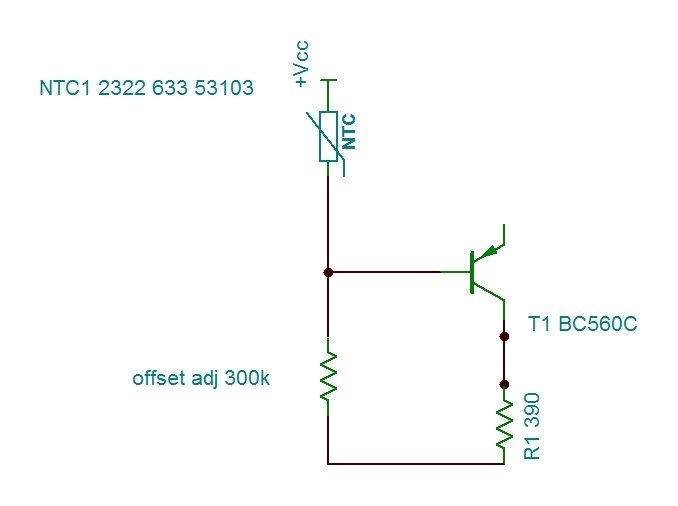

offset drift remedy
Bias the input transistor with current rather than voltage . It needs to decrease as it heats up due to rise of beta and decrease of mosfet's bias voltage. The ntc mounted on the heat sink can do it . If the input transistor has a heat sink hence less beta increase it gives less variation .
Thank you very much kokoriantz for your contribution! Any compensation attempt should counteract the voltage variation of the base-emitter junctions of the two bipolar transistors. The idea is that as the two joints heat up, the polarization potential of the base of the BC550C becomes less negative.

for me, because I could never accept the thinking of controlling current into base (as it relies on non-linear and rather inconsistent Hfe) I design with voltages and in all cases I can remember it's not difficult to insert a diode (or few) somewhere in the base circuit and put the diode and transistor into thermal contact. You can model it in LTSPice too, varying the temperature and watch to ensure temperature coefficient of idle current is negative and temperature coefficient of dc offset is relatively small.
for this amplifier you'll likely need more than 1 diode to match the temp.co for the dc-offset. In my TGM8 amplifier I used a single transistor wired up as a Vbe multiplier. It worked well although it takes more parts and you may prefer to keep it simple with a string of diodes type of approach. For my design, I fancied it up with a zener diode to create a steady fixed voltage off the negative rail so I didn't have to care too much about the rail voltage - you likely don't need that refinement. The Vbe multiplier is Q2 in the attached diagram and VR1 adjusts for the dc-offset (you'll need multi-turn or else split it into a variable + fixed resistors in series for more control).
There's many ways to skin this cat and you may find a different way that fits to the aesthetic you want.
Thank you very much Bigun for your contribution !!! I agree with you.
The DLH with the compensation implemented with two bipolar transistors similar to those of the input circuit works very well and under very similar concept to which you have kindly exposed. In fact, that compensation was successfully tested by xrk971 and, probably, by others. In simulation, that compensation has also behaved well.
