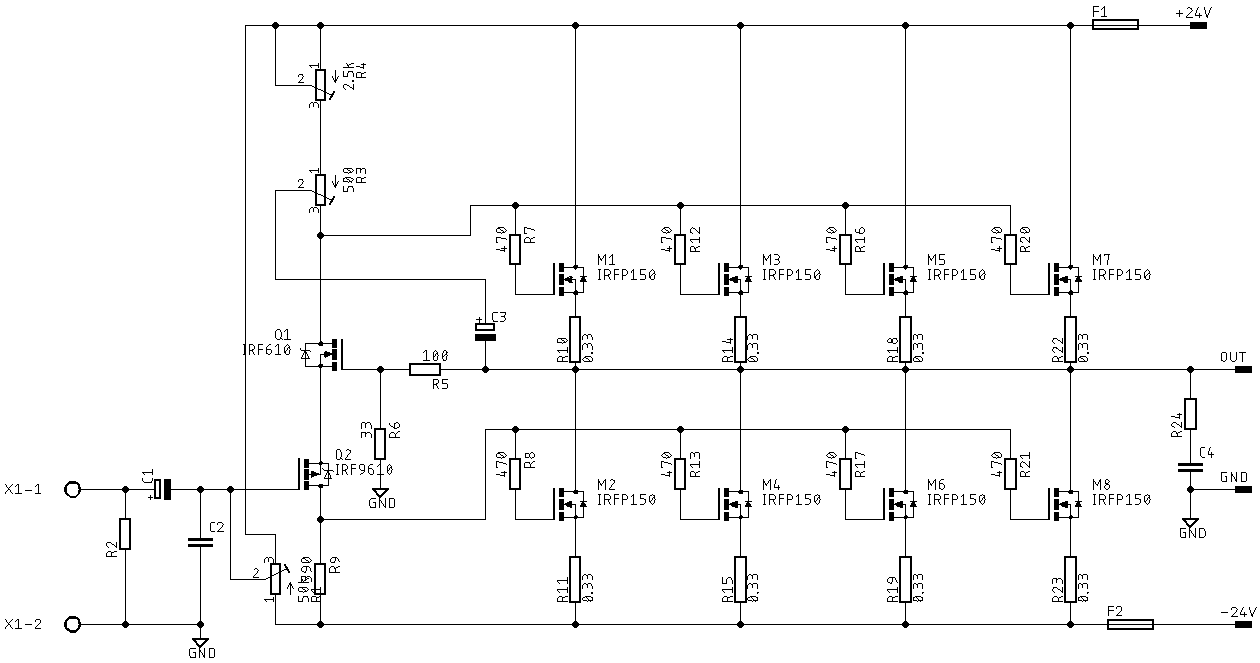

I will ask the question's:
1. Is the DLH High Power Amplifier to act like a teaser?
2.Marc, have you built / tested this DLH HPA, and if so, any details?
3.Finally, if tested and all is good, is Prasi willing to generate a pcb, and share like before? or,
4. Is it possible that the extra OS's be added P2P to an existing DLH pcb.
Myles

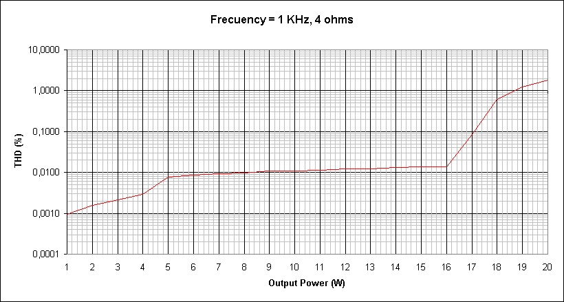

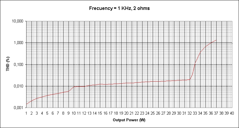

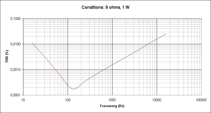

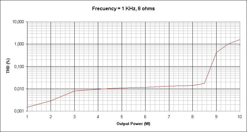

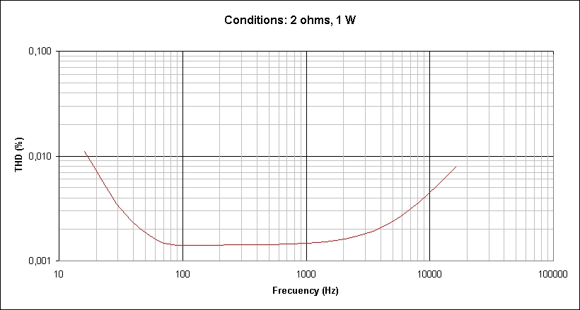

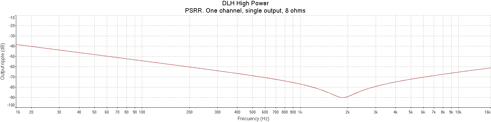

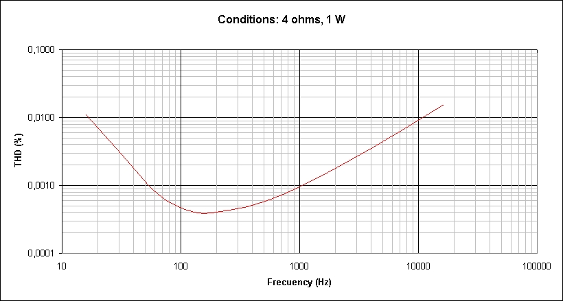

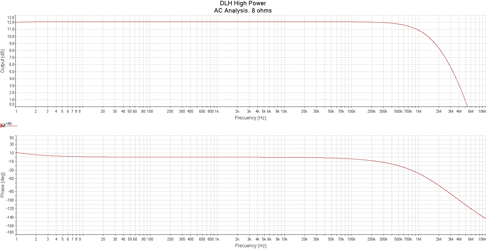

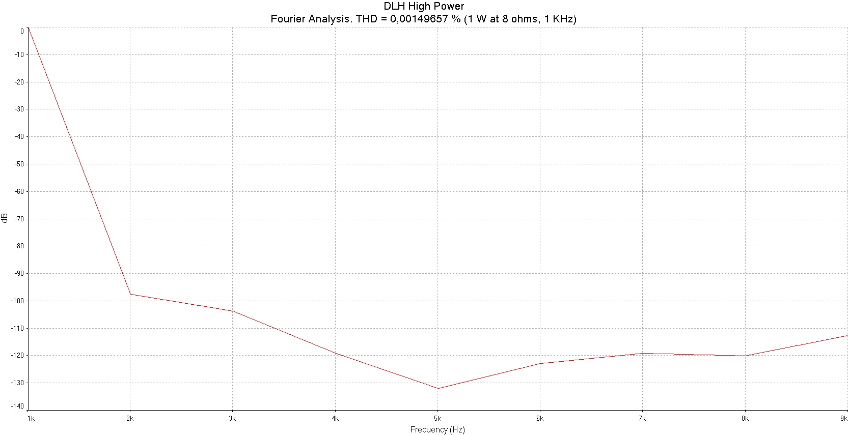

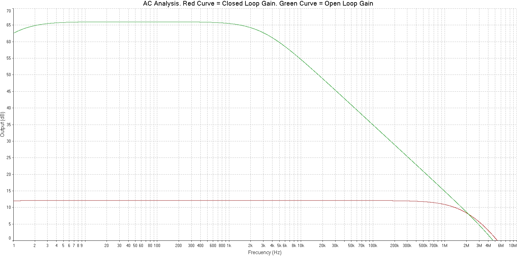

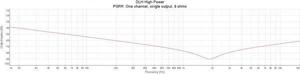

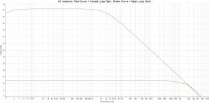

I have not built it yet.
I can assure that it will work without problems, mainly if it is operated in bridge mode, where offset displacements due to the action of temperature will no longer be a problem. The PSRR in this mode of operation will be impressive.
I tried to replicate the input circuit of the original DLH (that is, with BJTs), but when I added several pairs of mosfets to the output, it severely worsened the quality in relation to the original DLH. In that configuration, I did not find ways to improve the quality to acceptable values.
That is why I found acceptable quality values also using mosfets in the input circuit. This has a price to pay: lower excursion of the signal towards negative values of rail (between 6 to 12 volts of reduction of amplitude of a Vee of 24 volts).
When I can, I upload simulations.
Best regards
Horacio

Just use 120mm silent fan CPU heatnpipe coolers. 120w per mosfet can be handled no problem. On Alpha BB the mosfet body temps don’t exceed 38C at 10% fan speed. This is dissipating 200w per channel and it’s very effective (and inexpensive compared to a passive Rad).
Also, instead of matching IRFPs just use a big IXYS TO264 designed to dissipate 600w each and can handle up to 80amps.

Hello Horacio,
Could something like this work?
regards
Prasi

I would like to implement the idea of xrk971: that is, replace the IRFP pairs with a single pair of IXYS giants.
I really liked the speed with which my friend prasi has presented that beautiful PCB.
Who will be the first to build this beautiful big beast ?.
Best regards
Horacio

Very nice Prasi - beautiful work.
If one simply leaves the 3 extra MOSFETs unpopulated, put IXYS on single pair with heatpipes could work too. Board would be much smaller. Probably 100mm square even.

All the simulations were carried out for the same position of the 2K5 trimpot, that is, 66% of its total displacement (considering a trimpot of linear variation). It could happen that at other adjustment positions, according to the output load, the profile of the distortion takes on both an appearance and a different value.
Best regards
Horacio,
Prasi has done a beautiful pcb, I agree, he is quick too and considers all the electrical issues very well....... we are lucky at DIYaudio, aren't we?
The problem with multiple pairs is matching. Difficult to match four pairs; you would need at least 50 to select from, and you would have to measure them quickly to avoid thermal warmup, which hugely changes Vgs at the selected quiescent. A big pair of monsters is always better and there are some very good ones, like the IXYS 1040W devices. Here are 18 IXYS devices, Pmos and Nmos, with 90-140A and 960W to 1060W. All are suitable for your DLH, although you might want to reconsider the gate drive requirements carefully. These are designed for tractive/propulsive/smps application, I believe; but they move pretty quickly if you can move the charge into and out of the gate swiftly. These devices have outrageous transconductance, which is pretty good in linear operation as it reduces the compressive distortions.

xrk971, did you ask yourself the question, why PA amplifiers don't use overclocker's heat sink? Ok ,you are replacing the air filters time to time ,changing the fans every 3or 4 years (yearly on sea cost) . But the layer of grease, accumulated on the foils by kitchen vapor and air pollution, how do you clean it up ? At the gas station?

In fact, PA amps use tunnel heatsinks and large fans and air filters much like a rack mounted sever PC. Have you seen the inside of a Pro Class AB?
Here is Behringer EP4000:
And Mackie EM4000:
They don’t use cpu heatpipes because they spread the load over many MOSFETs. But a CPU cooler would be no different than cleaning a PC case once a year assuming you leave it on all the time. Which we don’t. Class AB amps that draw 400w are o Lt turned on a few hours at a one during listening sessions to save electricity.
After 50 pages of the thread, you are making plans for pcb but there is no working proto? The circuit is very simple for point to point prototype.
