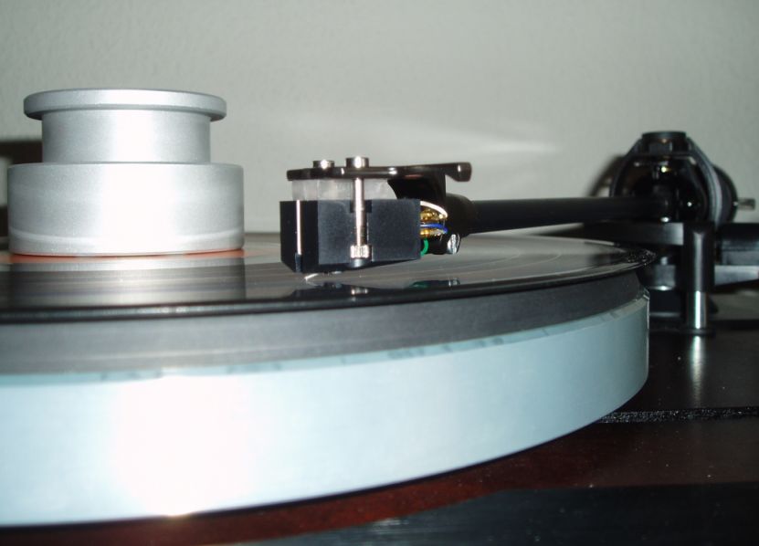

Ok,
finally I learned a lot about my tonearm, and I think I am more than half way trough. I think VTA is pretty good. I measured the resonance using test record and both vertical and horizontal are 10-11Hz, so quite nice. I am not sure about antiskating but more fun for future...
Here is the photo of the tonearm now.

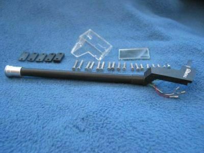

spacer closeup
Here is the spacer closeup. It aint pretty but it works 🙂
I am still looking for original ones, this on is around 3.5mm.

Nice Pred 🙂
The spacers were originally supplied with the turntable itself. Replacements are available on the internet somewhere but at unreasonable high prices. Best is to make your own from a piece of acrylic (Plexiglas) or balsawood.
One thing about the screw under the plastic top cap. Be careful with that, it holds the upper ball bearing of the horizontal bearing. If you loosen that you also introduce play in the bearing. It should be adjusted for minimal play without locking the arm bearing..
Cheers 😉
hello pjotr
Yes,
I mad mine out of acrylic, but would like to have original ones. Maybe I'll send some questions to thorens. I found that out. Never was able to adjust that screw and then I took it out completely and then figured what is happening. So I centered the arm screwed the thing and now no play and the arm is (without wight) moving when you ligthly blow to the arm.

Does VTA looks good to you?
Re: hello pjotr
pred said:
<snip>
PS
Does VTA looks good to you? [/B]
I cannot say that from a distance. You have to judge that yourself by listening, provided other things are right also, e.g. right down force as specified for the cartridge.
I don’t see why you want the original spacers. It are just small pieces of PVC plastic. Maybe you can contact Rolf Kelch for that. He was the chief engineer of the old Thorens and now started his own company.
http://www.rolf-kelch.de/
Cheers 😉
