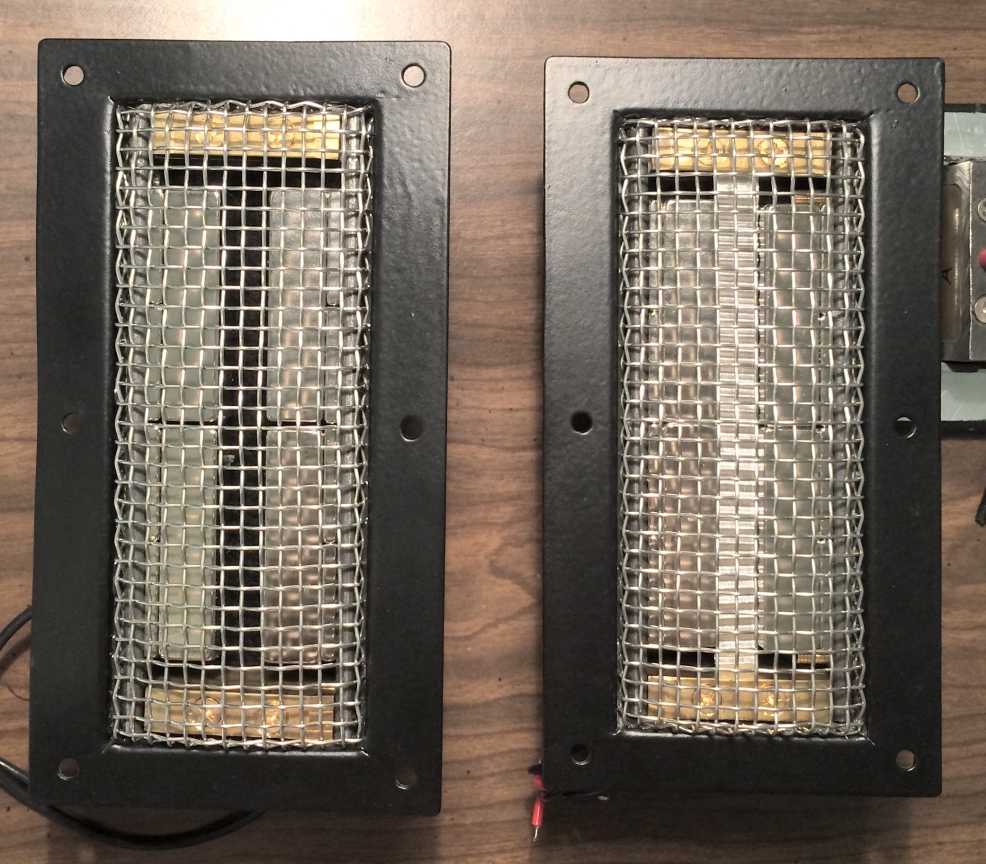

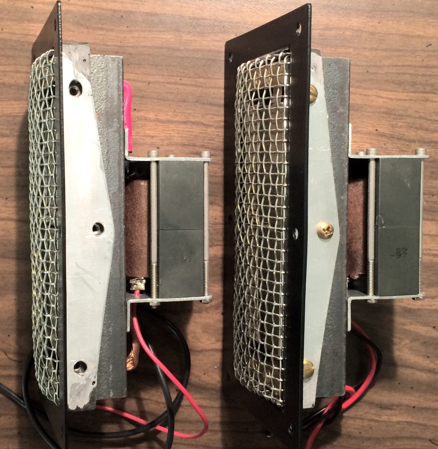

Finished 4 Inch Ribbon Tweeters
I already finished these 4 inch ribbon tweeters. They are very efficient compared to other tweeters I have or have had. N52 Neo magnets and very efficient RF type matching transformer 18 to 1 It is basically primary inside of a copper tube. Idea is used for wideband high power RF amplifiers and works very well for this also. I have many photo's of one being made. Not an easy project.
