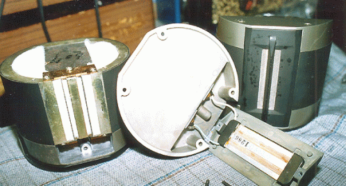

On a website about ribbon mics the author said that aluminum leaf is the perfect thing for replacement. It's possible that tweeters need to be tougher than mics.....
I've seen the site and, based on reading it, I bought some aluminum leaf. I can confirm that it is much too delicate to consider using as a driver element on its own. It is very difficult to even touch it without having it stick and tear. I bought it with the intention of trying it as the conductor on mylar.
I made some "proof of concept" ribbons with pleated kitchen foil suspended between two 1.5 x 3/4 x 3/8 magnets and with the ends wrapped around some wire and attached to a small wood bar which kept the magnets apart. They would move a great deal with DC and enough DC would stretch out the pleats but not break the ribbon. Resistance was not measurable and I drove them with a boombox I didn't care about and got a little sound, but this was preinternet (~14+ yrs ago) and I didn't find any workable transformers at a local surplus shop. I made some exponential horns for the fun of it out of tagboard and saw little improvement, and that was the end of my trial. If I had access to a shop and tools, I would have made a better gap to concentrate the field and use thinner foil to hopefully get a better sensitivity, and I would have looked for something to make a transformer out of..
I have thought about several ways of doing planars since then - tape and magnet wire, conductive pens on mylar, and a couple different gap geometries. Someday....

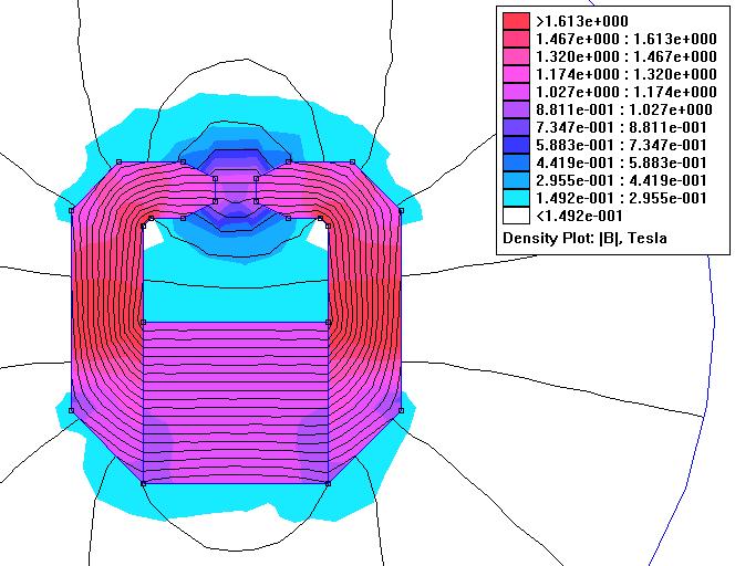

I just did a couple off-the-cuff sims to see what gap fields might be attainable and how return circuit materials related.
In this first sim, the magnet is a monsterous slug of 40 MGOe NdFeB 2 inches wide and 2.3 inches thick
. The return circuit is vanadium permendur--the most permeable material in my library.
As you can see, the resulting field across the half-inch gap is right around 1 Tesla at its mid-gap densest. This is why Pjotr described 1T as "damn good." 😀
Also notice that despite the use of permendure, which is not anywhere near saturation at any point in this circuit, stray flux lines are flying off everywhere. This is because the flux doesn't feel especially inspired to stay in even an ideal circuit if it's facing a large gap reluctance.

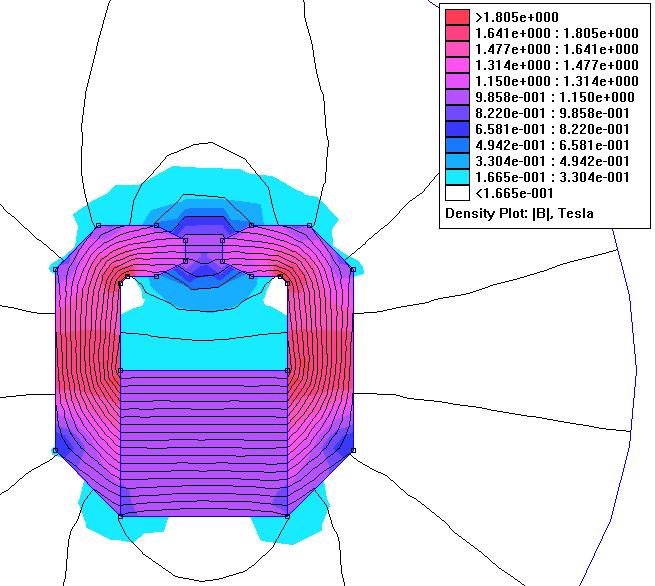

To look at the effect of materials, I left everything the same in this second sim, except the return circuit is now cheap 1020 steel.
As you can see, the gap field is still right around 1T. So, word to the wise: save a few bucks on your return circuit! 🙂

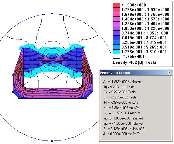

Mark, you have mail. 🙂
Ok, I'm up to challenge. 😉
In my continuing effort to deliver your money's worth, here's a low-leakage design--permendur again, just of giggles. External fields are mostly gone, but there's still internal leakage, and no more flux in the gap... 🙁 How do you propose to better turn leakage into gap flux?
