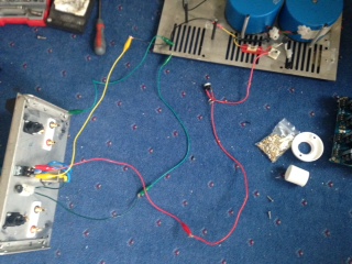

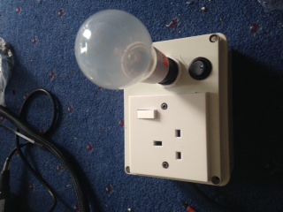

Tester built !
Hi Andrew, or Anyone else that can help ?
the tester is made with a 100w bulb. I'm still blowing fuses . I have a 3A fuse on the wall plug , 6.15A in the IEC and a 2A after 2x CL60 in series - the bulb connected to the secondaries …..
thank you ,Richard

A 100W bulb will not blow a 3A fuse even when the output of the bulb tester is shorted.
You have built the tester incorrectly.
The bulb tester goes in the Mains circuit with a mains plug top to plug into the wall outlet and a mains socket to supply the mains powered project.

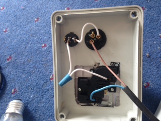

Can you confirm what I think I am seeing?
The Brn comes into the bulb holder from a plug top.
The wht comes out of the bulb holder and goes to a switch.
another wht comes out of the switch and couples (under the blue tape) to a further wht to the Live of the switched output socket.
Blue comes from the Neutral of the output socket and goes into the cable then to a plug top Neutral.
What is on the other end of that two core (Brn Blu) cable.
You don't need those two switches. It appears you have them correctly wired, so don't remove them.
You can check your wiring with a DMM set to ohms.
close both switches. Insert a bulb. Measure the resistance from Live on the input plug to Live inside the Output socket receptacle.
It should measure the same as the bulb cold resistance.
When you switch either switch with the bulb in place it should read open circuit.
When you remove the bulb it should read open circuit (with both switches closed).
I see an earthing terminal on the back of the bulb holder and this usually indicates a brass/metal bulb retention bayonet.
Is there exposed brass/metal around the bulb holder?
You need to be extra careful that a loose or broken wire cannot make the metal bayonet LIVE !!!!
If you have exposed metal, then I suggest you add a 3wire mains cable and "Earth" the bayonet metalwork.

There is a plug on the end of the Bl/BR …. And yes, there is a brass coupling on the bulb holder . I have AC …. but the bulb doesn't light up … I'm confused ?

A bulb tester supplying only a transformer often does not even flash.
Even with a rectifier it will not flash.
Its the prolonged current draw of the capacitors that heats the filament and we see the flash which can be bright or dim.
Have you got mains AC at the transformer with the bulb tester in place?
Have you checked the bulb tester's resistance when it NOT plugged in?
Resistance is 0.1 R …… measured from the + of 3 prong plug to + IEC plug .
I get bright continuous light from light bulb ? I turned it off and didn't measure the secondaries .
Definitely wired wrong.
The mains current enters the tester plug top goes THROUGH the bulb filament to the tester socket. If any switch is open or the bulb removed, the resistance MUST measure open circuit.
The Neutral from Tester Plug to Tester Socket should ALWAYS measure <<0r1

Remove all the white wires.
Wire Brn from Plug Top to Bulb Holder.
Wire Wht from Bulb holder to LIVE of socket.
Wire Blu from Plug Top to NEUTRAL of socket.
Only the switch in the socket and the bulb filament is in the LIVE half of the bulb tester.
There should be nothing in the Neutral from Plug top to socket.
Remeasure the resistances.
Report back.
Report back.
