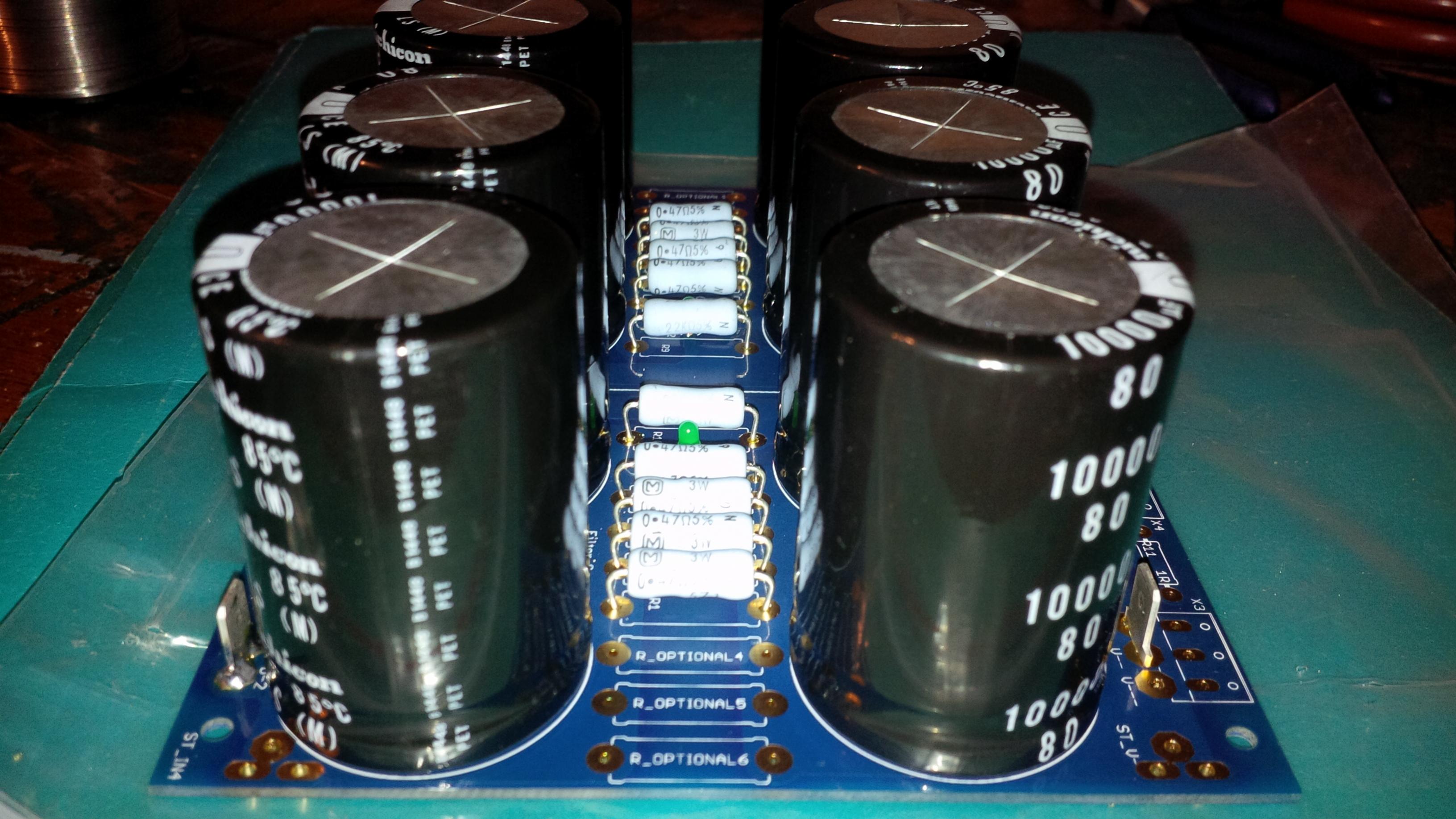

Another PSU lives! This one is for my Honey Badger, which is turning into a world record for time taken to build 😛 .

i am using this psu for F5. My R9 and R10 bleeder resistors are 22k but i saw someone using 2.2k. The BOM indicates 4.7k to 22k. Any problem here?
any need to install R11 and R12 output snubber resistors and output snubber capacitors (0.1nf) ?
I am using the IXYS diodes instead of the monolythic. I think there is no problem here.
For now i only have 8x10000uf/35v capacitors. Can i use them for testing and upgrade later?
This is for a simple F5.
thank you
i've read the last few pages and i am confused in the CL-60 department. I asked on another forum but i think here is more adequate.
So, my transformer is single primary 240v - 400va, and 2x18v secondary (toroidy). I have to install 2 CL-60 (or other? don't know) in series with hot or neutral. That was what andrewt said, i think. If that's right, what fuse do i have to use? and where the ceramic capacitor goes? what's his job?

Fuse rating is VA/Vac
for 400VA running on 230Vac you need a 1.7A or less.
Try a T2A or T1.6A
To prevent that fatiguing and eventually nuisance blowing after repeated cold starts you need to insert a current limiter in the primary circuit.
The 10R of a single CL60 with 230Vac driving current into the not yet started transformer is not doing a big heap of current limiting.
I would use 60r to 80r of resistance to limit the starting current to about 3 to 4A
I find that does not blow a T2A fuse.
You can try lower than 60r and see how long a T2A lasts. Maybe you'll get years of use.

That ceramic cap looks like its meant to stop arcing on the power switch and RF filtering. You have to use an x rated capacitor. I'm not sure whether x2 will be enough or if it has to be x1. I can't tell from the photo whether that's the case or if it's a standard ceramic cap.
Just checked mine. I have the soft start board and it's a 1uf x2 and it's about an inch wide.
The reason for x caps is in the position they're in, they take a battering.

If they fail they have to fail in a way where they dont catch fire , explode or cause a dangerous condition.
X are used across power lines
Y are used between power and ground. If this fails it has to not short out otherwise your chassis can become live. You can't use an x cap here.

I see your using a couple of cl60s in series. I would use a longer connector block and use an extra connector to hold where you've soldered the cl60s together so they're not floating loose.

You need to connect the PE wire direct and permanently to chassis. Soldering is not allowed: A permanent mechanical fixing.
Your Live feed goes straight into a mains fuse.
Then you can fit your other bits and pieces after the fuse.
Do not fit a suppressor across the switch. This leaks when the switch is off, leaving the internal circuits Live.
Fit the suppressor across the load as early in the wiring as possible.
Keep all the pairs of Flow and Return wires close coupled, or twisted, to minimise interference.
Insulate all bare mains wiring/terminals.
Consider adding double insulation to all your mains wiring and fixings/termination.

use a three terminal strip. the junction between the two Power NTCs going into one terminal to be mechanically secured. The NTC can run very hot. You don't want the solder becoming weak.
