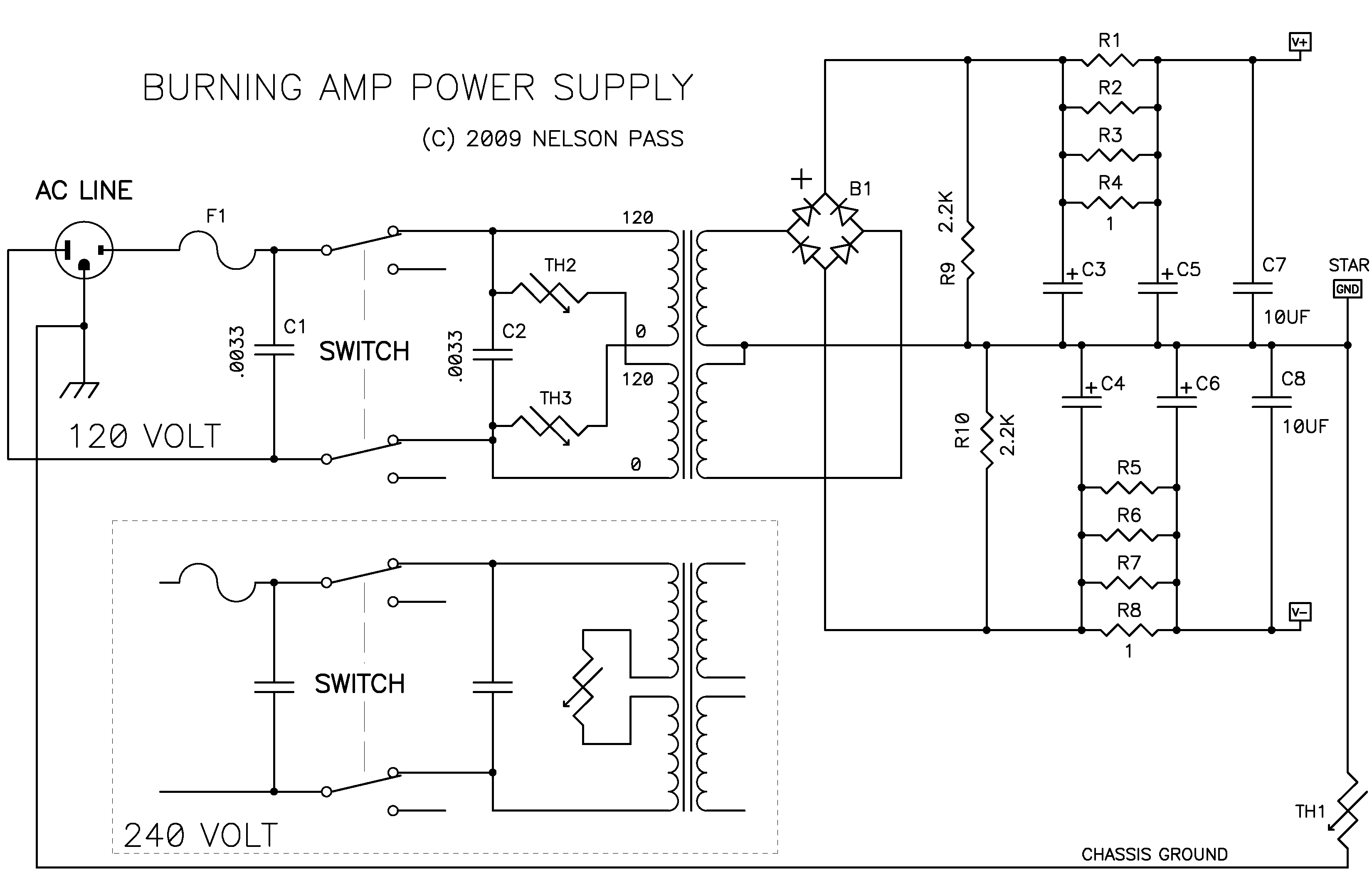

Yes. My initial question, better put, is "why use an NTC/thermistor for a ground lift?"They're used both as inrush current limiting devices and ground lifts. That may be the confusion
Oh, this applies to sooooo many things in life. "Why did they call it 'X' if it does almost nothing 'X'-like?" Such is life.The part name doesn't dictate its function
Because it can handle all the fault current, if needed. A resistor likely can't.
Also, the NTC will be a lower resistance in normal operation once everything is warmed up, where the resistor will be increasing it's resistance.
That said, your resistor ground lift will work nicely for testing, but I'd suggest changing it before declaring it completed.

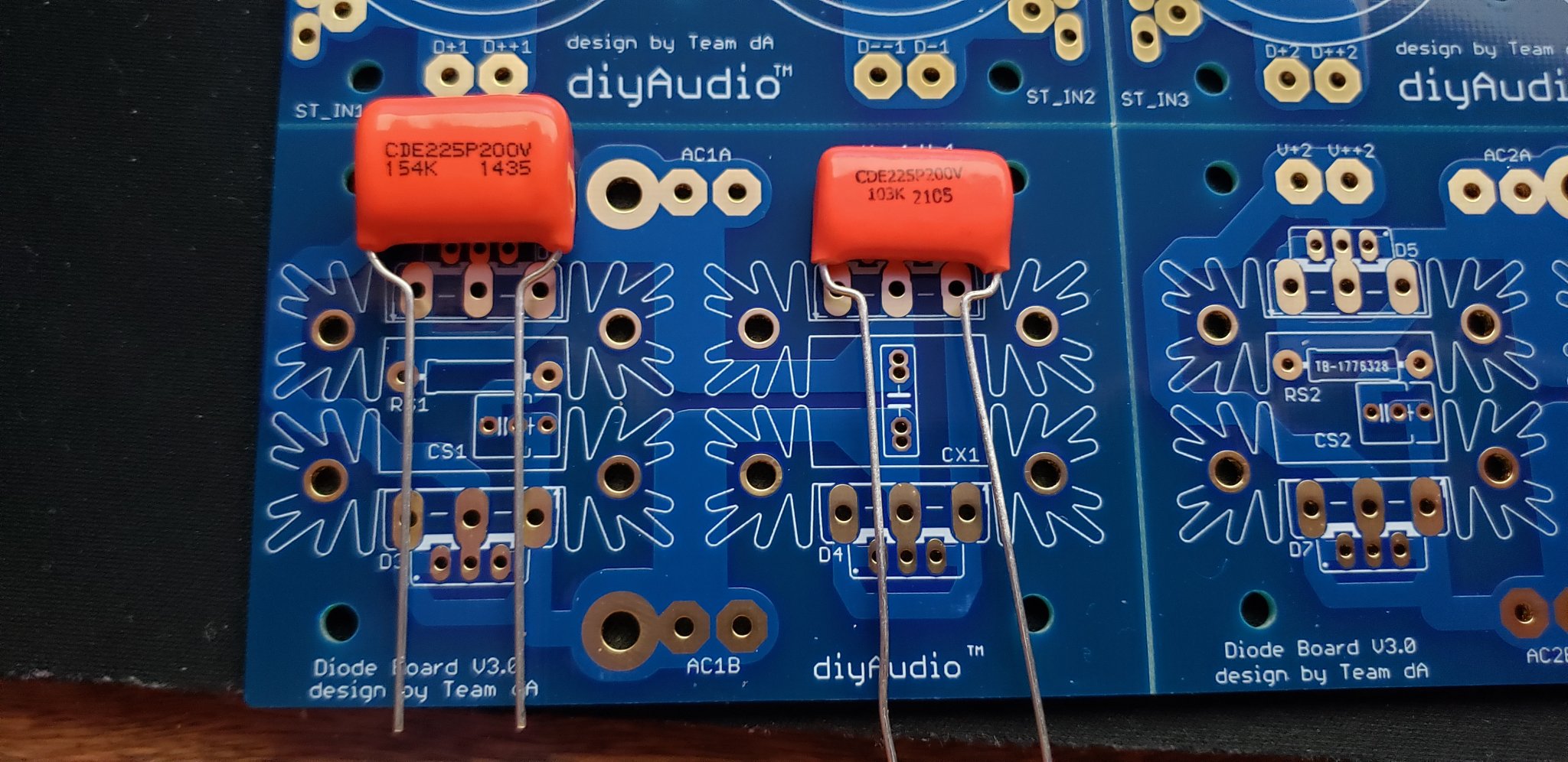

I may have goofed. these are the input snubbers i purchased.
I referenced the Quasimodo test thread for my Antec - 3218
CX- 0.01uf
CS- 0.15uf
both rated at 200v. can i use these if i can make them fit? if i can am i sacrificing anything? if i can not use them please let me know what i should have purchased. (Aleph J build)

You can use them. Depending on other components used, and if it's too tight a fit, you might mount them on the 'bottom' of the board.
If you choose not to use them and/or or feel strongly about mounting them on the 'top' of the board, you may like something like...

Great. I think i will try puzzling them into the top and if it becomes too much a challenge, under they go!You can use them. Depending on other components used, and if it's too tight a fit, you might mount them on the 'bottom' of the board.

The bottom has better accessability. You don't have to remove the heatsink/diode in the event that you want to change the value etc. It is already a tight fit to begin with.

I placed the capacitors underneath the board. That was good advice.

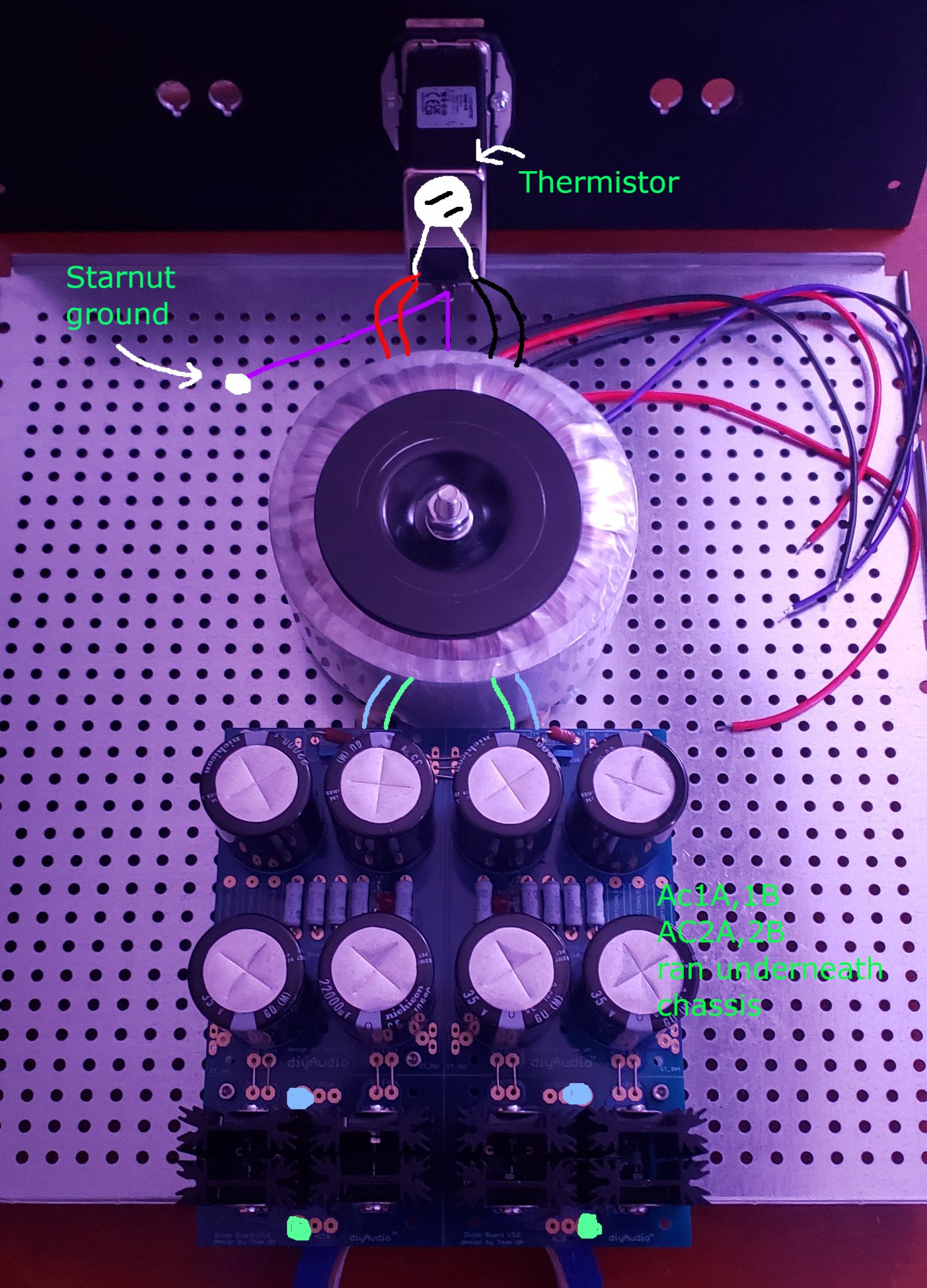

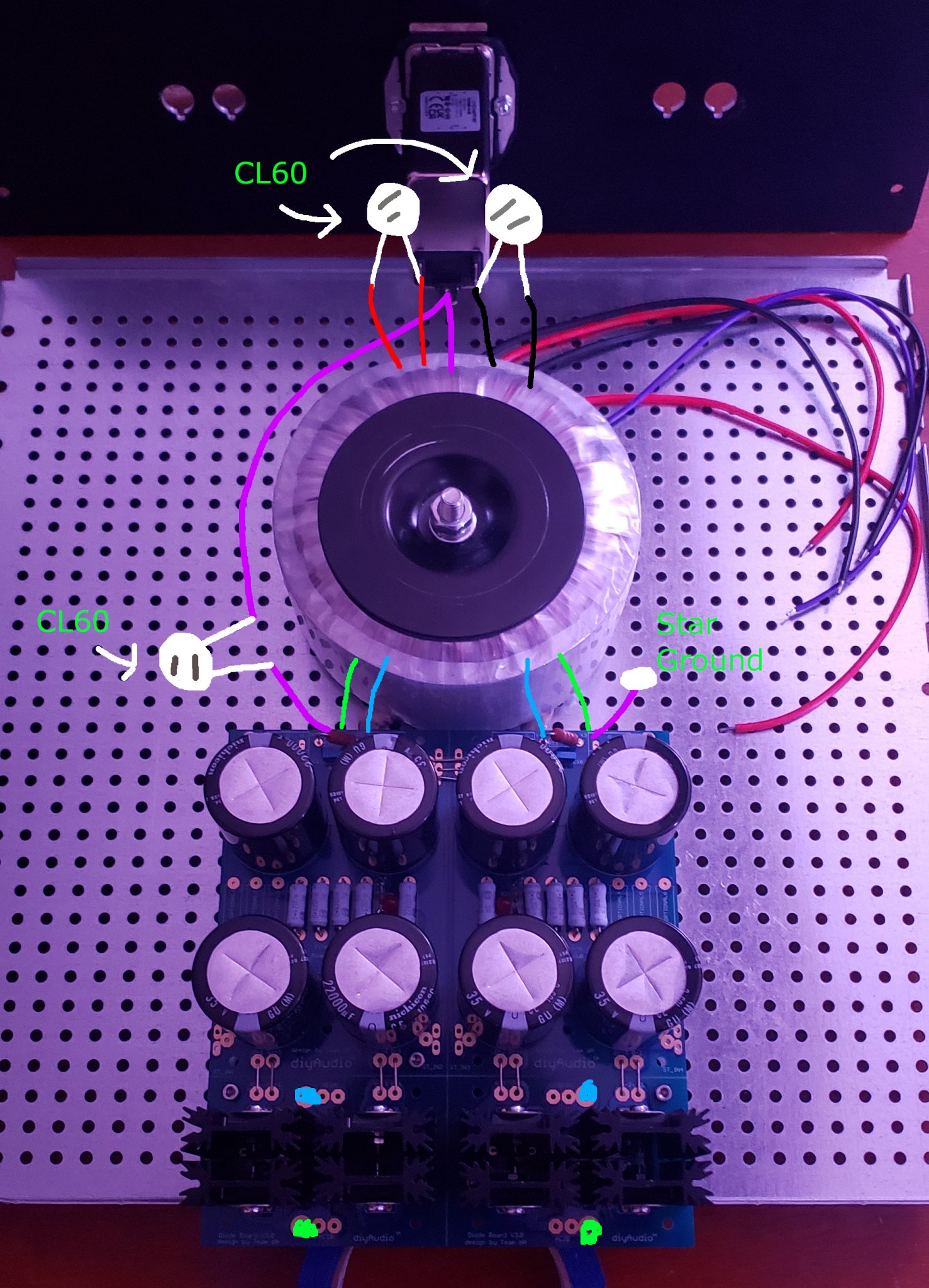

I am having trouble understanding what i need to do to properly ground the PS. I have seen other builds without terminal blocks while placing the thermistor directly onto the IEC. Will my 5A 10ohm thermistor work in this position?
In the picture the ground from the transformer (purple) goes to the ground on the IEC and from the IEC is connected via starnut to the chassis.
Do i need to run wire from this starnut to a ground on the PS or can i create another starnut ground near the PS with a short run of wire.
I have an extra 5A 10ohm thermistor, could/does this need to be used between the starnut ground and wire to the IEC like in the picture?

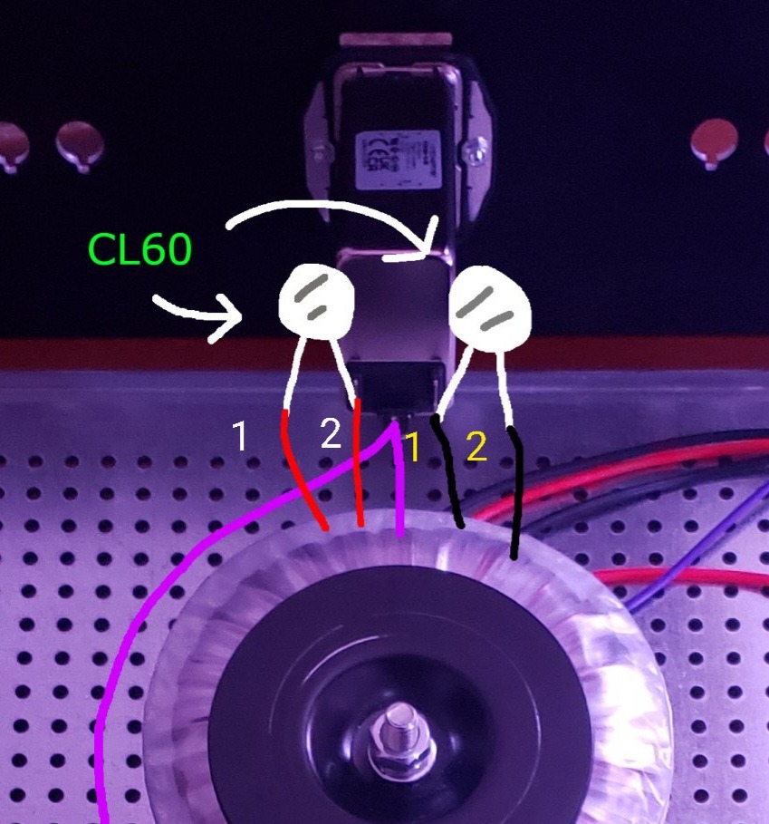

The thermistor as you sketched it doesn't seem to be correct (IF I got it right)—
You need one CL60 to connect the transformer to the IEC (from hot to one primary wire)
You need another CL60 as a ground-lift, through which you connect the Capacitor-bank to the star-ground...
The place where you put the CL60 is the place to put in a security-cap (to avoid sparks on turn-on/off)
(here's some brain-food 😉 https://www.diyaudio.com/archive/article-images/ba1/BA-1-PS.png )

I think i understand what i need to do. How does this look?
You said one CL60 connecting the transformer to the IEC, as in i would need a single CL60 between one positive wire and the IEC hot, while no CL60 on the negative side?

You’re almost there!
1 CL60 at IEC
PSU ground: only 1 wire, with CL60, goes to star-ground
(a second wire to starground—without CL60—would just short it…)

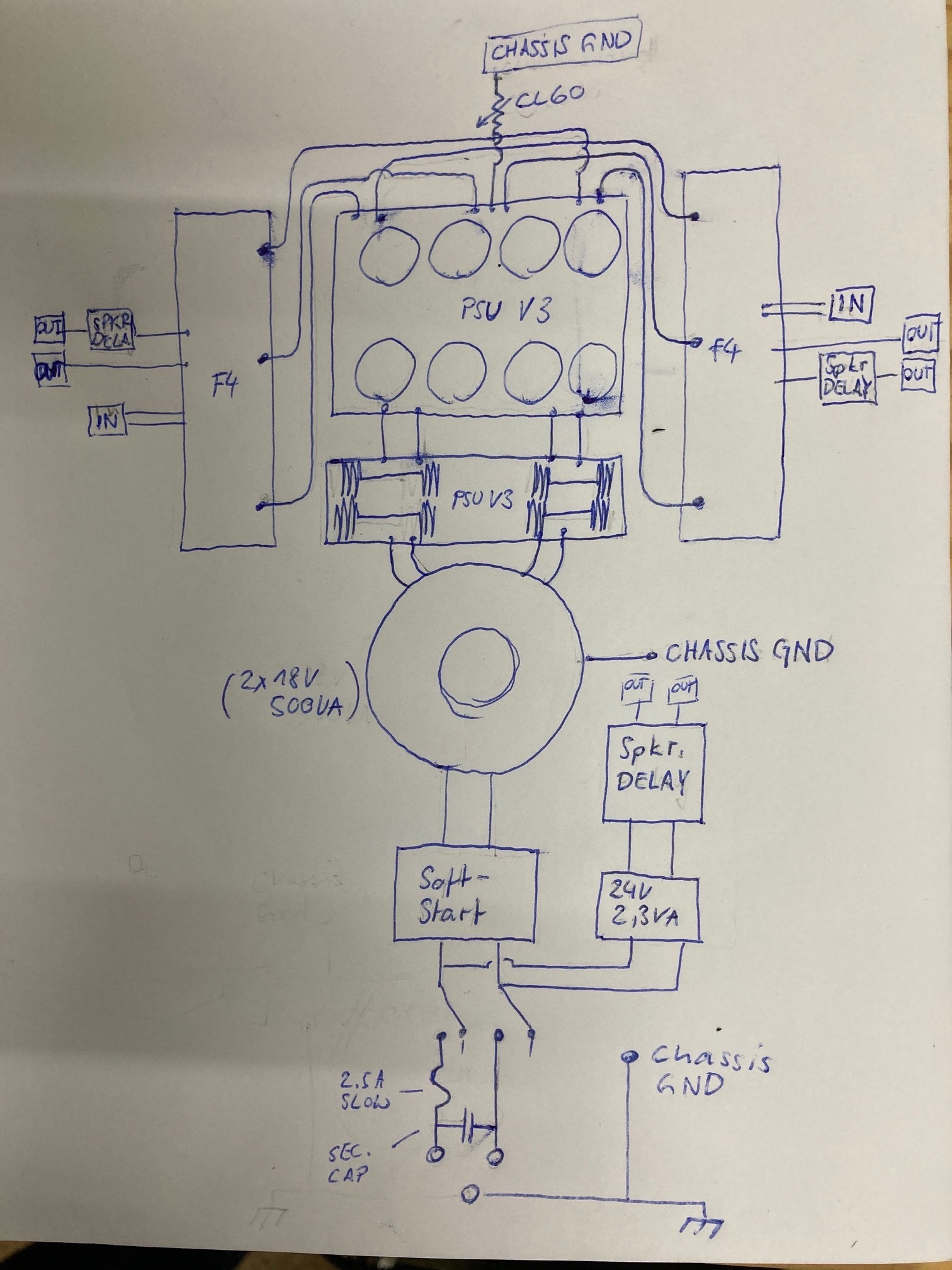

Look at 6L6‘s guide (it’s the F4 but the same here, and to make his comment more precise, it is the only connection from the PSU and amp-board to the chassis! )
(I wasn‘t consequently following the ground-star principle but made several independent connections: one from the IEC, one from the tranny, and one, with CL60, from the PSU. Works.)

Another thing, make sure you get one cl60 on each primary of the transformer. Each primary has a red and black wire. One of those wires will connect directly to either the hot or neutral. The other wire will go through a CL-60 to reduce the inrush. Otherwise half (one polarity) of your power supply wouldn't have any in Rush protection.
You don't want to tie the ground from the power supply board to the chassis at all. The point of the CL 60 on the ground connection leading to the power supply board is not to reduce the inrush but rather it is there too suppress noise. It will have a resistance of around 20ohms cold and once power goes through it, the CL60 thermistor warms up and reduces it's resistance to about 7-10 ohms give or take.
