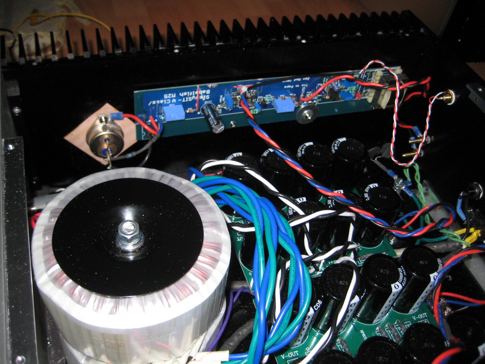

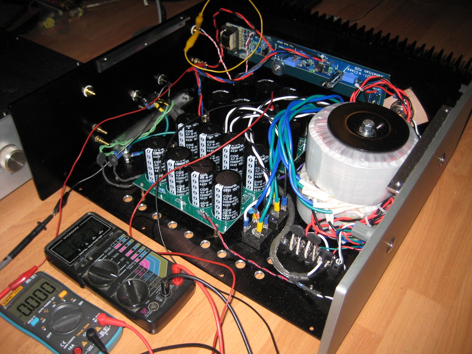

Is there any issue with stacking two transformers, one on top of the other, for a dual mono setup? Would it be a good idea to make some space between them? They will not be worked too hard so should be warm to the touch.
In all of the other dual mono amps, I see them side by side but unfortunatnly I won't have the space for that. It will be in a class A amplifier.
Sure, I've done that. Make sure the transformer bolt does not touch the chassis top plate.

For the bolt, I went to the local hardware store and bought a short length of threaded rod that fit the bolt nut and then cut it to length. Nothing special about the rod.
I used all of the provided transformer rubber and steel plates on both transformers to help keep them centred.
That amplifier was a SissySIT, which is now a Redneck DEFISIT.
