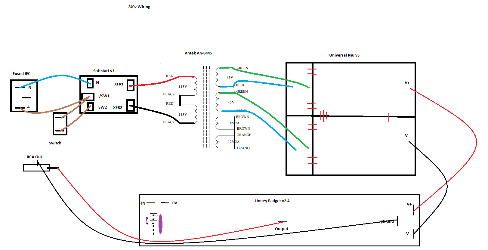

Thanks heaps for the responses guys, I definitely had a bit of a brain fart there in not realising about the bi-polar thing. The main thing which threw me with the capacitor was the fact that the legs were a different length, which I guess is irrelevant in this case.
Also thanks AndrewT, I must be starting to understand electronics a bit better since most of what you said is actually starting to make sense to me!
So I've made a bit more progress but I have few more questions about wiring etc. Because most of the stuff I've found on the forum has been related to older versions of boards I just want to make sure this is right.
I've just omitted the other channel for the sake of simplicity. I'm also still reading up on grounding so haven't worked all of that out yet.
The other thing I wanted to check is that I needed to install the jumper next to C1? I think I remember reading something about this before but just wanted to make sure.
Sorry, think we got our wires crossed there.
I'm probably planning on having 1/4" TS in (depending on what I work out with my question in the preamp thread), and RCA out.
I was going to wire the TS to the IN and 0V euroblocks, and have the OUTPUT and SPK GND going to the RCA.
