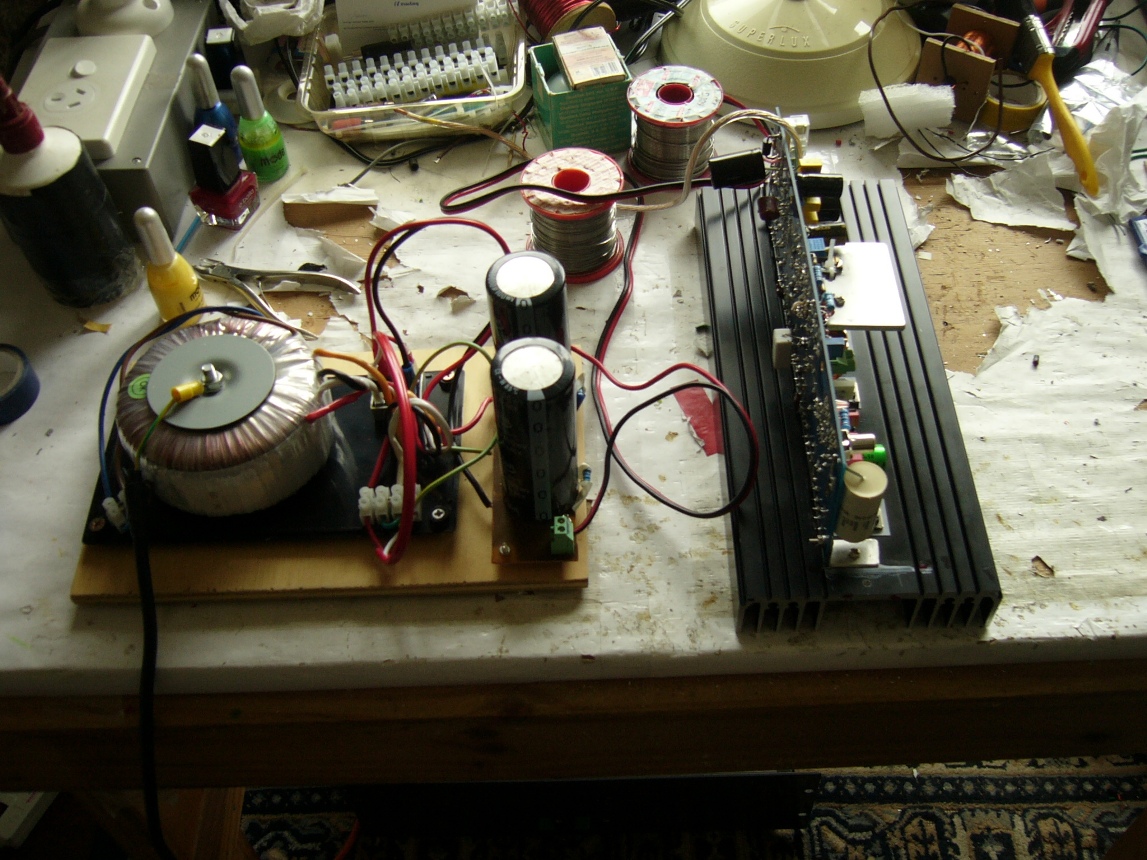

Got a strange problem. First a few hundred Hz noise appeared in one channel just after switch on but it would disappear within about 30 sec. A couple of weeks later mains fuse blew. I took HB modules out, checked PS first, perfect. Then I connected the quiet module to my bench PS (300VA 2x25V toroid with 50A bridge and 2x10mF caps giving about 2x36.5V DC with one module connected), offset zeroed and AC about a few hundred uV at the output. Mains noise. Connected the noisy module and again no problem, offset zero and AC at the output closer to 1mV. DC voltages I measured at a few randomly selected points correct.
Then I shortened input hoping that noise would completely disappear but it jumped up to over 100-150mV and is similar to noise between FM stations. Mostly several hundreds Hz up to a few kHz masking mains noise completely. That is my frequency guess as I listened to this noise with my test wide range speaker connected (8 ohm).
The other channel behaves similarly with input shortened but noise is about 10-20mV.
When placed in the amp's case with amp's PS noise behavior is similar with both modules but the quieter module is quieter. What's wrong?

the "shorting the input" seems to be increasing the noise.
This is the symptom we hear when a long lead is connected to an input.
The long lead acts as an aerial due to the high input impedance when there is no Source connected.
That makes me think you are not actually shorting the input.
Could you show a pic of what you are doing and describe what you are doing when you "short the input"?
Just RCA plug with screen soldered together with the input pin. No cable whatsoever. That's why it seems strange. And why the mains fuse blew a couple of times? PS fuses unaffected, voltages/currents as should be.
Could the input cap became strangely damaged so when its input is connected to ground it creates together with resistors some sort of an aerial or an oscillating circuit?

I haven't solved my problem yet as I spent may Sunday away from home.
Anyway, on powering up I use only a soft start unit and a globe. Never experienced problems with such arragement.
As my recent problem clearly demonstrates parts which are faulty only under certain conditions can became a real pain.

My amp worked very well until last week. First, a couple of weeks ago I got noise in one channel after powering up for about 30 sec but that happenned only occasionally and then last week amp's mains fuse blew.
The only partial fault I discovered was weak soldering on the positive supply to the board. I discovered it when I used pliers to check strenght of PS joints as blades do not solder very well. Anyway, on my test bench everything seems fine and noise (about 120-150mV) appears only when I shorten the input.
