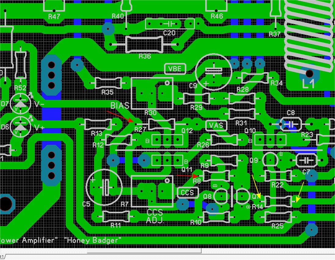

When adjusting R7 Trimmer to the recommended 85 Ohms, should I measure from Pin 1 to pin 2?

I was asking about trimmers in general. In the build manual it says to set R7 to 85 Ohms.
In general, prior to soldering the trimmer on the board should we measure between posts 1 and 2 then set the recommended Ohms?
I'll measure the voltage across R14 when I "fire it up" 🙂

The better way, if you can't work it out before soldering, is to measure the resistance as soon as you solder it in and SET the resistance to give minimum bias voltage. This is usually minimum bias voltage = maximum VR resistance.
R7 adjustment ....
The nice thing about the badger topology , any R7 adjustment (even 0R) will
just affect the LTP current.
10R is 3.2ma per device and 190R is 1.3ma. But , VAS current stays at 7ma ,
regardless.
The 90R suggested setting sets Q1/2 to @2ma (optimal for ksa/c's) , but the
amp would not be destroyed by even a shorted trimmer (it would actually still work).
PS - I does not matter , but R14 can be 1K. With 1K- voltage=mA. This is
a present upgrade to all my IPS's. (ease of adjustment) 🙂
