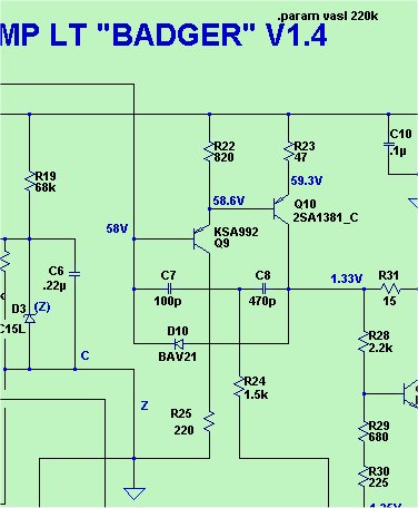

Hi OS,
I hope you are still monitoring this thread. Earlier when I built my Honey Badger I discovered a latchup at clipping . You came up with a fix using a diode. I believe you initially connected it from Q10C to Q9B. I'm not sure but did that change to Q10C to Q9C?
I ask because I am working on a thermal-trac amp right now that is exhibiting similar but even worse latchup and I am hoping that this diode fix may work for this as well.
Thanks, Terry
Hi OS,
Thanks, Terry
As far as I know the diode goes from the collector of the ksa1381 (q10) to the base
of the pre-driver Q9b. bridges C7 and 8 ...
OS

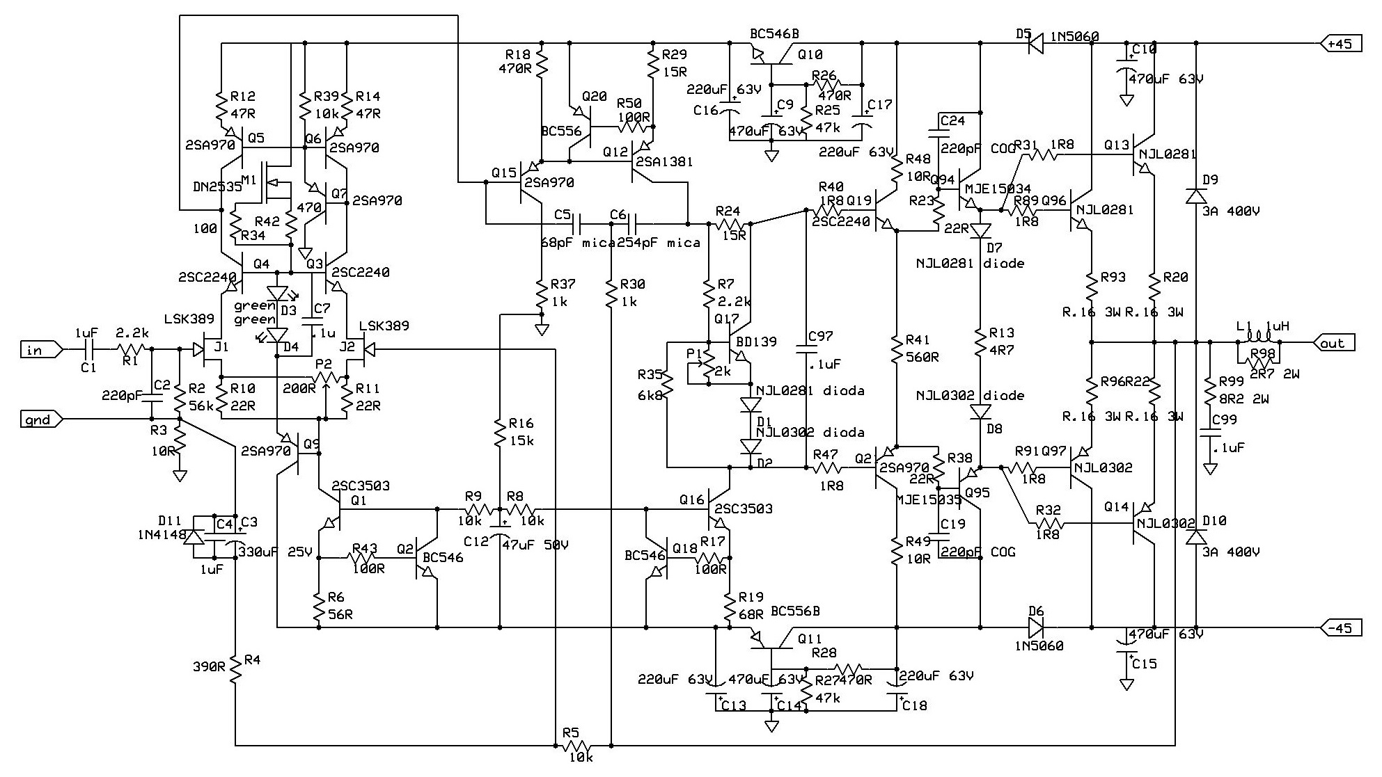

The discussion began here. It seemed as though the nodes changed during the following posts. I never actually tried the fix on my HB. I am attaching the T-T schematic. You will see that the front end is very similar the to the HB.
Thanks, Terry

I don't know about Q20 in the schema - it is a saturation clamp.
C5/6 are the TMC caps - reverse BAV21 across them. You should discuss
this w/dadod ???
I KNOW it works on the Badger/wolverine (my sub amp has one) - little
saturation on clip.
OS
