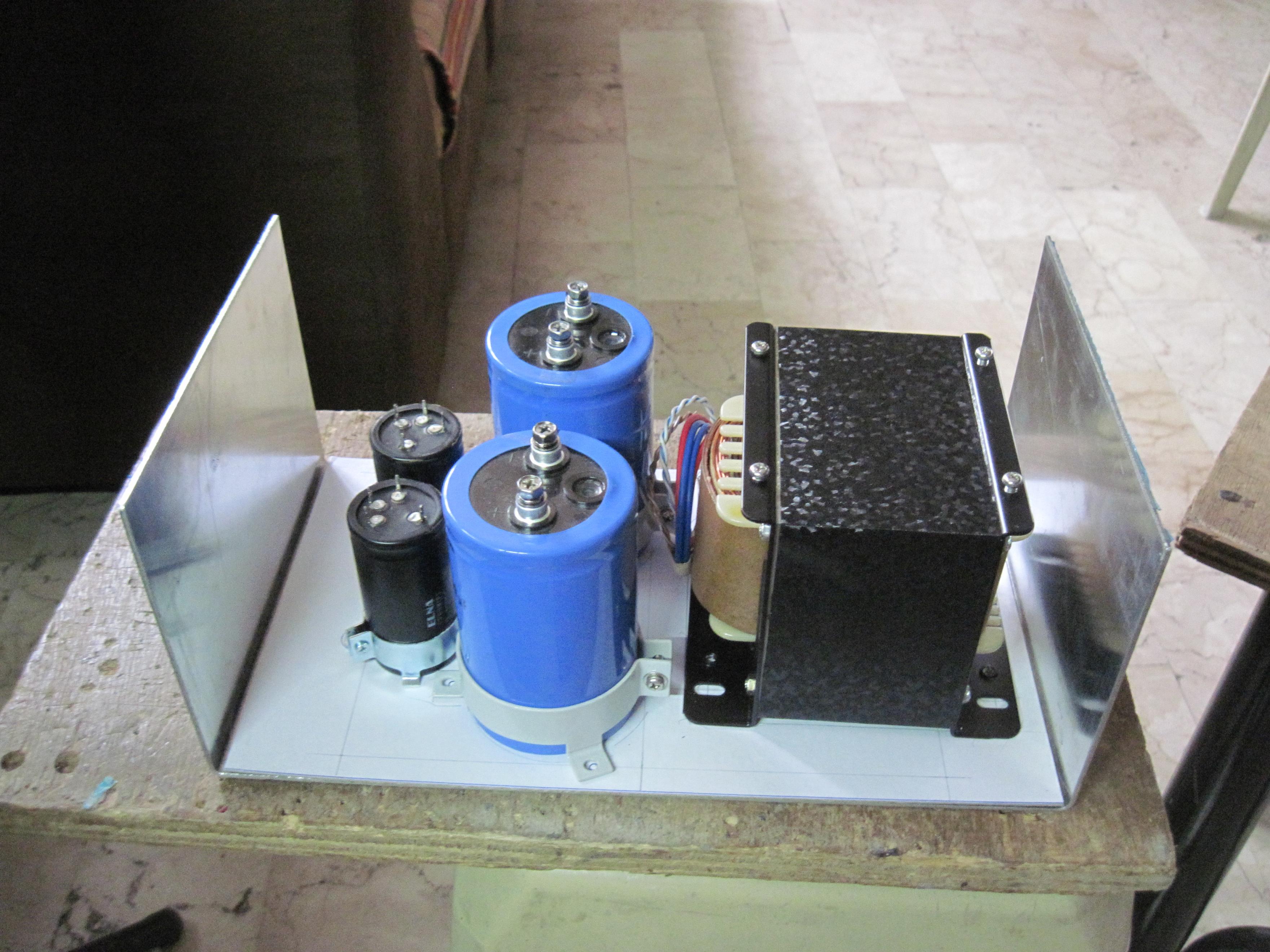

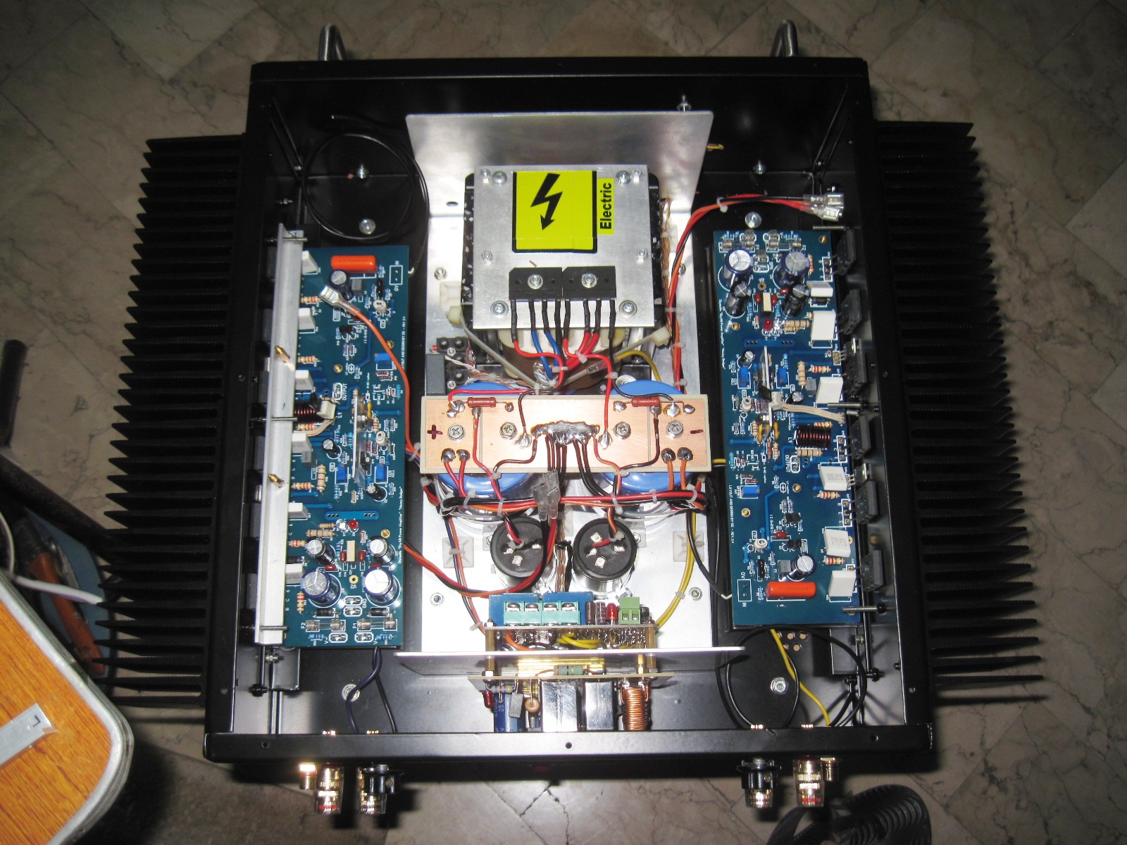

i have a suggestion, for the grounding, you can just label them Gi for the input ground, and Gp for the power ground....
Gi goes to any metal chassis connection point close to input jacks..
Gp goes to psu central ground connection point..

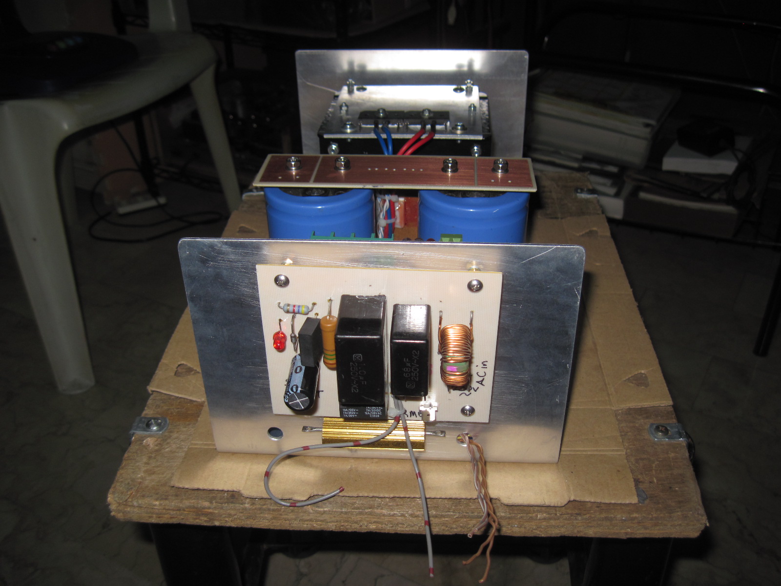

btw, my beef with this amp is the lack of SOA protection on board, so we took care of that and came up with a SOA circuit on board....

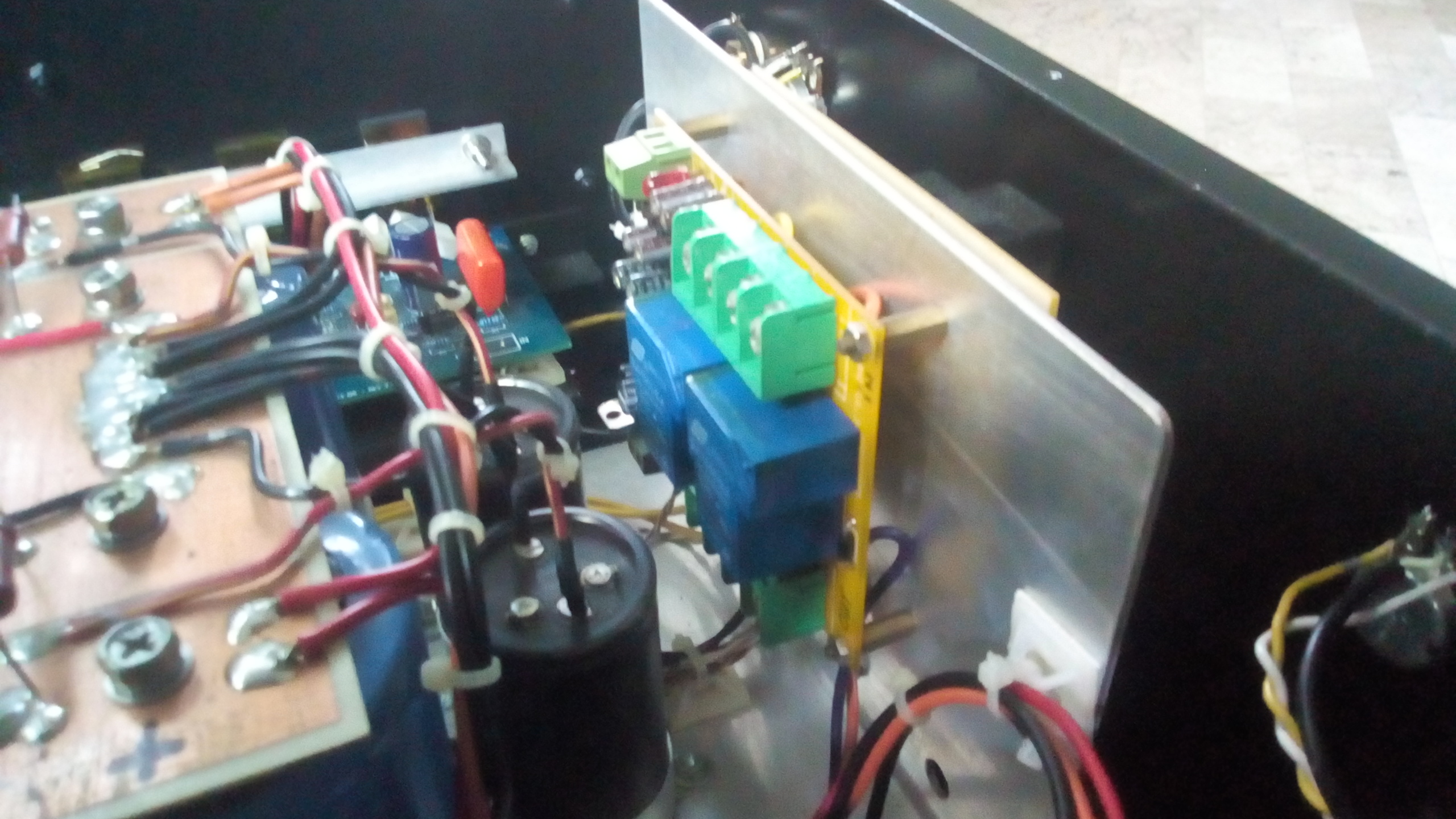

speaker time delay relay cum dc detector is a must in my builds...
so with a soft start circuits since i tend to use largish filter caps, 68kufd//10kufd @63wvdc...

R4 on the board is a Humm Breaking resistor, it reduces currents flowing around the interconnects (Cross Channel Ground Loop). You isolate the RCA from the chassis for this to work and only connect the 0V of the PSU/AMP to the chassis, preferably via a Ground Loop Breaker.

those diodes are idiot proof protection, if you happen to reverse the psu polarity, these diodes protect the output trannies from damage, i would say cheap protection...
i would even suggest those diodes be in series, so that inadvertent reversal of psu leads would not cause damage, not even a fuse blow as in the case of d8d9....
D8,D9 can also be in series with the boards forward biased, a schottky low loss diodes will prevent amplifier damage to output devices in case the user happened to accidentally reversed the psu connections...no fuse blows, the amp simply will not work...
