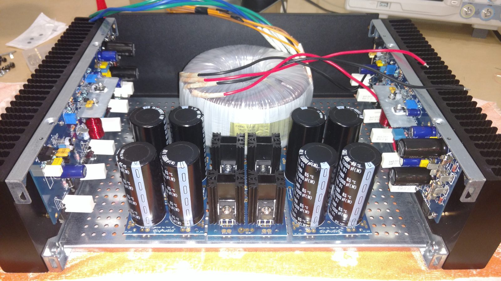

Chassis layout
Went with a smaller case, had to split the PSU board into sections. There is still some room between the transformer and the amplifier boards. I plan to use it to (vertically) mount soft start and speaker protection. Any comments?
Looks ok to me.
Instead of the rectifier diodes and heatsinks I used rectifier blocks to save a lot of space (add a snubber and you'll get the same smooth switching performance). I also mounted the smoothing caps closer to each other (not using the diyAudio PSU boards). The additional space allows for more additional smoothing caps. There was still enough room for the slow start, and the speaker protection went to the back plate. See photos here.
Hi reedcat,
Does your build consist of single transformer with dual secondaries, 2 independent PSU and 2 amps?
regards
Prasi
One transformer, dual secondaries, just enough to feed one dual rail PSU, two mono amps (one on each side).
The extra wires from the transformer are another set of smaller voltage/wattage secondaries which I don't use at the moment.
