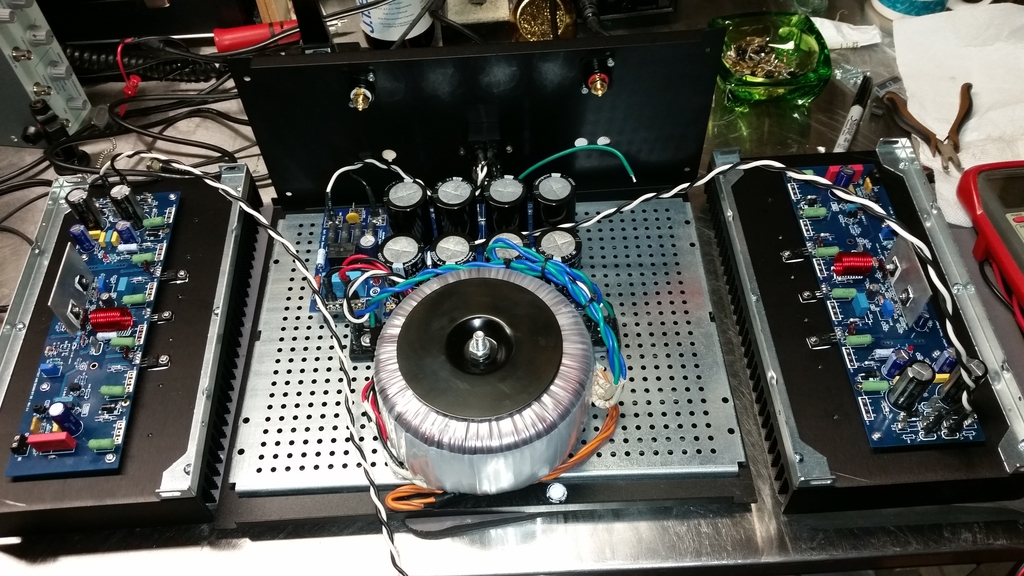

I am trying to find out which size of the diyAudio Store Deluxe Chassis would fit my Honey Badger project. The pre-tapped holes, mounting plates, etc. really seem to make life a bit easier... !
I'll have a dual-mono power supply (single toroid with dual windings). Aiming for 45 to 50 VDC rail voltage. There will be a slow start and two DC protection units.

I built my Honey Badger in the 4u chassis with dual power supplies with the chipamp.com Aleph power supply boards. They are a bit bigger than the DIY Audio Store boards. Might be a little tight with soft start and protection boards, but should fit.
The 5u / 400 mm chassis uses 2 pieces of heat sink per side. The joint is right where the center hole would be. It's way overkill for a badger anyway.

I have the 5U deluxe chassis. I haven't completed my build yet, but the join does require a relocation of the center hole. I haven't decided how I will address this yet due to being busy with my house renovations. If I had my time back I probably would have went a bit smaller....but then circuit protection options are limited.

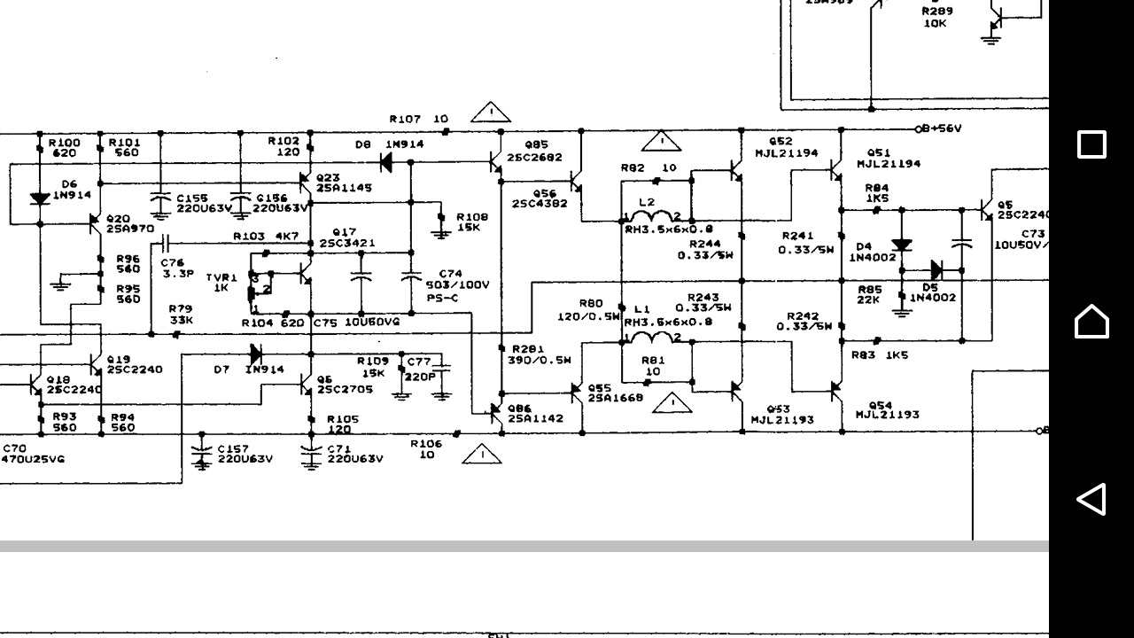

I don't see the Zobel you refer to.
I do see a damped inductor in the base feed in lieu of base stoppers.
This might have the effect of slowing down the output's response sufficiently to compensate the feedback loop.
I also see very heavy loading of the previous stage (R108, R109 & C77) This will also apply HF compensation.
