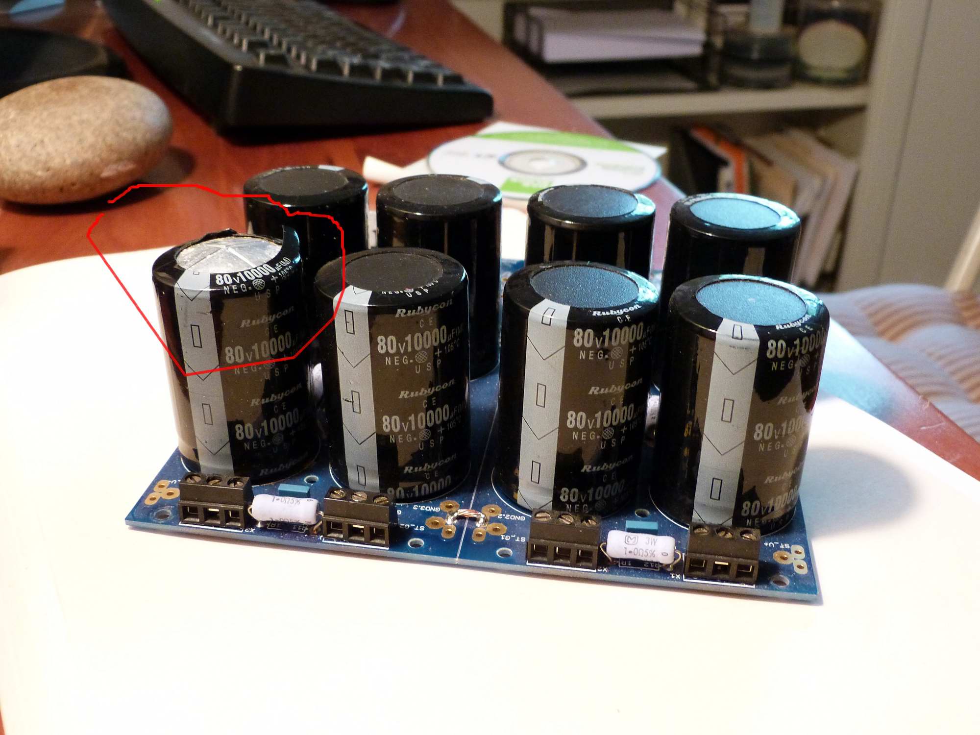

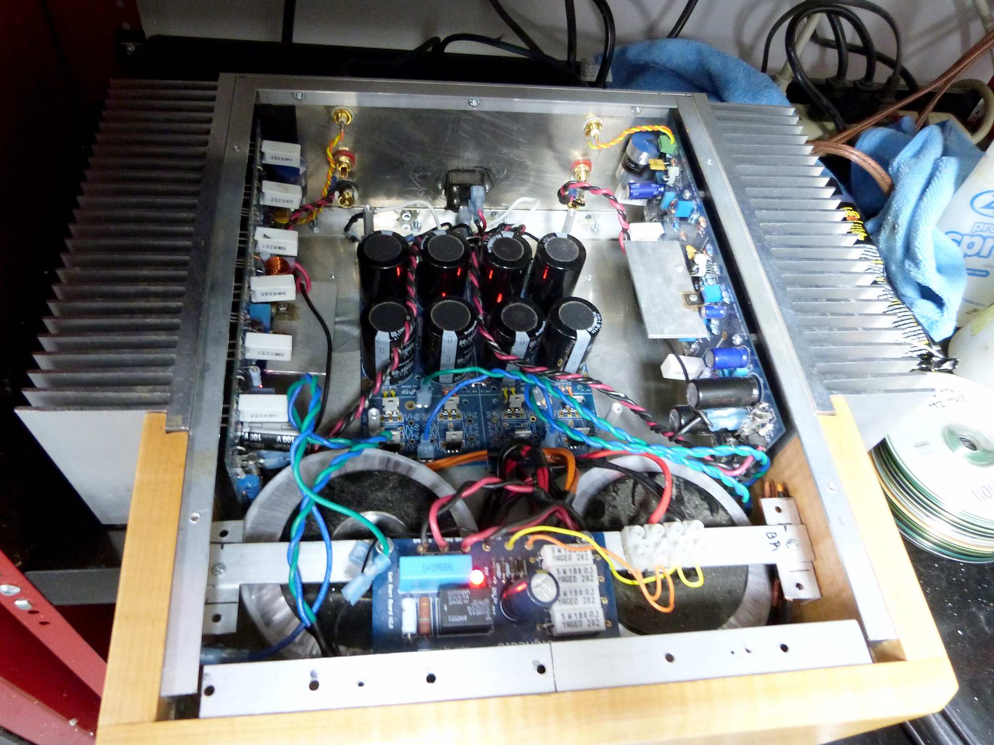

Noise problem solved. Took your advise and rewired the PSU twisting the gnd along with the rail +/-, also twisted the speaker out and gnd and took speaker gnd from board and not from psu. I also discovered that one of the PSU caps had bulged and switched out the psu. I got these 80v caps from EBay, my rails are 60V, guess they're Chinese fakes, thought the price was too good to be true. Anyway the high freq hiss is greatly reduced, actuall need to put my ear on the tweeter to hear it.
Thanks all,
PJN

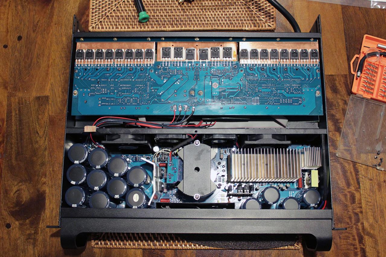

BTW, Cristi at Connexelectronic.com provides some very good SMPS. I use them almost exclusively, except in some of my early amps where I built linear PSUs. They're small, light, efficient, and the craftsmanship speaks for itself! I heartily recommend them. 🙂
I would not recommend any of the Asian SMPS's. 20'th century switching tech.
Compare the rails of a 1990 PC SMPS to a new Corsair 2010 600W unit.
21'st century low Rdson MOSFET's + much better control IC's (with PFC) =
> 90% efficiency and just millivolts ripple.
Lab gruppen is one of the only OEM's that is
"on the money" (below).
That is a 40A !! with PFC thermal / current shutdown - nearly zero ripple.
I'm bored with analog design , my next "foray" will be one killer +/- 60V
20A SMPS !! 🙂
OS
Lab gruppen FP14000 amplifier that you linked does not have PFC, but instead uses good old voltage doubler when running in the 110V part of the world. Also no modern MOSFETS, but instead good old IGBTS, and no modern control ICS, but a discrete built circuit on a small daughterboard. And to top all that off, good old flyback SMPS topology. Everything typical for the end of the 20th century. 🙂 Now, there is nothing wrong with this approach, they simply chosen to go the brute force way with oversized flyback. There are much better examples of modern amplifiers utilizing modern 21st century technologies.
