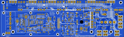

DIYA store "Wolverine" (Son of Badger) .... suggestions ??

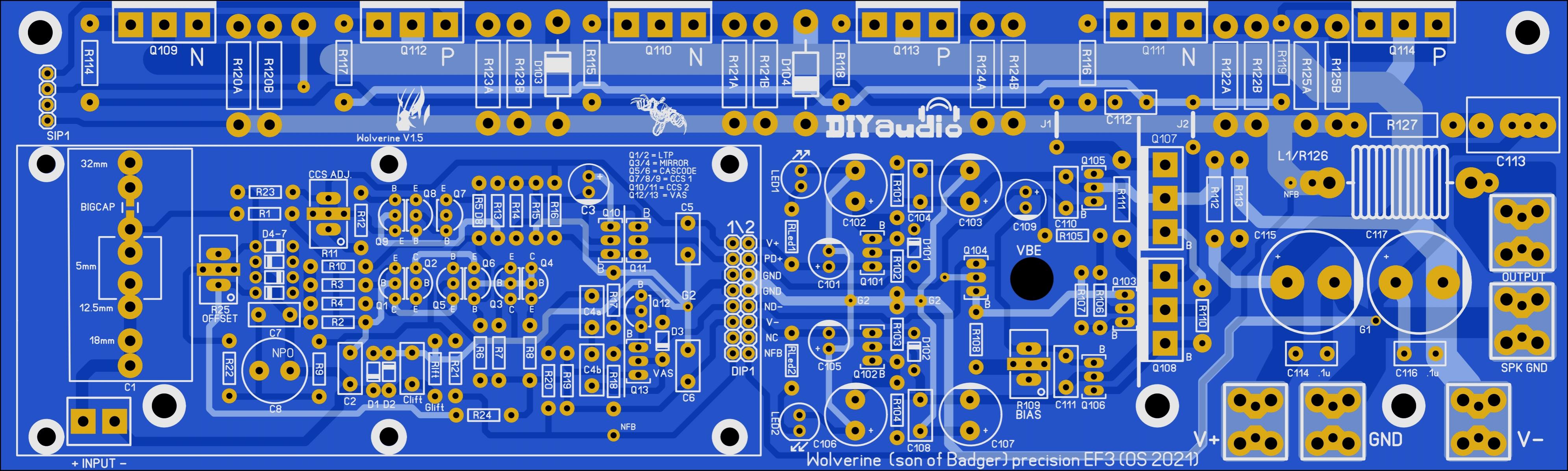

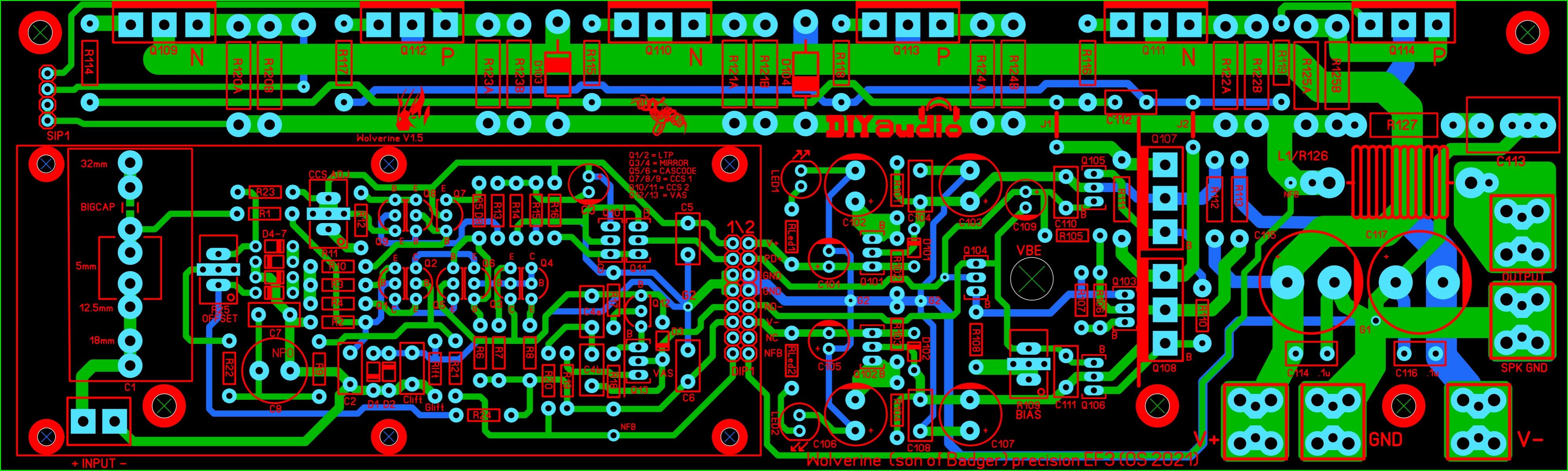

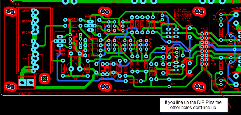

Looks Great OS, You need a outline on layer 0 that surrounds the pcb. This is what the pcb companies use to cut the board to not just sizing the properties of your pcb workspace within sprint layout.
Ahh , layer O.
Tweaked the cap , layer O.
.8mm for to-92 , 1mm for 1/4w , most everything else ... JW's 1.7mm.
I don't see how anything can be undersized. 😕

You can always load your fab files up on jlcpcb, when you do the quote, it does a file check, displays the gerber and auto calc your pcb size. Need to name the files appropriately according to their naming conventions, put in a zip file.

Main board DIP1 offset 1mm (up).
Your other shift to the left is because you lined up the wrong row on dip one.
Standard IPS.lay is right on.

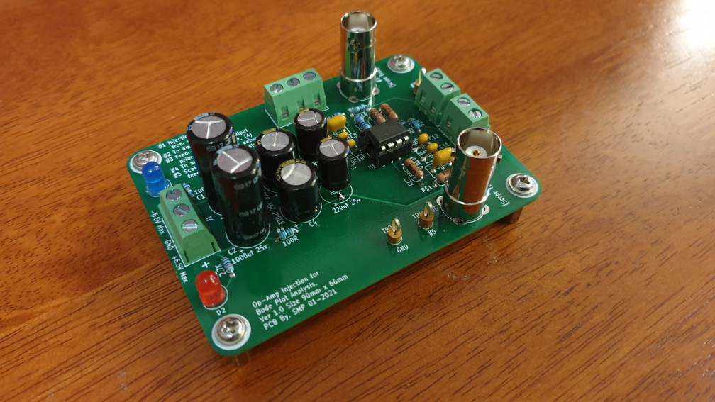

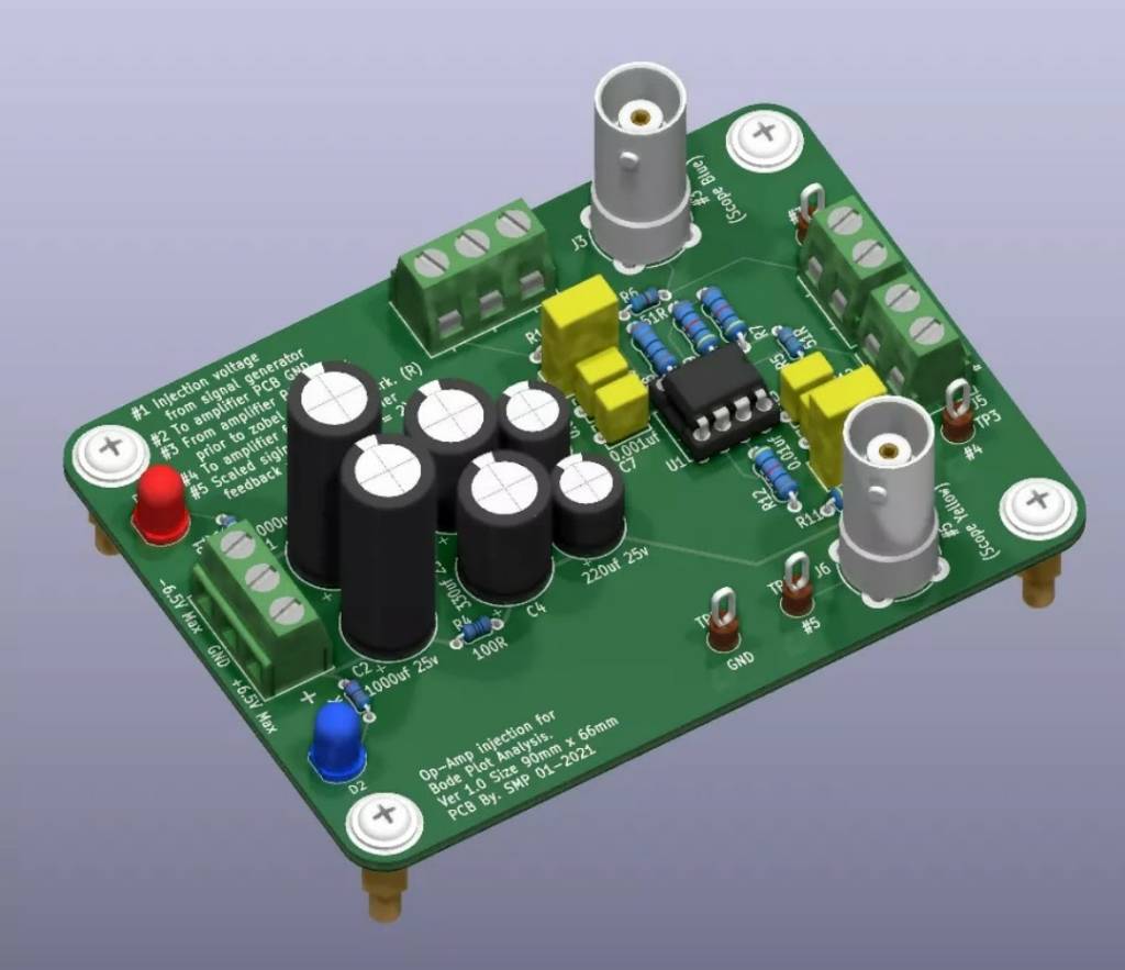

I agree, sprint layout is not bad for a quick hack. But Kicad is the way to go. I learnt it in a little over a week.
This was my first design.

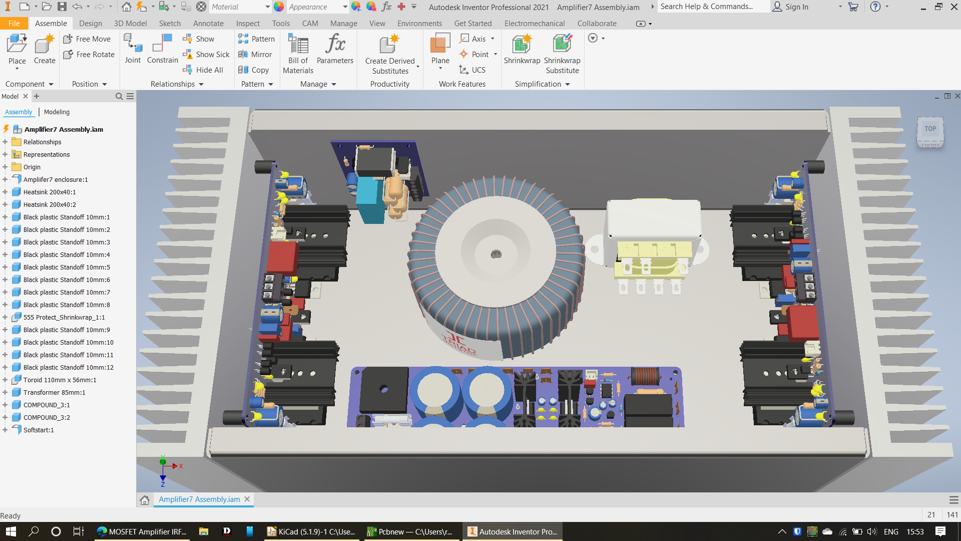

Prototype... schematic... 3D model... final design...1625476442.jpg149072762.jpg1378134562.jpg354772670.jpg

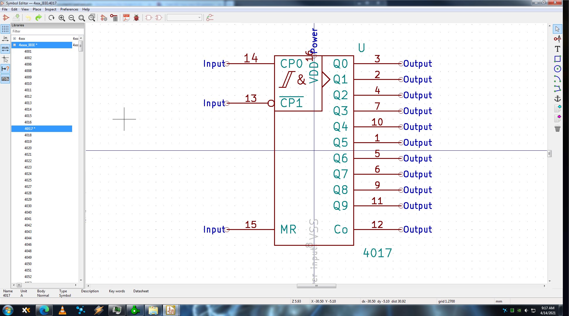

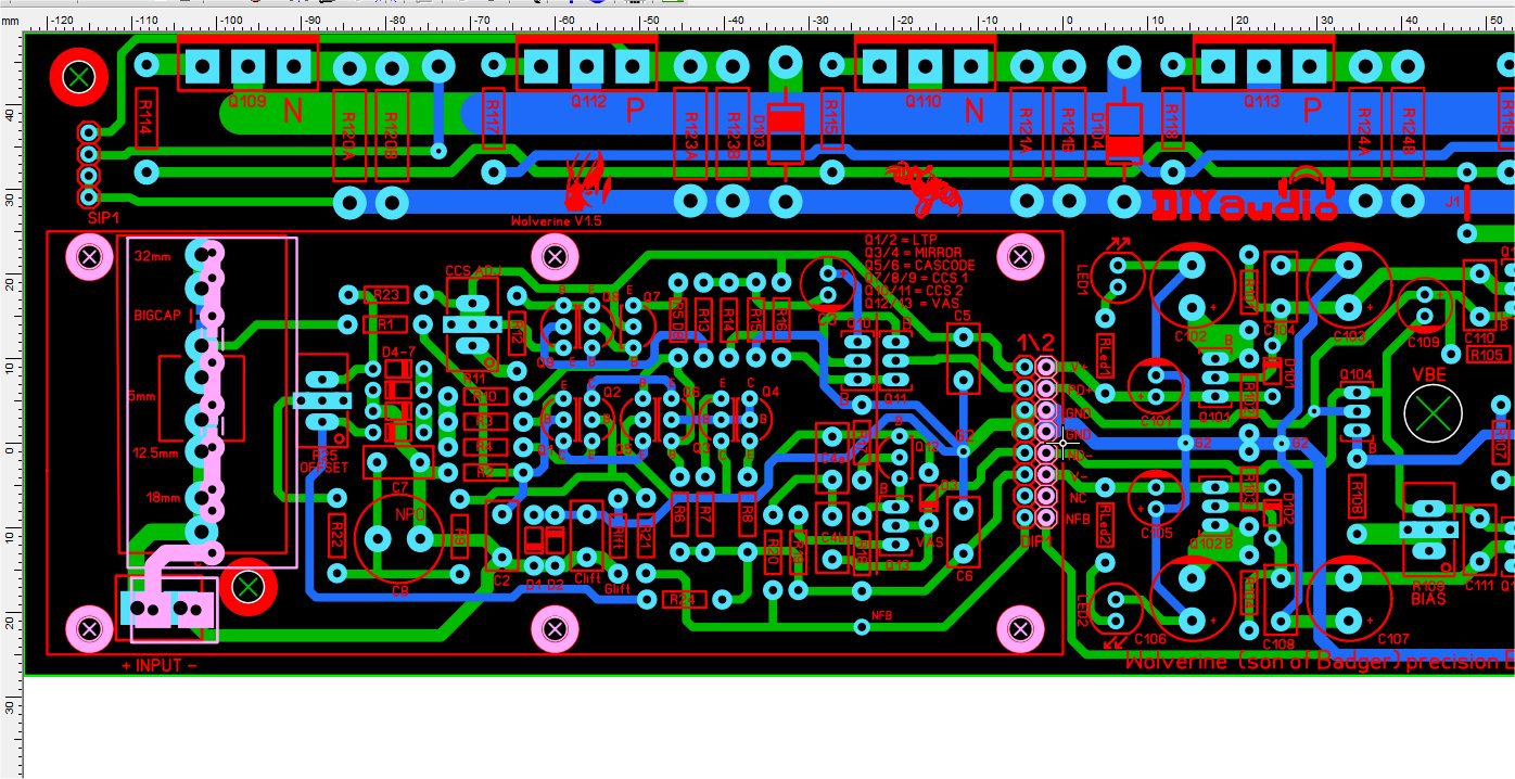

"Standard" fits wolverine - KICAD
(Below) perfect fit now. Row 2 !! of DIP1 is where it goes. Macro'ed "standard"
holes line up perfect.
Kicad - says won't work on my W7. BS , I have corp. extended support
patches on my 7. Digital signing,AES is just like 8/10.
I go on my son's W10 PC , 7 is all buried in it. M$ just took 7 and "adafied"
it .... no innovation - just a sellout. (below 2}
Kicad is like Eagle + , big modern library ... lots of chips.
Guess I'll learn it.
Perfect Wolverine attached , as well.

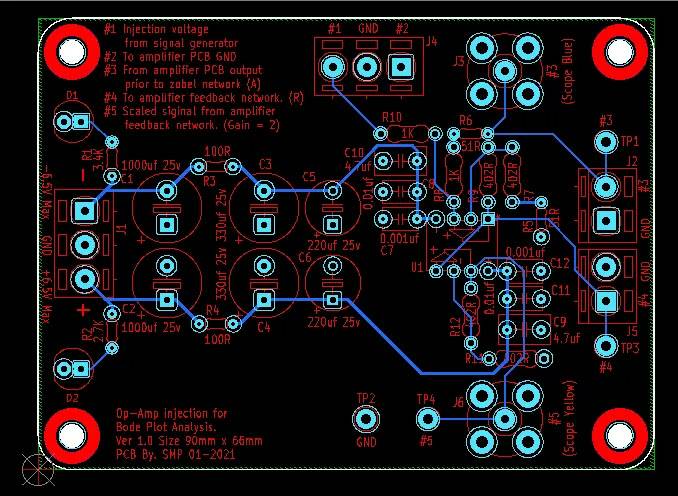

If you get into Kicad, do yourself a favor and get familiar with Mouser parts library. They have models/symbols/footprints for tons of parts.
I prefer Eagle's interface but it certainly isn't free for such big projects. 🙁

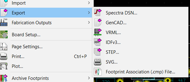

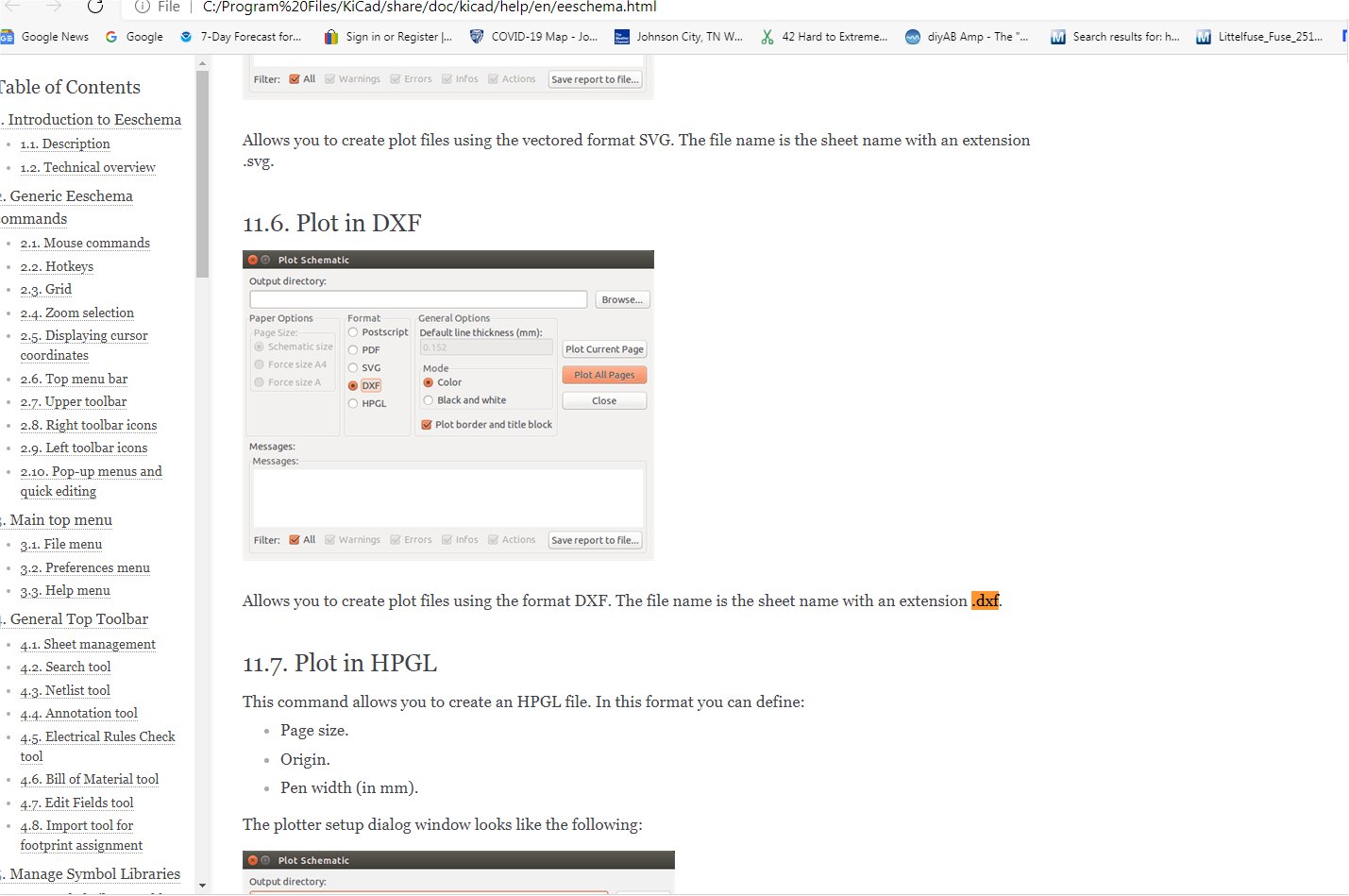

I've been curious about Kicad but haven't had time to play with it. Are you able to export a .dxf from the 3D rendering in it? This is a handy option to use with Fusion for chassis design!
I export to STEP and import into CAD, Im using Autodesk inventor, but Fushion 360 is about the same.
Ive attached a STEP exported from KiCad so you can import into Fusion to see for yourself.
