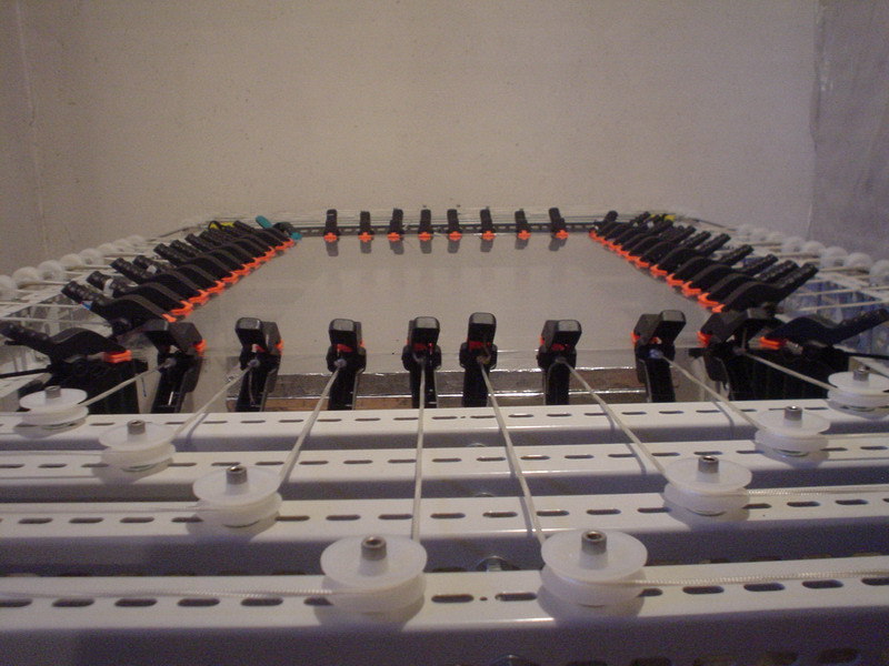

Hello to all,
seems to be a stretching jig contest. So here is mine. Looks like the great brother from Arend-Jans jig - but it has more clamps on the short sides similar to the original 63´stretcher. This beast is two meters long and fills the room...all for my Quads.
Harry
