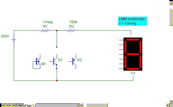

Yes my test should be BVcer
one last question--- Mj4502 rated Vceo is 90v , breakdown test Vceo is110v and
Vcer is 185v , as per this Vcer voltage it should work ok in an amp with rails up to + / - 80v , can I trust this ?.
The devices have been processed with 90 volts in mind..so, the manufacturer datasheets will have an SOA curve that is bounded by the bonding wire limitation to a maximum current, a theta jc curve maximum, and at the higher voltage, by a secondary breakdown area, then finally, by the device maximum rating in voltage.
By using it over 90 volts, you are heavily into the secondary breakdown area..I would not recommend that on general principles. And it is difficult to say if they will survive, how reliable they will be, and how they will react to the reactance of the speaker load...if you look at the SOA area, extending the vertical voltage line doesn't really buy you too much additional capacity device wise..
I run mobile DJ apps, and prefer reliability over cost..so I would not be comfortable using the devices above ratings. Your's may survive in a well designed circuit, but I'd be wary.
Cheers, John

I got a very encouraging e-mail from
Stephen Mantz he gave his breakdown testing method and the follows ;-.
( ( I used to do this 30 years ago with 2N3055's to use them in high powered
amps as 2N3773 and 2N6259s were so expensive in those days.
Typically all good quality trannies will exceed their Vceo ratings by a good margin
- why because the manufacturer must guarantee the spec.
Now remember something. All trannies are operated with some sort of Coll-Base
resistor (especially output types) and the Vcb rating is much higher than the Vceo.
So you can do the same above scope test by simply connecting the alligator leds
to Coll- Base instead.
Do not forget to check SOA if doing this with outputs. I have routinely used
TIP35C/36C on +/- 70 v rails with NO pre-grading done. Why because with
experience the Vceo 100v rating is always higher and the Vcb rating is even
higher again and I have 22 ohm base-emitter resistors in the circuit.
Of course with +/- 70v rails and depending on the lowest impedance being driven,
enough device must be used to ensure safe operation ))
With Good Wishes
