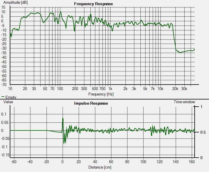

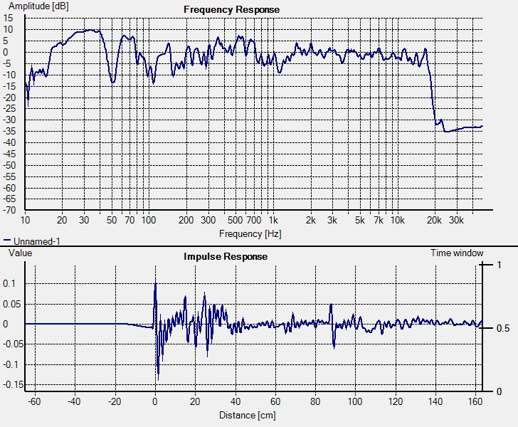

Ah I was using Log sweep for some but figured the MLS was better. Sounds like I have to use the methods I was using previously to look at integrating the subs best. I will take new measurements then.
There may be some odd reflections in the response, I have a lot of crap in the room still. There are some boxes with all my DVD's in them sitting on the floor off to the side of the speakers, and they could add odd issues. I can place all my acoustic panels together on the floor and side wall for just one speaker and see if I can't get a better measurement.
Ok here are measurements with the log sweep method. There don't appear to be any built in averaging functions, but I took 6 measurements around each seat of importance. I then exported the files, averaged those within each seat, and then brought them back in to look at. I have one pre measurement for the main seat, and one post. The pre isn't really fully pre tweaking, as I had already started to move things around. None the less, the Pre measurement is with the room still having some boxes in it, no curtains, and the acoustic panels in another room. The Post measurement is with the room mostly cleaned up, a large thick upholstery fabric bolt unrolled and hung on the wall over the windows. The acoustic Panels hung up in temporary positions, and towels/blankets set up on the floor. There is also maybe an hours worth of eqing work, but I'm not fully happy with it. I like to make my adjustments very slowly. I change one thing at a time, then measure, change another thing, measure. Sometimes I will change something, measure, change it back, measure, change it again and measure, etc. This is because I'm still getting a feel for both general functioning of the filters, and how they work specifically with the Behringer. My DSP card isn't hooked in at the moment, but will eventually replace the Behringer and offer additional functionality and resolution, I hope.
Dr. Geddes, if you do get a chance to look at these and can glean anything from them, that would be great.
Oops just realized, the pics are in reverse order. The first is the post, the second is pre. Should be obvious since the first is much smoother. Look at the difference in the impulse response.

Yea Matt, those are not very good measurements. If I get a chance I will post what they should look like. I have at least 40 sets of Abbey data, and so I know what to expect. The impulse should ring maybe a half cycle or one at most and then go dead flat. Yours have lots and lots of extraneous "noise" or diffraction or reflections or whatever, but the data is contaminated to the point that its not going to be very usefull.
I didn't think so either.
Just to make sure everything is clear. This is taken at the listening position, so around 4 meters. The room, as mentioned, isn't a great room yet. It has all hardwood floors, so its very reflective.
Diffraction sources is certainly possible. It's not a dedicated room so nothing is built in. There are dvd racks, cd racks, the audio rack, subwoofers, etc all potentially acting as diffraction sources. I did my best to reduce these, but towls and blankets are a far cry from proper acoustic treatments. A lot of that will have to wait until I get more settles. I will need to buy some of the necessary things, so that is why I'm taking the time to do this now. I need to figure out what to get to fix these problems (such as the area rug and pad).
