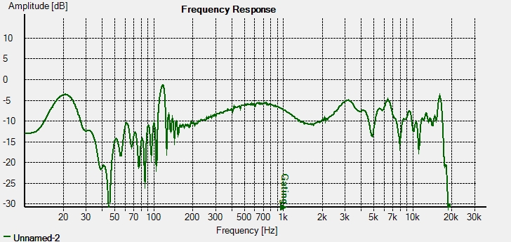

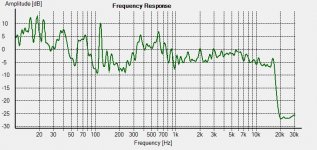

Hey Dr. Geddes, Well I'm now all setup in my new house, with the theater setup in the living room as best I could for now. I have some work to do for sure. The measurements showed a few things that I now have questions about.
First, When I take a measurement with Square Noise Improved MLS method, the response seems to be very detailed, but shows a response that is essentially flat within a +/-5db window. This is the gated response measurement, and the gate point is "automatically" detected. The response shows more detail in the high frequency area than it does in the low frequency area it seems. I see pretty clear signs of comb filtering from 2khz to say 18khz where the response falls off like a brick wall. What I find is that, if I change the subwoofer level, it seems to have virtually no impact on the relative level of the bass to the main speakers. Why would this be? When I switch to a smoothed response instead, it shows the low end response much better, and I can clearly see relative level changes, and EQ change. Again, why would this be? I want to make sure the methods I'm using for setting levels and eq's makes sense, and it seems that the Square Noise gated method isn't giving me good resolution down there (When I make an EQ change I often can't even see the change).
Ok second question, regardless of the method I use to measure, I see signs of excess energy between 300hz and 800hz. It appears to be exacerbated by large response dip centered at 70hz, but gradually extending out to around 150-200hz. Subwoofer placement optimization will likely resolve at least some of that problem, but the excess energy I think is crossover related. I saw this same issue when I would take measurements in my old room. Now that you do have this alternate crossover it makes me think that the new crossover would largely resolve this problem? I know it's expensive, but when you consider what many audiophiles will spend on magic stones, I would consider the cost of replacing the crossovers pretty minimal, with a much more profound impact on the sound. If you don't think its being caused by the crossover design, I'd love to hear what else it might be. I've measured all three of my speakers both in the room and outside, and they all show the same thing.
Ok the last issue is what to do in order to fix these many problems. My thoughts at this point are to fix the room first and foremost. When I get a chance I want to try some different subwoofer arrangements as well to fix as many of those bass problems as I can. The main speakers alone show a 70hz suckout which I believe is caused by the floor bounce. With subwoofers it shows a peak, so I actually have a PEQ centered around that. There is another one at 38hz that I also am removing. That actually gets the peaks below 100hz down, so its a matter of that trough in the response centered around 200hz. Since my subs aren't operating in that range, no amount of eq or moving is gonna impact that. Then there is the excess of energy in the 300-800hz range that I think is best handled in the crossover, but could be done through an external eq as well.
Ok finally, the room reflections. I'm guessing that all of that upper end comb filtering that is so evident is coming from the fact that this room has virtually no absorbing materials. The floors are hardwood, the windows have blinds on them and are centered right at the first sidewall reflection point, and my one and only chair in this room is leather. I plan on putting a large thick wool area rug on the floor with a relatively thick pad underneath. I plan on putting drapes up on each side wall, in front of the blinds. The front wall with the screen will have the 4" thick acoustic panels flanking the screen to the wall, with a curtain surrounding that, at least eventually. I don't think its going to help to try and absorb ceiling reflections, so I"m thinking of using a painted diffraction device above each speaker at the first reflection point, and covering the rear wall with something that diffracts. I probably will have a pair 2'x2' acoustically absorptive panels roughly 2" thick back there as well, but placed up near the projector (I'm hoping it will slightly reduce the fan noise). Bass traps are what I have been using, the tuned traps I built. What else should I consider to deal with these issues?

Oops, I should mention that response I attached is the Left speaker and 3 subwoofers with no EQ and no tweaking. The Behringer is basically being bypassed.

These are complex measurement issues.
First don't use MLS, use log sweep. In you last plot, nothing below 1 kHz is valid and above 1 kHz looks like a reflection in the data.
I would need to see impulse responses first and only then look at frequency response. Most of what you are showing is meaningless.
Its impossible to get windowed data below about 200 Hz in any real room. So when you make changes down below that you likely won't see anything or what you see is not valid anyways. You need to do steady state spatial averaged below 200 Hz. Basically there is no one technique that will work in a real room. It takes a composite of many.
There is no way that you are seeing any effect of the crossover in real room data. The changes to the crossover are far less than what you could resolve in a real room measurement.
There is a lot more that I could say, maybe I should write a book on "real room measurements", but I am out of time.
