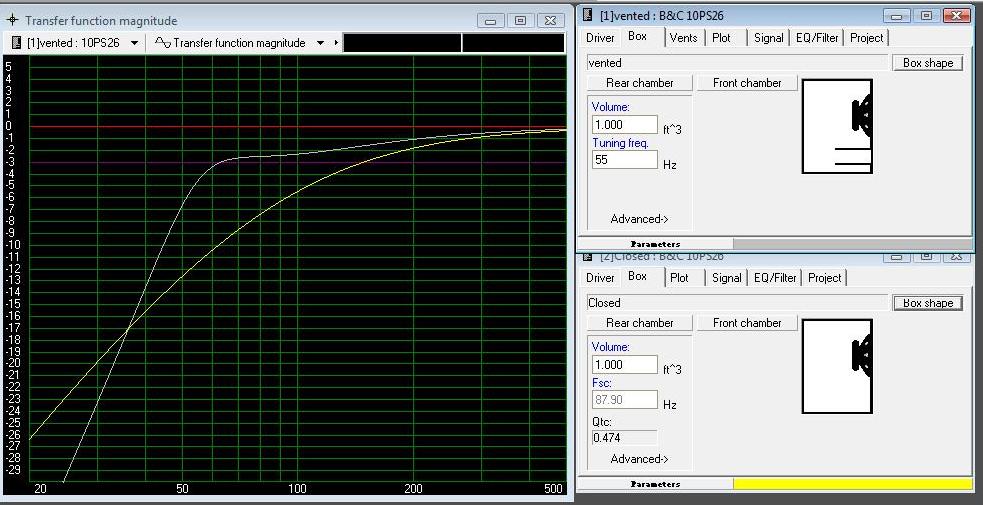

All that I can say here is that you are more than free to try such a thing, and I might even consider giving you the recommended port sizes, but I don't see that as yielding any benefit to the situation. If you can't afford to do bass, then don't do bass, but I suggest that you leave the Nathans as they are since they are right the way they are. In any case no crossover mods would be required.

It sure looks like there's a big benefit to me; the plots show the 10PS26 sealed and vented, both in 1 cu ft.

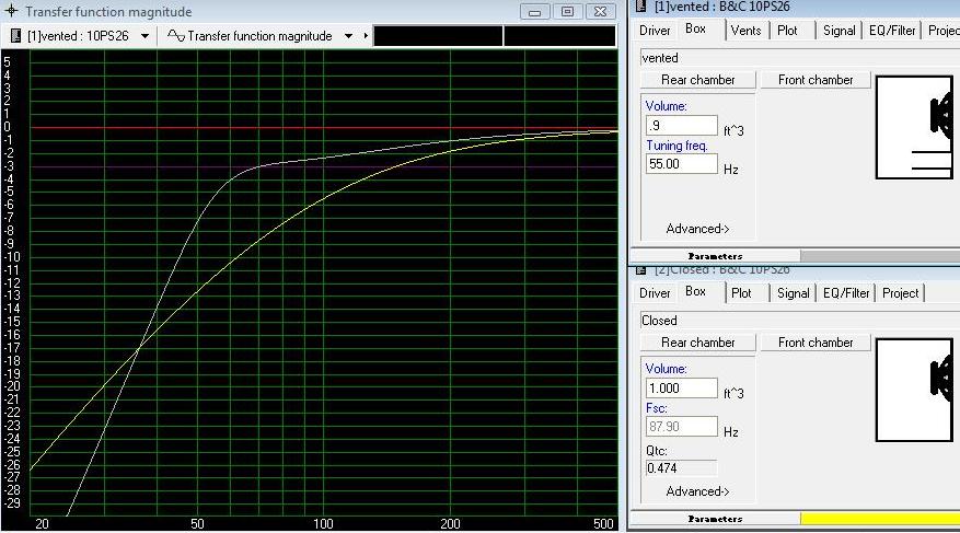

I guess if you don't use subs that would be a significant improvement. I didn't really know since I have never done it. I don't suppose you subtracted the volume of the port from the box volume. There is certainly no reason why ports couldn't be added to the enclosure. I might try this for those who don't want to opt for subs.
300Z said:
Yes.
