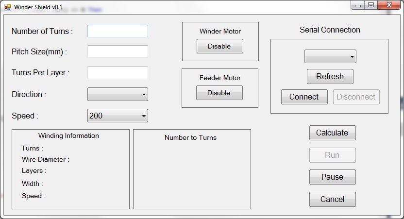

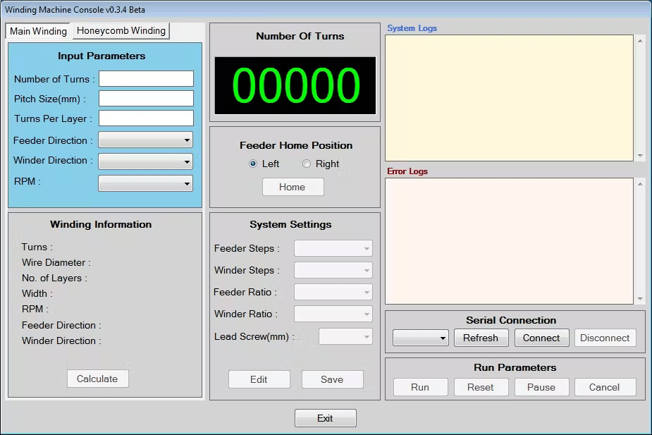

- Winding Machine GUI v0.3.4 Beta.zip - Visual Basic Source Code(Required Microsoft Visual Studio)
- Winding Machine GUI v0.3.4 Beta.exe - Winding Machine GUI exe file

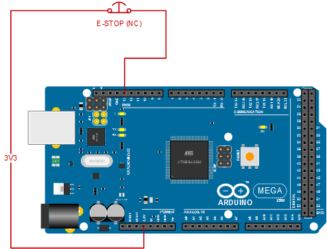

- Winder_Shield_v0.3.1.8.zip - Arduino Firmware

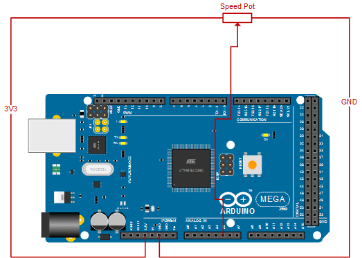

- Wiring Diagram(Due) v0.3.zip - Arduino Due Wiring Diagram in Microsoft Visio

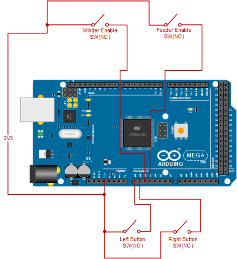

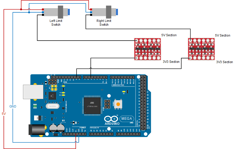

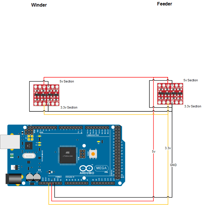

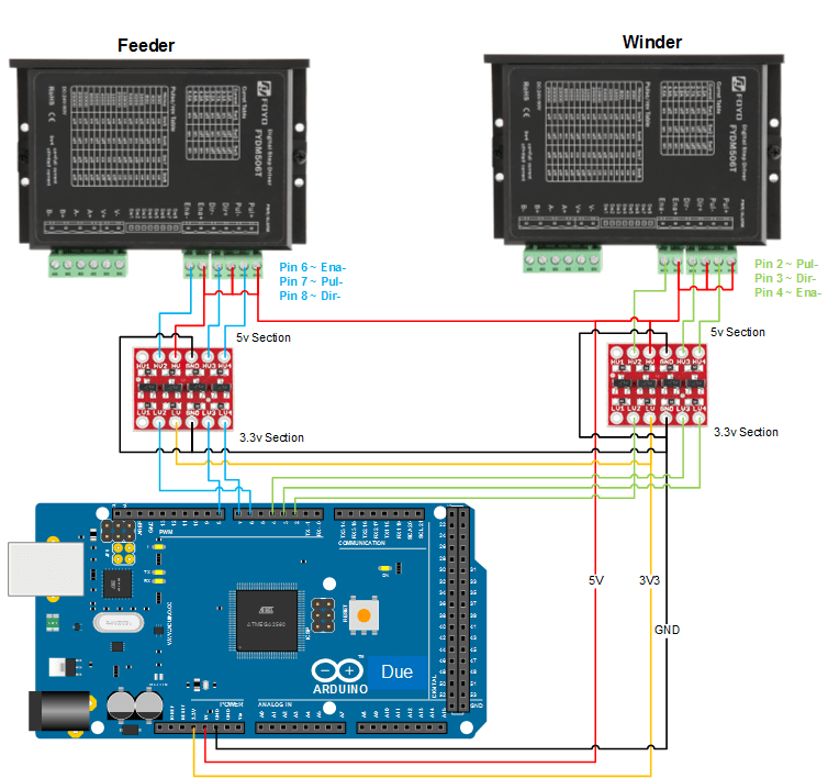

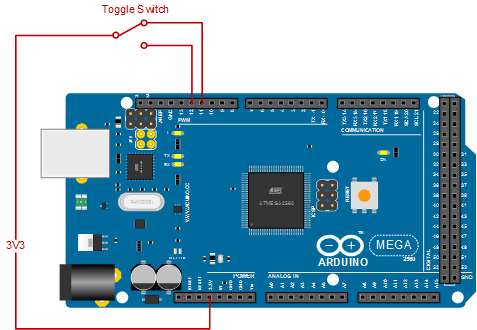

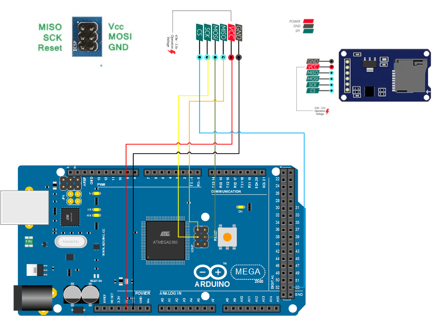

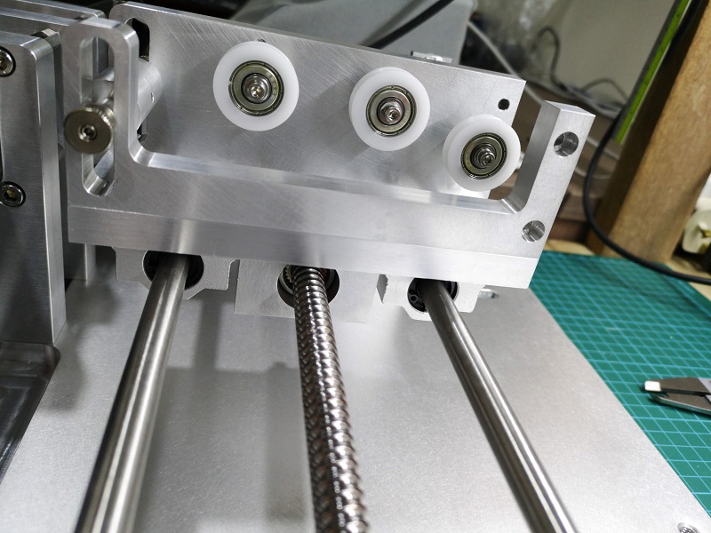

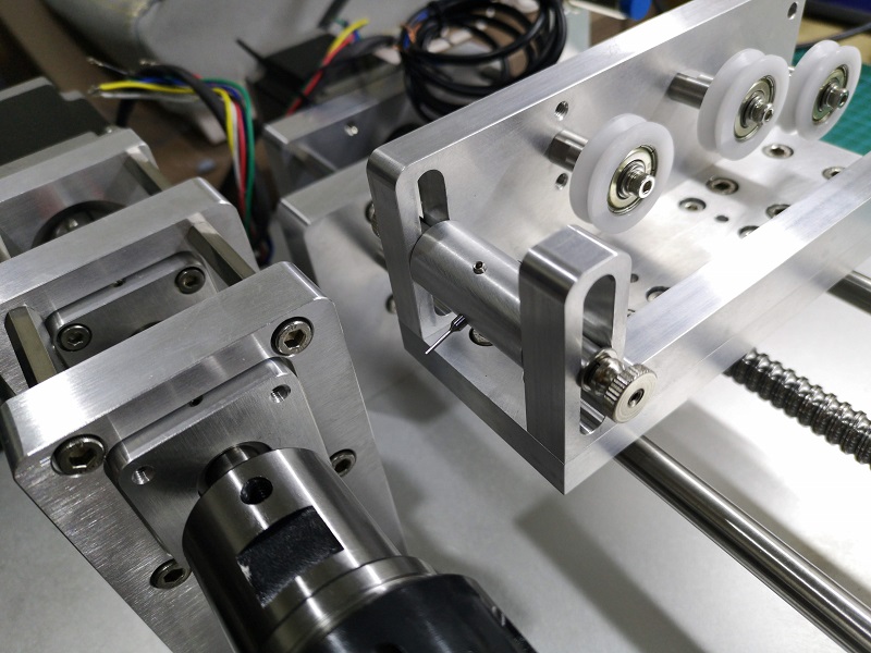

Yeah, will keep that in mind making the wire guide adjustable. And as for the wire tension, I planning to use this as a solution:
MTB-03 Wire Coiling Binding Machine Torque Controller Mechanical Tension | eBay

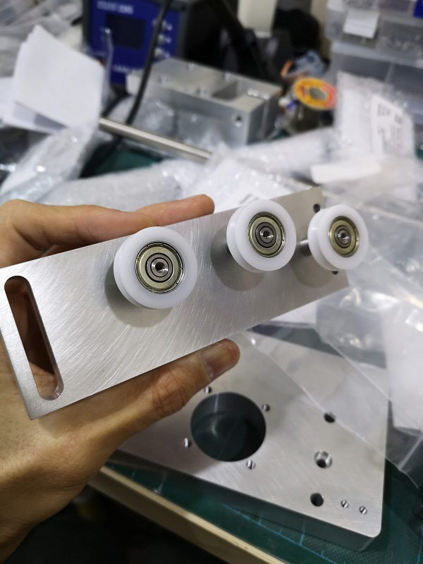

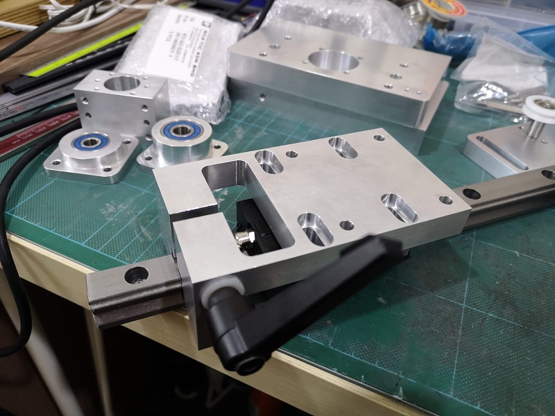

I did bought some 10mm and 22mm V-Grove pulley for the feeder
Some ideas I been exploring to make the wire guide modular, like interchangeable for thicker wire gauge
Thin wire 0.05 to 0.5
1mm and above(Mainly for winding electromagnet)

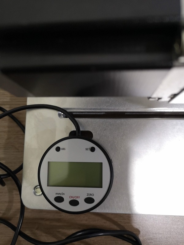

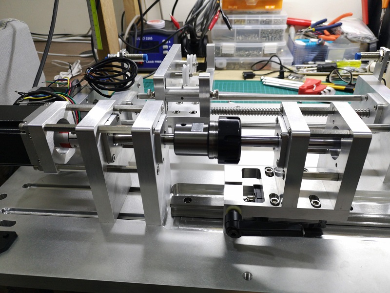

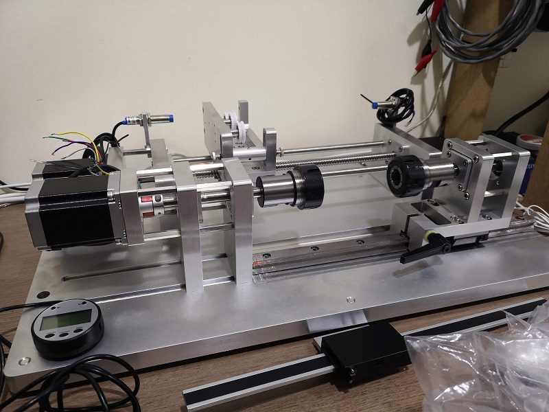

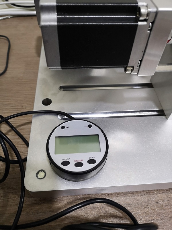

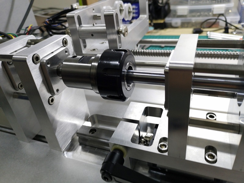

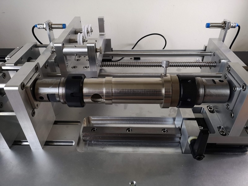

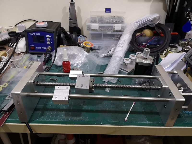

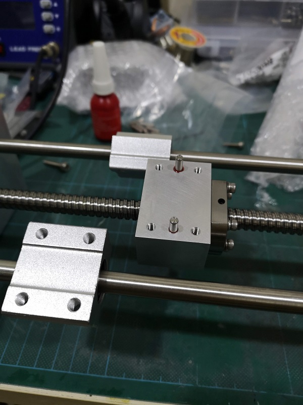

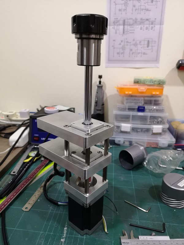

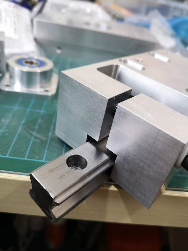

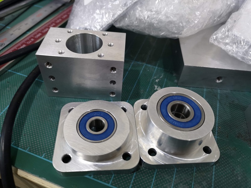

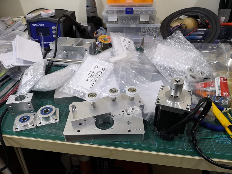

Some updates on the winding machine clone built.
Still have quite a few stuff still pending fabrication. But the mind winder is completed, but need to cut down the linear shaft to a proper length.

Off shelf winding machine doesn't suits my need which I need easy changing from voice coil winding to field coil winding.
It is more fun to design and build your own, give me more flexibility in capability expansion for future.

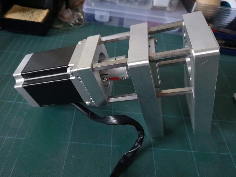

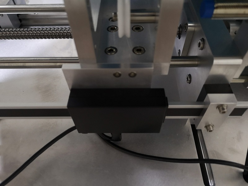

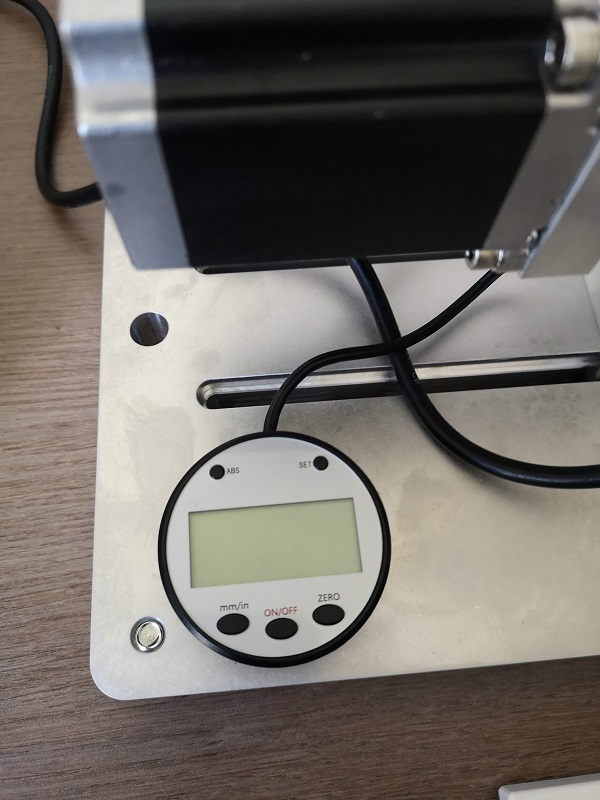

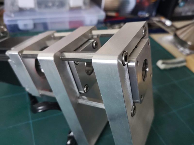

Some updates to the winding machine that I building

Anyone interested in the coding for both Visual Basic and Arduino? Though it still need polishing.
Uploaded the source code to my share drive. Coding still need bit of polishing
I will do u the schematics later, but if u can understand arduino. The pin assignments are on the code
CNC Winding Machine Shield - Google Drive

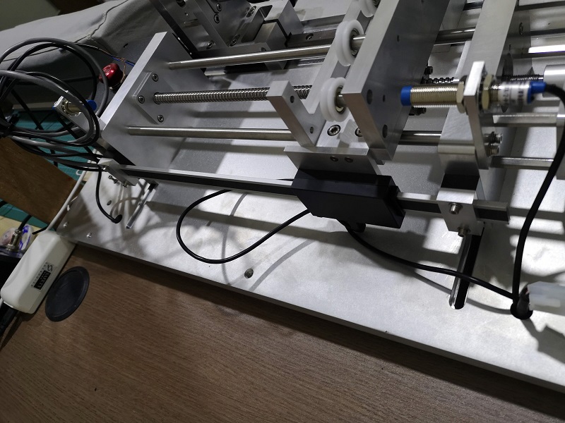

Parts:
-Arduino Mega
-NC proximity limit switch
-Nema 23 1.8 degree stepper motor
-TMC2208 or DRV8825 set at 2x microstepping
- Ball screw pitch 4mm travel per round

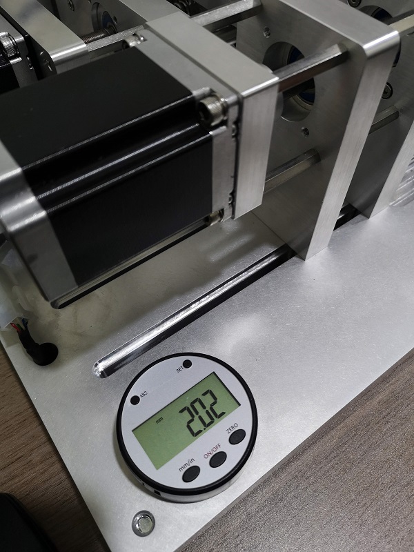

Some of the outstanding issues to resolve:
- Need a better stepper motor driver that can achieve 600rpm
- Need to calibrate and calculate the acceleration for more accurate Winder and Feeder speed synchronization.
- Noise related during stepping of the motor which needed to be tone down(Driver related?)
- Stepper torque to allow larger gauge wires
- Increasing Arduino PWM frequency to test on maximum rpm reachable.

I thinking of getting a closed loop servo or stepper motor, to make sure speed synchronization.
