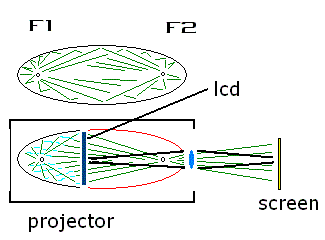

reflector. the magic piece.
ellipsoidals are perfect. does everything we want:
i've paint sketched how an ellipsoidal reflector works. see attachment at bottom of post. top image shows how light at one focal point all bounces to the other focal point. now just imagine that the part that's red on the bottom photo gets cut away, drop a 250w metal halide at F1 and install the LCD.
i drew how the optics have to work too. in the bottom image, the light bounces off the reflector, goes through the lcd and collects at the lense. the lense needs to let the light fill the four corners of the screen, while focusing the surface of the lcd onto the surface of screen. exactly like moving the knob on your overhead to set focus. in effect, the ellipsoidal is just like a fresnel, except much higher quality on a number of different levels (better light uniformity/dispertion, sharper, no trougth lines).
grab a good lense design book available at your public library if you want to really do the optics properly. its well worth the effort spent. it makes all the different between "an image" (sometimes "barely an image") and a mighty fine image.
zoom optics are definately a fun route too, but a huge pain in the ***.
by the way, stuff is hot. so yeah, be careful. sheet of glass alone works wonders at blocking heat. if you wanted to be just that cool and use a 400w mh or 1000w mh for the image of perfection, make the reflector a cold mirror then put a hot mirror directly between the LCD and the light source. that should keep the important stuff (see: lcd) cool in the uber-setups, while letting the heat bleed off. some fannage should be sufficient in most reasonable cases though.
