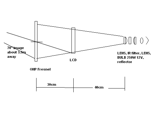

Congrats on getting something going - it is a huge thrill.
I am also using a ohp fresnel as the projection lens. I have a delta77 4" proj tv lens that I bought, but when I try to use that a only see a round sub section of the picture because the lens is smaller than the 5" of the LCD. The fresnel works great, no keystoning or anything except for the picture being a bit out of focus on the edges. This is because the acrylic fresnel is actually a bit warped. I was thinking of clamping it against a sheet of glass to hold it flat, or an aluminium frame to flatten it out.
I do want to use the delta77 lens because it really looks like a top quality piece of optics, but I think I will have to change my optics around to do it. If I use multiple fresnels on the source side of the lcd, I can converge the light before it hits the lcd, and use the smaller projection lens. (if my optics thinking is right, which it may not be...)
anyway attached is a really quick piccy I just did of my current setup.
