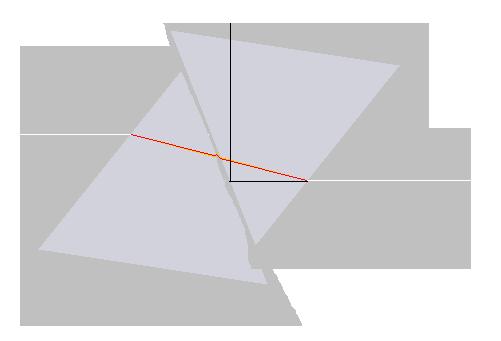

what do you think about this?
the first prism has a rainbow effect on the white light, the second reveals this effect, so one white light ray comes out. the black second light hits the second prism at a negative angle so this should be reflected and goes into the first light ray...
so i have one out of two beams...
based on this site and paint shop 😀

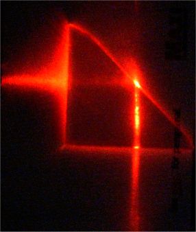

Laser a good help
Here is a little tip to all diy:ers, a laser is a good instrument to measure lenses and control your setup with. It´s really intresting to see what happen when it goes through a fresnellens.....more than you think.
It´s friday night, so I show a cosy picture of a laserbeam through a prism.
