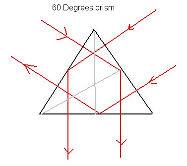

Heya mathias, the 60deg prisim will invert the beam 10deg towards the center of the prisim to converge the light beam into 1, (you would think they would call it a 40deg prisim but its 60deg from the outer plane).

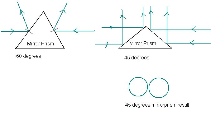

Trev, I'm sorry I still don´t understand it: What I can see, the only thing the 60 degrees prism is doing is changing place on the two beams they never get mixed. And if you change the angle on the lampbeam there will be rainbows.

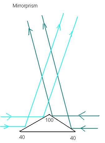

Actually i asked both, mathais, that picture is wrong ill draw u one up, u dont get rainbows with white light nor with the right optics. The picture u have drwn up is 1 way of doing it though, but with a dichoric prisim with a beam splitter.

Trev, what you have drawn is a mirrorprism, there is no way a glassprism can work in that way you have drawn. With a 60 degrees mirror prism the two beams will spread from each other. And the 45 degrees mirrorprism is not working either.
My conclusion is, there is no way to mix two beam with normalmirrors or prism. The only way to do it is with semipermeable material.
mathias, the angle u have thought is wrong, its measured from a outer plane as stated earlier and its why i said i dont know why its a 60deg prisim when it should be a 40, the angles on yours are the wrong way round, BTW i like everyones drawings lol (makes mine look better lol)

The angle u have thought is wrong, its measured from a outer plane as stated earlier and its why i said i dont know why its a 60deg prisim when it should be a 40
Okej, I think I understand what you mean, but with this the beams only cross each other, so the problem still remain.
Ya and thats where u use a lens to corect this, u dont have to use a 60deg prisim, u could use a 46deg prisim, it all depends on how wide and where u want your light to go, but to get a strait beam u would have to use a corecting lens to convert the light so its paralelle, probally 2 condensers could do this, i havnt fooled around in this that much with any condensers so its realy only a guess at this stage, it should work though, it would have to be a double condenser setup i would think. But with this idea we can also use a frensel at the point of where the light converges, this will give us a point source, also u could use this with a normal condenser setup.

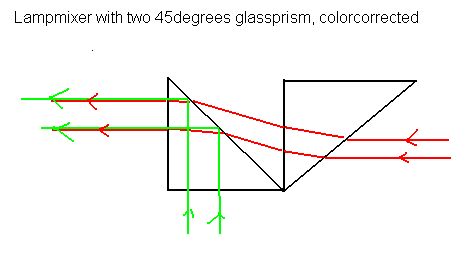

After some thinking and calculation, I think I have a new idea of a lamp mixer with two 45 degrees glassprisms they are cheap and easy to find. The last prism is for colorcorrection of the first prism, otherwise there would be rainbows from one lamp.

I´dont know what you mean, you can always move the prism so the beams overlap each other and you can turn the last prism around. Why 3 prisms then I it´s work with 2 ?
Sorry mathias i miss read your last post, but one thing that has got me curious is how can that work with one prisim having that degree of refraction while the other hasnt? wouldnt both sources of light have the same refraction difference on the 2 colour corrected prisims? they wont match up, and if only the prisim to the left is colour corrected, the prisim on the right has a big difference of refraction, its working as if its a lens.
Why 2 prisims when its the work of one? lol use a correcting lens after the prisim.
The first prism (that with the green rays) give refration in one direction on the red rays, to correct this the last prism is turned in the other direction, so the refration take out each other. The green beam has no refration because totalreflection.
But one very strange thing with this design is that it doesn´t work in the other direction (backwards) ? So if there are anyone good at optic is this magic or what ?
