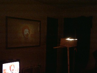

I just found that lcd while seaching on yahoo, i thought you guys might interested. I don't need it, I'm using the sony psone lcd screen for my projector, i want mine small, here's a picture of it. I'm using the Figinon lense from surplusshed. I had to build a stand for it, so it could be close to screen.
