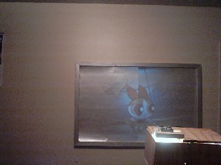

I have the same problem with my projector as you can see in the picture my projector is close to the screen, it;s about 4 feet away, but it still shows really good. It has alot of glare but the light was on I'm going to put a light tint on a piece of plexiglass and put it over the screen to reduce glare.
That formula thats on page 104 on this board was first posted by me awhile ago, I got it from the 3M website.
And Don't Laugh At Me For Watching Power Puff Girls😡

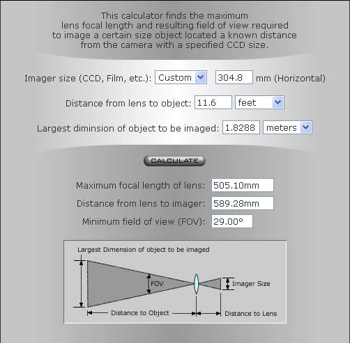

so what lens will i need to purchase in addition to my 327mm objective so that my max focal length would be about 521mm?
thanks slize
327 mm = 0.327 m = 3.06 dp
521 mm = 0.521 m = 1.92 dp
1.92 dp - 3.06 dp = - 1.14 dp
that means you need to go to the optician and buy an eyeglass with -1.125 dp for farsightedly people (because they only have 1/8 steps in the US)
or you try to find a convex - conkav lense with - 876 mm of focal lenght...
hope that helps...

slize said:
i think a found a lens for you..
http://www.surplusshed.com/pages/item/l3043.html
508 mm focal length
don't know if i got everything right, but it sounds good to my, and for 15 dollars you cant do anything wrong...
Slize, you are my savior...
I am about to order the lens as soon as i finish typing this post.
this lens will be perfect for me....
thanks man
