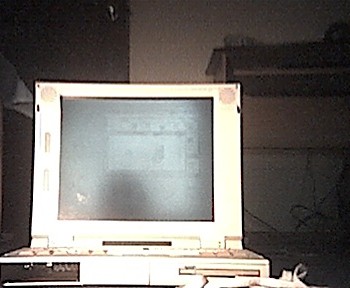

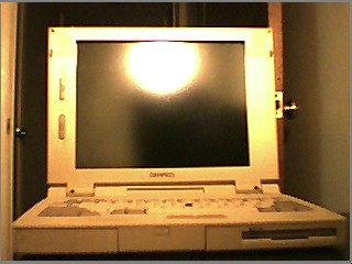

I got this laptop of ebay for $40, it's a Compaq LTE 5000 11.3'' tft screen 800x600. It just happens that the 5000 Series have a special adapter that lets you watch full screen video and enables Mpeg 2 playback, so I bought that too.

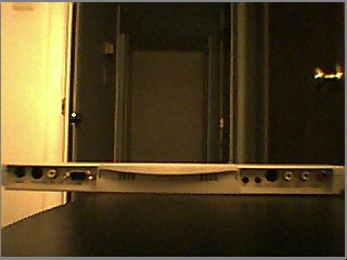

I dont know how to put two or more pictures on a single post, heres the adapter it has video in/out, s video in/out, audio in/out, vga out and a place to put your keyboard and mouse. It connects to the docking ports of the computer.

Negative Design:The Cpu speed is 75mhz, it's really old, the book that came with adapter said it can produce full screen video at a good speed. I have no idea what the constrast ratio, or how many colors it can produce, I have a Toshiba laptop that has the same screen it can produce 640x480x16.4million and contrast ratio of 100:1 so I guess they can be the same but I don't know.
Property: The Compaq LTE laptop are the only ones I know of that have this kind of adapter, but there are two pcmcia card capture devices, Irez capture card and the Margi Tv to go pcmcia card

I got all the pieces to laptop, I installrd all the software and hookup the the adapter, I started the program that lets you watch tv on it and the screen went crazy, the program didn't even start, I've tried changing the resolution, reinstalling all the programs and the damn thing just won't work. If anyone is good with computers could you please help me.
The laptop is a Compaq LTE 5000 75Mhz, 16Mb ram, 1.3Gb hd, 11.3 tft screen, floppy drive, battery, Mpeg and Tv adapter and Windows 3.11 installed, all other program work fine. I'll sell for $75 bucks or who ever has the best price if anyone wants it, even if you can't get the program working it can make a great second or backup computer.
