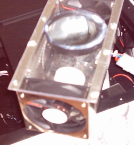

ok another one of my bright ideas here, ive been playing with my light in my diy projector and i have come to a couple of conclutions and mod's. Im just using my test light until i get a mini mh bulb that puts out 14000lm's and the test light as it stands now uses a 150w halogena lamp that puts out 2550lm's, there are 2 type's one is clear type and the other is frosted. First thing never use frosted as it will give u a fuzzy image as manny of u know with the loa's and secondly u can get high performance gain out of the clear type but run slightly warmer.In the pic u will see my test light, the brightness of the projected image im getting is about just a bit lower than a standard tv, now when i place a small magnifying glass infront of the light's burning arc wow u have just intensifed the light like 2 double the brightness, now my projected image is brighter than a standard tv about double of what it was before the mod. I know manny of u are using condenser lenses and they do basically the same thing, they control the beam and intensify the light, but if u use a small magnifying glass u are magnifying the light and controling the beam, in the pic it shows what i did and how i did it, just imagine putting a small mag glass infront of a condenser lens, any thoughts? i bet u would get a masive gain, i dont have a condenser as of yet but as soon as i get one ill try it for u guys.

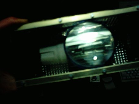

this is the second pic, sorry for the quality of the pics as its hard to take picks with a flash and not with a flash as the light is too dark with out flash and too bright with it. the white u see is from abit of some super glue ill get that off later, as i said just a test light the new one will be the same but cleaned up spotless, also i am using a half circle reflector, the best to use for this is a parabolic that i plan to get in the near future then all ill need is my mini mh! yeah lol

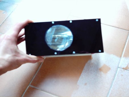

ok the final pic i painted the perspex cover flat black except where the lens is so only the light can come from the lens, i painted the inside of the cover black so that any light reflected from the lcd shines and relects back off of the perspex back into the lcd that way reusing the un used light, another thing im going to do is paint the inside of the light unit flat black and just have the parobolic reflector silver to stop stray rays from giving me light leaks out of the fan holes in the ends of the unit, it may not stop all but it will cut it down and uv to components and beleive it or not ir rays, black absorbs ir! thats why it gets hot!
I recomend trying experiments for yourself science is not always right and u can never see the diff unless u do it practical, so give this a go and lets see what u come up with

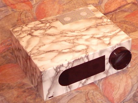

well this is my finnished projector, what does every one think? sorry for not posting projected resalts as i havnt had the time but it would have to put out 300lm's as i can still watch it with a 100w bulb in the room going although washed out wich is normal but i can still see the pic no worries.

How much did you shell out for it altogether? I'm thinking you could get more than $150....maybe....it sure is pretty, but i think you have a low res lcd in it right?

i forked out about 260 i recon i coukld sell it for 500 and i got told by another 1000 so if i put it on ebay we will see lol u know how auctions go the price jumps up with biders
