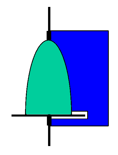

Orthogonal Parabolic Reflector
For anyone like me who wants to find out more about orthogonal parabolic reflectors, have a look at US patent #5,765,934.
(http://patft.uspto.gov/netahtml/search-bool.html)
They even have the curve formula in the description.
I had a thought about creating our own reflectors. If you've ever seen fiberglass tubs or the like being made, they start with a mold which gets the finish coat applied first, then the supporting layers laid and spayed on. Once it sets, it gets pulled off the mold, and the nice smooth finished surface is revealed.
Years ago, I experimented with a cone I'd made based on a parabolic curve to reflect sound from a driver facing upwards out 360 degrees. I made it from plaster using a forming tool I'd made from masonite, sheet metal and tubing. This technique was pretty easy and produced a very smooth and fairly accurate surface.
What my thought was, is if we were to create a mold using a similar tool like the diagram I've attached, then layer strips of foil on it, building the layers up using some sort of heat resistant adhesive, then we could produce virtually any shape reflector for which we could plot a curve. If the adhesive would handle the high heat of what we'd stuff into it afterward, we could just keep laying on more and more foil until reaching the thickness and strength desired.
Epoxy might fare OK being that the foil would form a primary heat shield. Any ideas?

I think the stuff we have been talking about recently differs from the LOA setup in two ways:
1) The LCD is quite directional, and has poor efficiency for light rays VERY off-axis (by that I mean light rays that diverge considerably from being perpendicular to the LCD). Many LCDS seem to have a noticeable fall-off in intensity once the angle of the light is > 20 degrees from perpendicular. Thus the LOA light sources would be very inefficient due to their absolutely diffuse output.
2) Like the LCD, the fresnel is quite limited in its viewing angle: one of the compromises in the construction of a fresnel that allows it to have an f-stop < 1 is that it is only designed to receive light at a given angle, and transmit that light at another given angle (within a few degrees either way). Most are designed to receive parallel(ish) light and focus it to a point. (See the fresnel-tech website for more info). When they describe a high quality fresnel, they generally specify the position of its "conjugates". These are the points where if a light source is placed at one point, its image can be effectively viewed at the other without distortion or scattering. Thus, most fresnels are designed to have the incident conjugate point at infinity, and the image conjugate point at the lens's focal point. If a viewer is placed at this conjugate point, then the fresnel will operate without significant distortion. The further away the viewer is from this conjugate position, the more distortion that is introduced by the fresnel. The same can be said for the position of the light source - the more its rays diverge from parallel, the more distortion is observed (placing an LCD emitting parallel rays close to the fresnel is in interesting philosophical point...). This is why the fresnel's can be quite directional - using it one way around gives virtually no distortion, and using it the other way ruins the image. This is also the prime reason that most OHPs use two fresnels facing each other...
Where I am trying to get to here, is that the way we are using the fresnel, it is optimised to take a roughly parallel beam coming from the LCD and beam it into a light cone with its apex at the main objective. Slight divergences from parallel in the light from the LCD are within the tollerances of the fresnel, but majorly diffuse light sources are going to give poor results with lots of scattering and distortion.
Thus, unlike the idea of throwing a LOA behind an LCD and putting a lens in front, this requires some more precise engineering. A fresnel might help, but the diffuse nature of the LOA is still far from optimal.
The situation is actually slightly more complex than this, because the optical qualities of the objective need to be fairly closely matched to the fresnel.
The fresnel is operating in magnifier mode - meaning that the light source (LCD) is placed closer then its focal point (the rays from the LCD are never 100% parallel, and hence the philosophical point mentioned earlier is resolved - yup, too much coffee!).
In this situation, even though the rougly parallel light is being beamed from the fresnel into a cone shape, the image produced by the fresnel is actually virtual - behind the fresnel, and behind the LCD itself (this is standard magnifier theory, and the reason reading glasses work - this is not just one of my crazy schemes that would have worked if it wasn't for those meddling kids...).
In order for the objective to correctly focus the image, it must be placed not only at the correct point relative to the virtual image of the LCD to focus the image on the screen, but also close to the conjugate point of the fresnel to actually make the most of the light cone, and avoid any distortion... The two points must be very close, or else, brightness, contrast and clarity suffers.
Before everybody screams, "I told you so," though, it must be said that the optics of an OHP are already optimised to work this way: the fact that a normal transparency is placed on top of the fresnel layer, and not sandwiched between its two fresnels is purely a function of convenience: it is very difficult to write on a transparency when it is between two fresnels... 😉
This is why the focal lengths of the various objective lenses for these devices are different to what would be expected if you were using the standard projector focal length calculations for original image position : projected image position...
Overall, my own personal recommendation for these configurations is to use one or more roughly parallel light sources to illuminate the back of the LCD, place a single fresnel close to the emitting surface of the LCD, and beam the light to the objective. This captures more of the light from the LCD, and relies less on the quality of the original light source being a point emitter.
Having said all that, if the LOA devices are able to produce a very high intensity light, equivalent to the MH bulbs, but without the heat, I believe that there is a fairly easy way to convert their diffuse output into a single high quality point source without TOO much loss. I was never able to find a VERY high brightness bulb at Home Depot (there are no WalMarts near me), so I never explored the option fully.
Bill.
